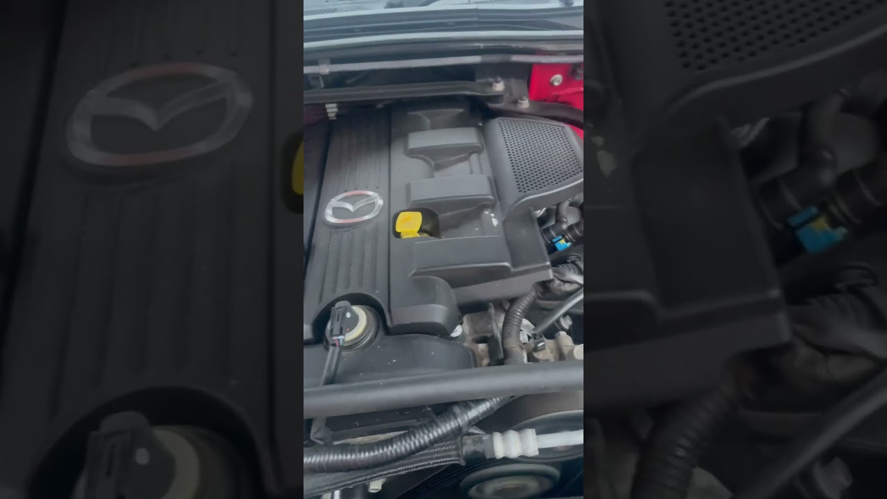

Engine sounds like it’s rattling to me but I’m not sure if it’s something like a knock or if it’s just classic fuel injector noise. Read a lot about the tensioner and idler pulleys starting to fail which can cause a slight ticking noise. Will check that out this weekend but until then can you take a look at the videos?

The first video I hear nothing but a smooth, quiet engine. Wish mine was that quiet! I can hear the rhythmic injector tick (slight fast metallic pingy noises - normal) but nothing else, at least on my phone speaker. My car had all its pulleys failing basically - it would randomly and very loudly rattle and ping away at idle, sometimes only when moving the wheel or revving slightly.

Good to know the engine sounds okay, I got this car coming from a 1.4 polo and as it’s my dream car anything that sounds a bit off instantly gets me worrying. Good to know it’s all sounding normal though.
