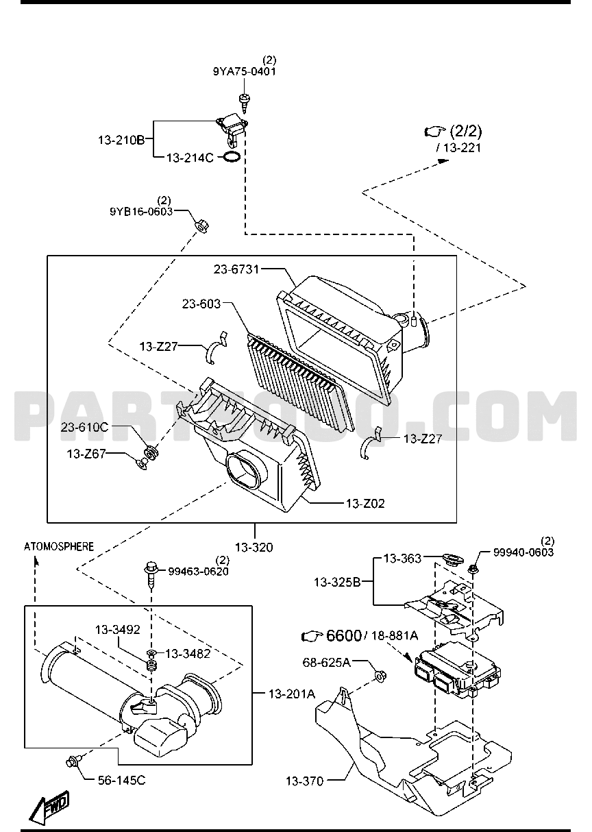

Does anyone have any pictures of an nc with the front bumper off showing where it draws it’s air from on the stock inlet/airbox?

Thanks very much for the info. I did since find the photo of the bumper removed but the parts diagram is very helpful too.
It appears as though the cobalt could indeed do a better job of supplying cold air due to where it’s taking it from, for the price I think I’ll take a punt. If anyone else has any opinions they’d be appreciated.
