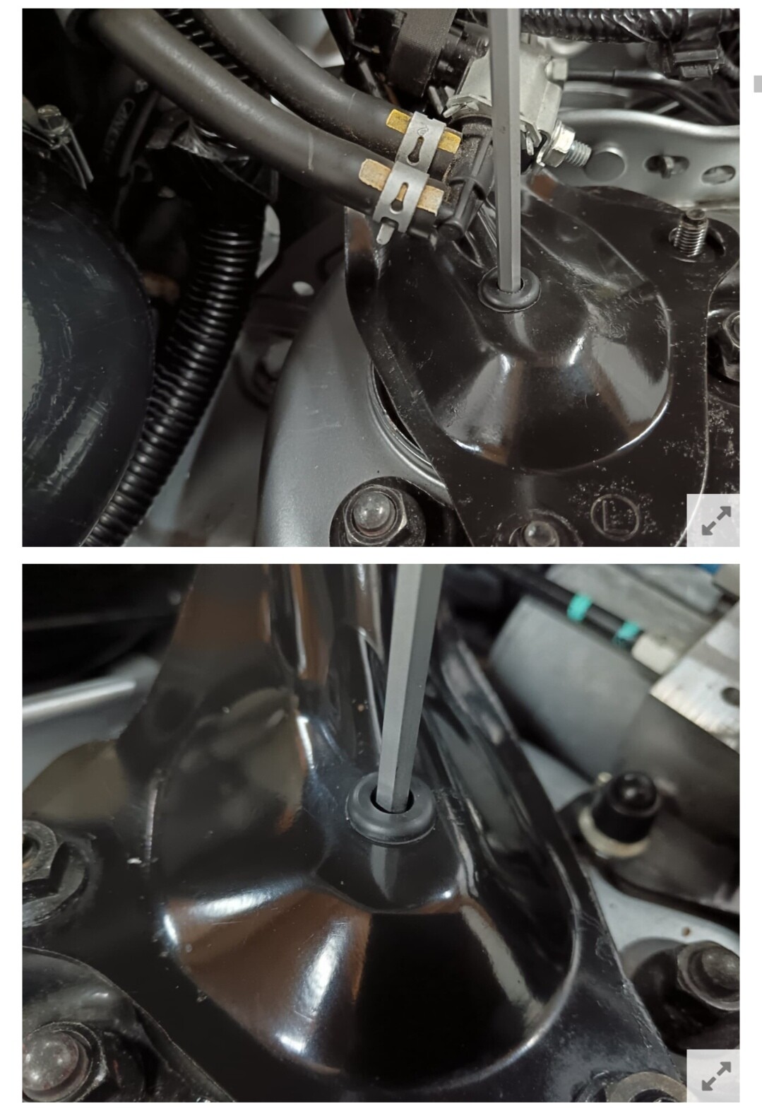

I used a step drill and put a 20mm hole in each strut top cover to put the adjuster tool through.

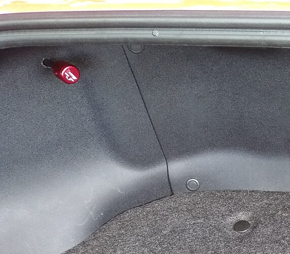

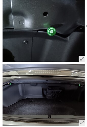

What about the back ones. I thought about a hole in the plastic boot liner and 3d printing some covers. Worth it? (I am a tinkerer)
I did that for my rear MeisterR adjustable extensions, worth doing as it’s only one hole either side in plastic.
I got the extension adaptors so they poke in to the boot area.

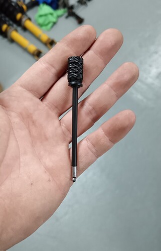

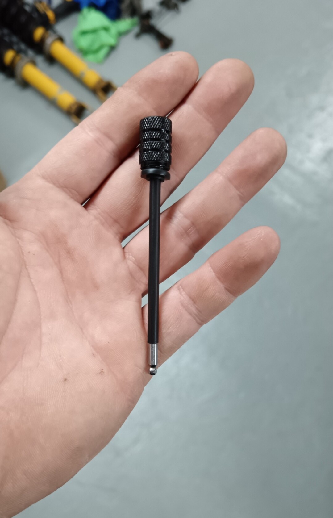

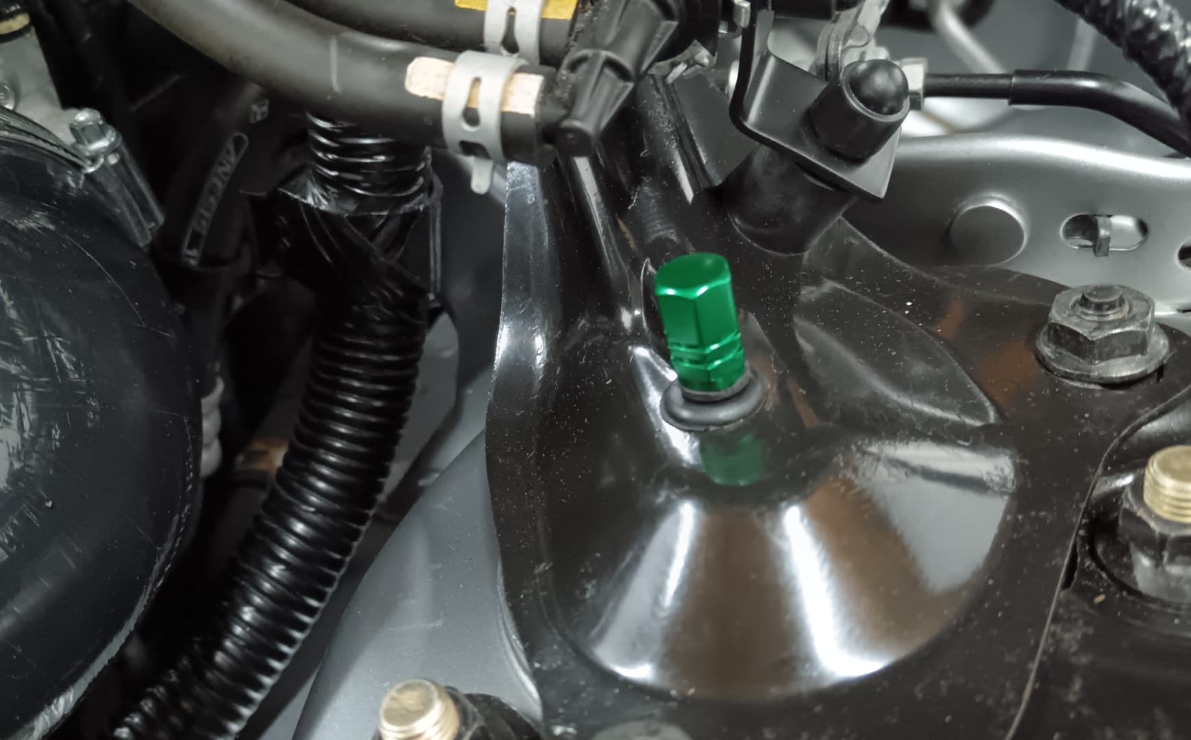

As said simply measuring, marking and drilling the turret tops gives you easy access to the damping adjustment. I then bought a couple of Allen keys off ebay, cut them to length then epoxy bonded tyre valve caps to them and they’ve been perfect for almost 2 years now. The black one was the ’prototype’ one but the green ones were the finished article.

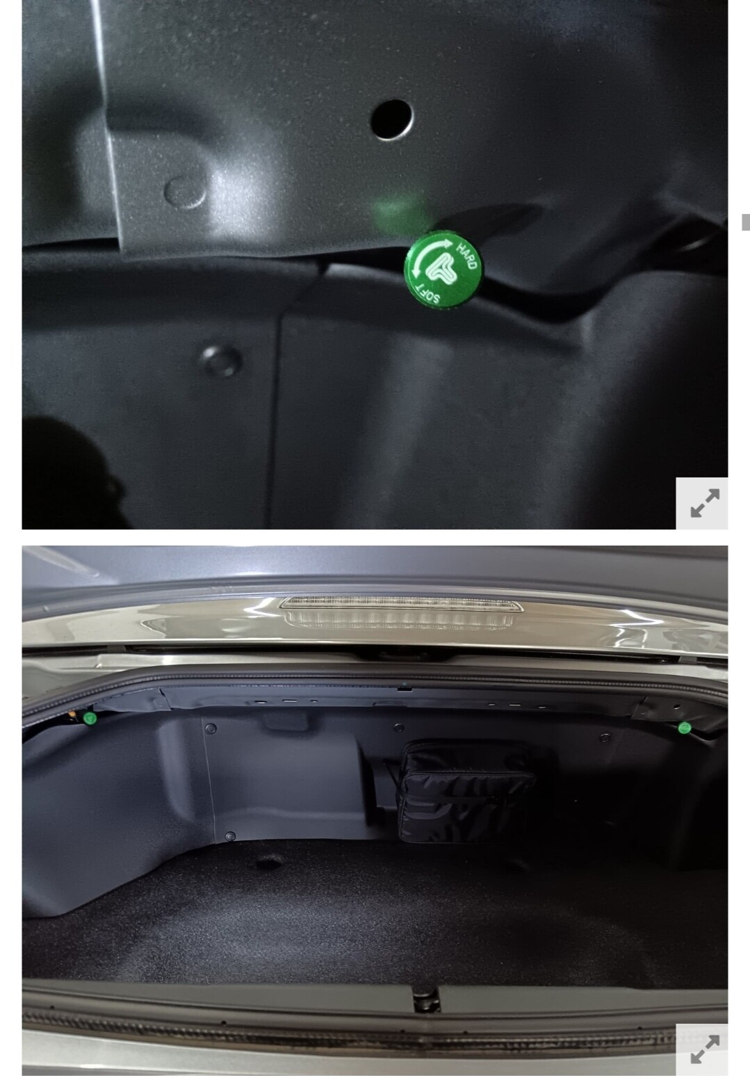

Also I bought my rear Coilover adjusters from here
They are certainly worth it as you don’t have to remove any trims to access them once fitted.
