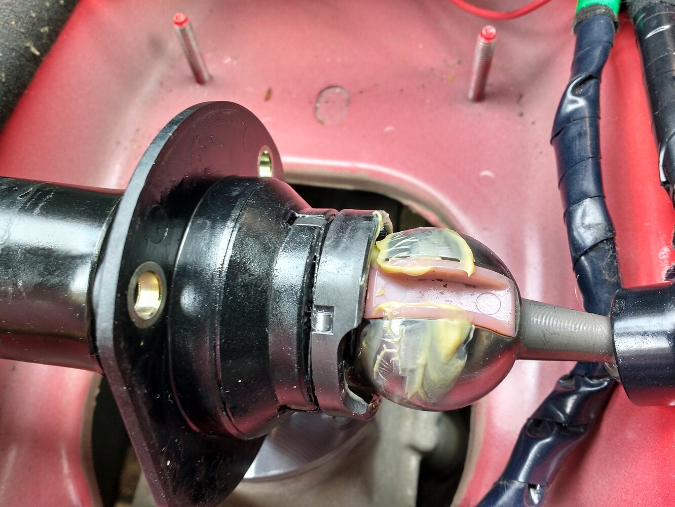

Checked mine today as it was all apart for the new Kenwood fitment.
6 speed sport Tech 3.75 2013.
I was quite optimistic about whether there would or wouldn’t.
There was oil in mine.
Clearly it’s designed to keep the nylon bush etc lubricated and thus ensure smooth crisp gear changes.
Put just “a little” bit more in as it was apart.
Little bit of grease on the ball and back together for another 8 years.
Exactly as Mick’s pictures. :slightly_smiling_face::+1:
