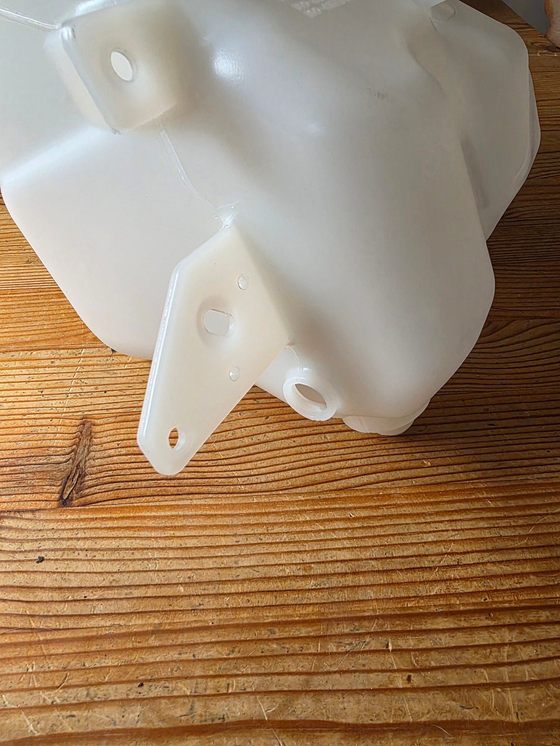

So, back to the titchy washer bottle. It’s really inconvenient when you use your MX-5 as a daily driver and seem to be frequently topping up the washer bottle. Fortunately, MX-5 Parts stocked the larger bottle which came as standard on cars with disccharge headlamps and the headlamp washers.

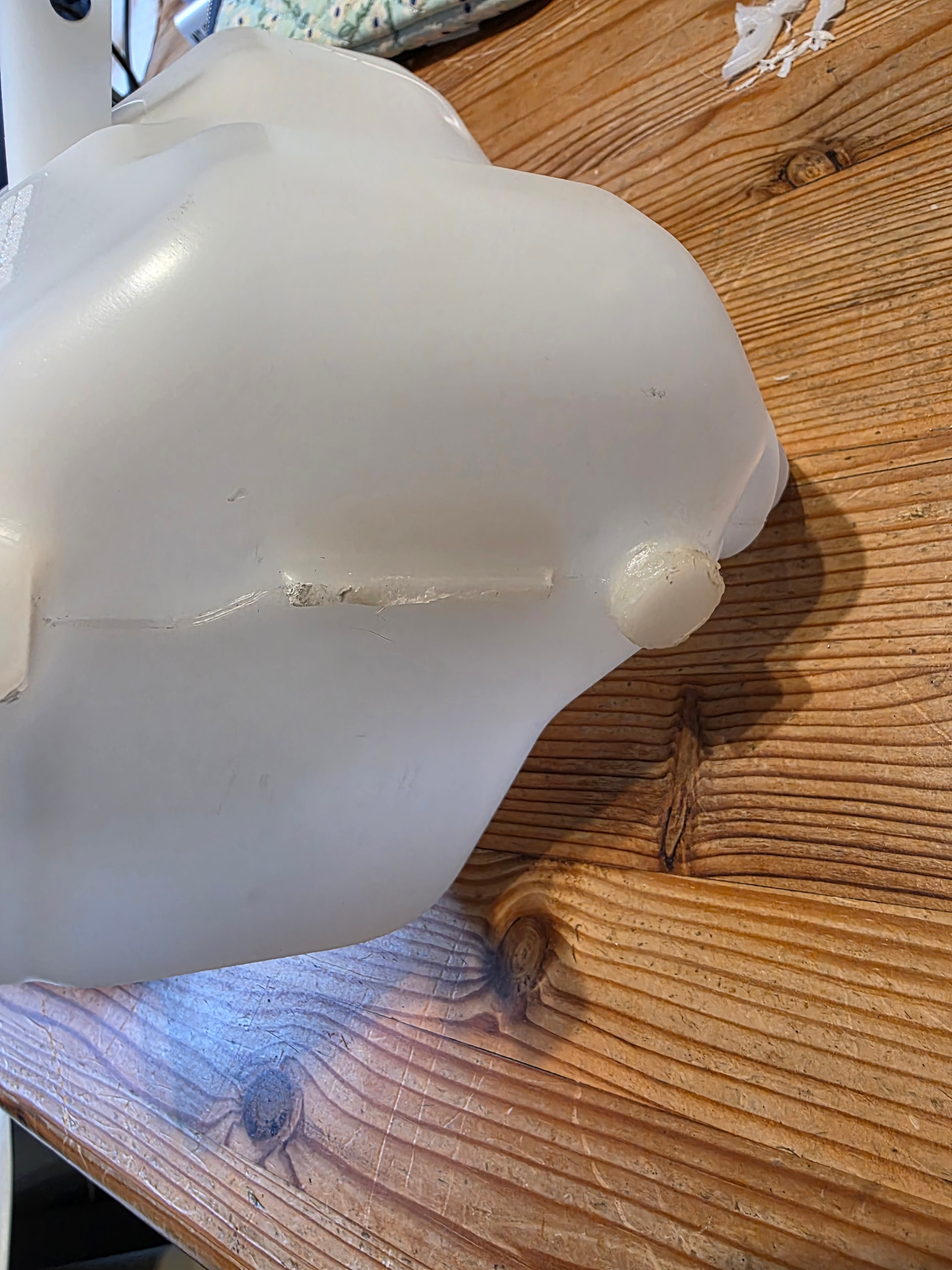

As Robbie said, back in 2009(!), you need to bung up the extra hole which supplied the headlamp washers. I noticed that there is a large unused bracket which can be removed and decided to use this to create a cap for the extra hole.
I just cut it off and trimmed it to get a similar sized plug for the hole. Plastic welding is easy with the polypropylene plastic and it’s not very visible when fitted.

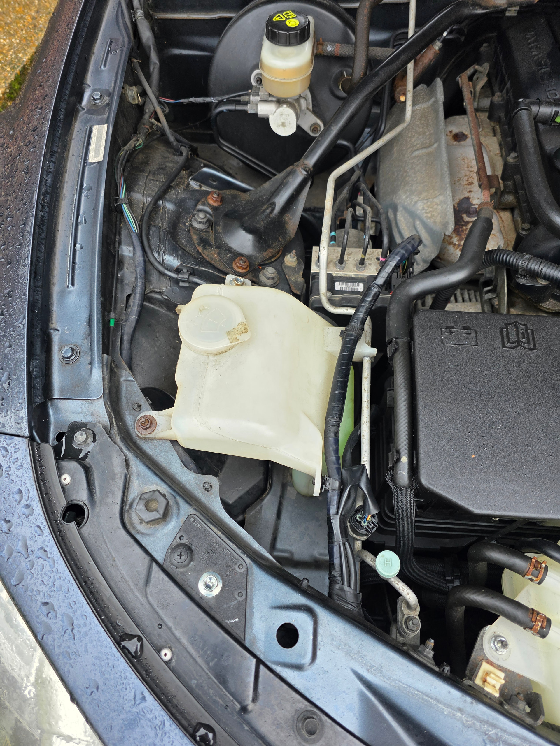

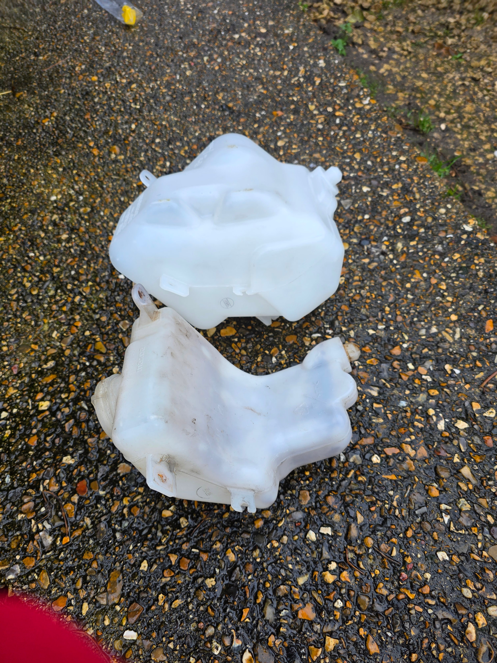

I took off the grubby standard bottle - seen here and compared with the new larger one.

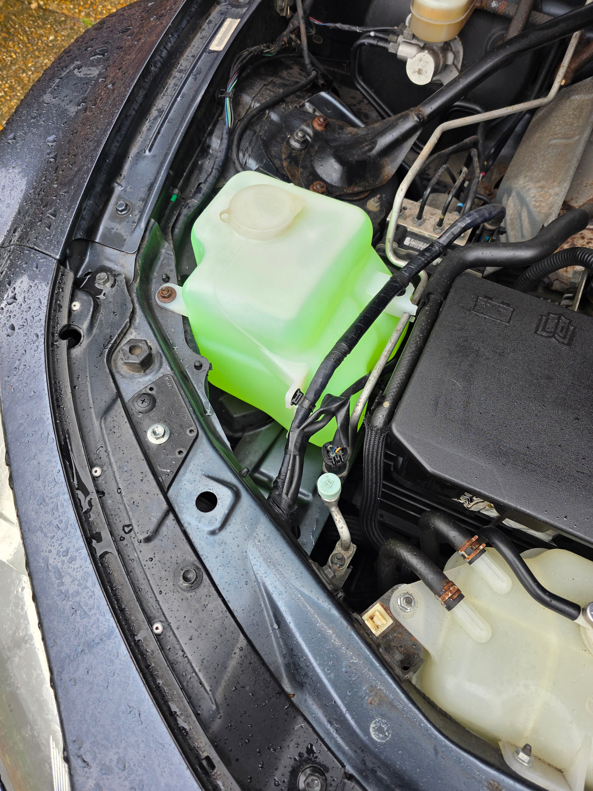

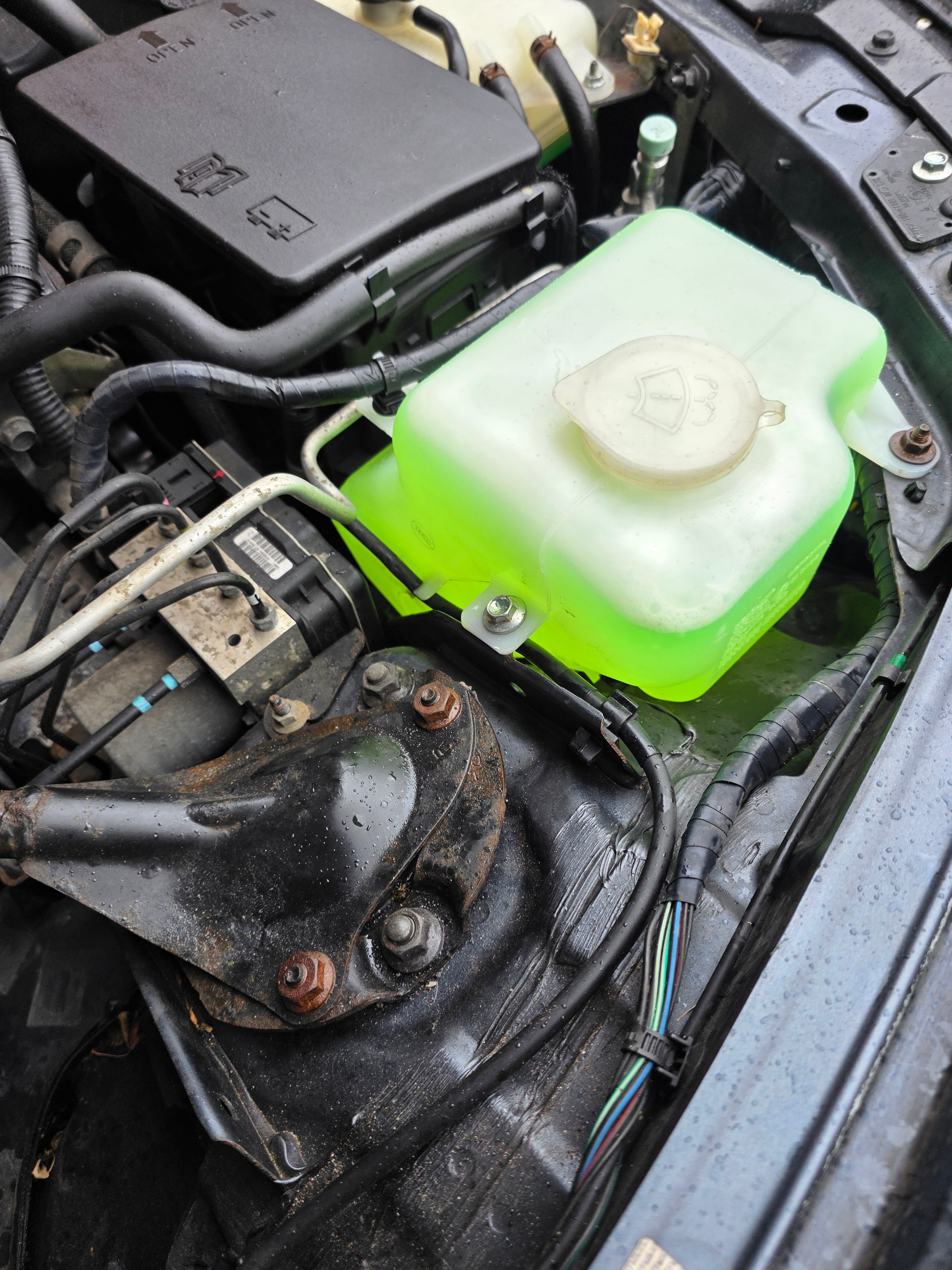

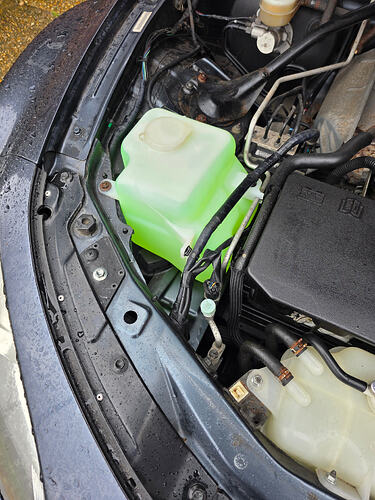

It fitted in nicely and I didn’t get too wet dodging the showers and then filled it up.
Very happy with three times the capacity at 4.5 litres. Everything just fits in nicely.
