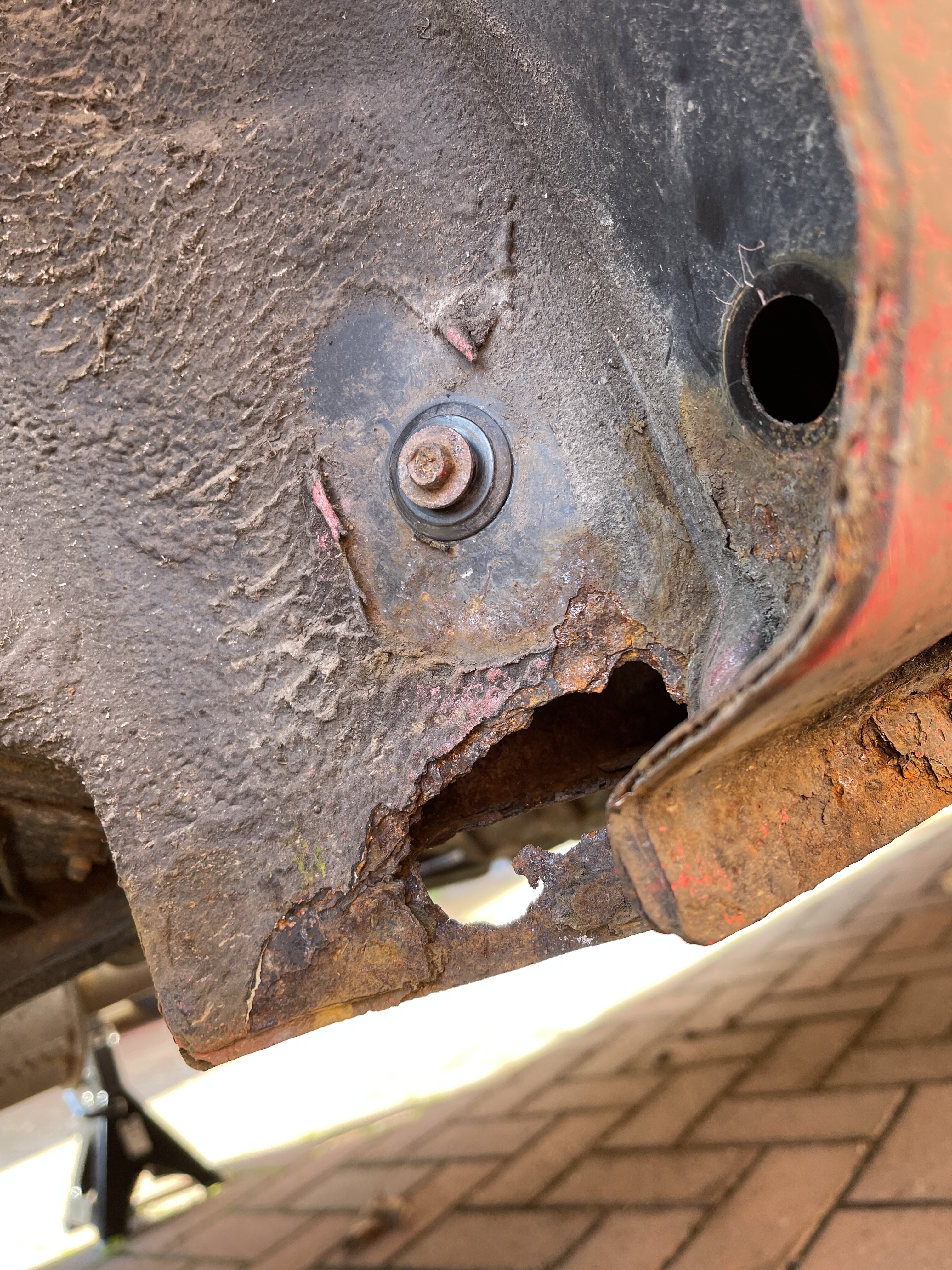

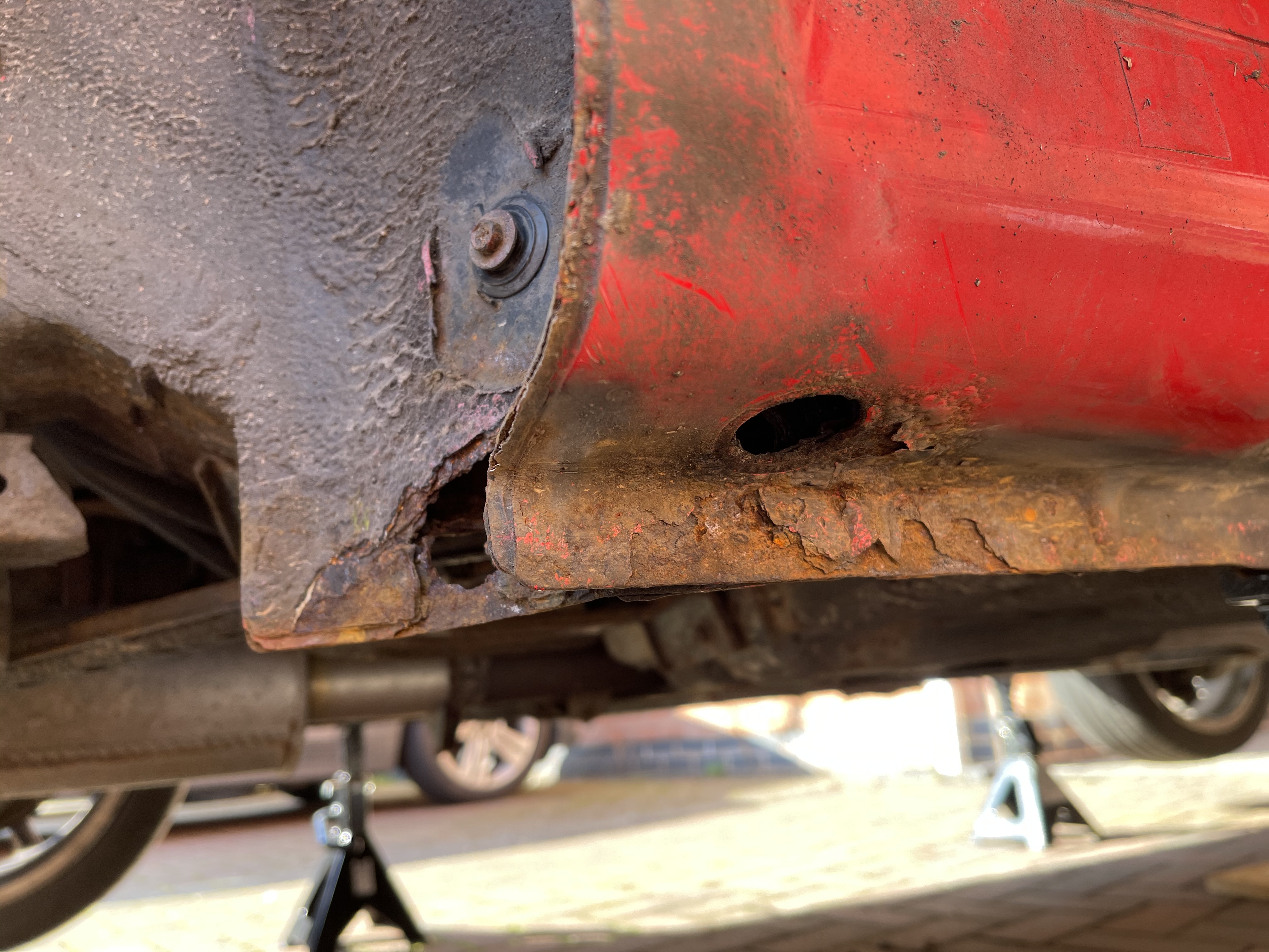

Drivers side rear wheel arch, has gone and needs welding. the sill seems ok it’s literally the back bit that I guess in the inner wheel arch? I’ve seen replacements shaped correctly for this for a mark 1 and a diffferent one for a mk2 . Do any of them fit the nc or does it have to be diy and if so what thickness steel should I be looking at.

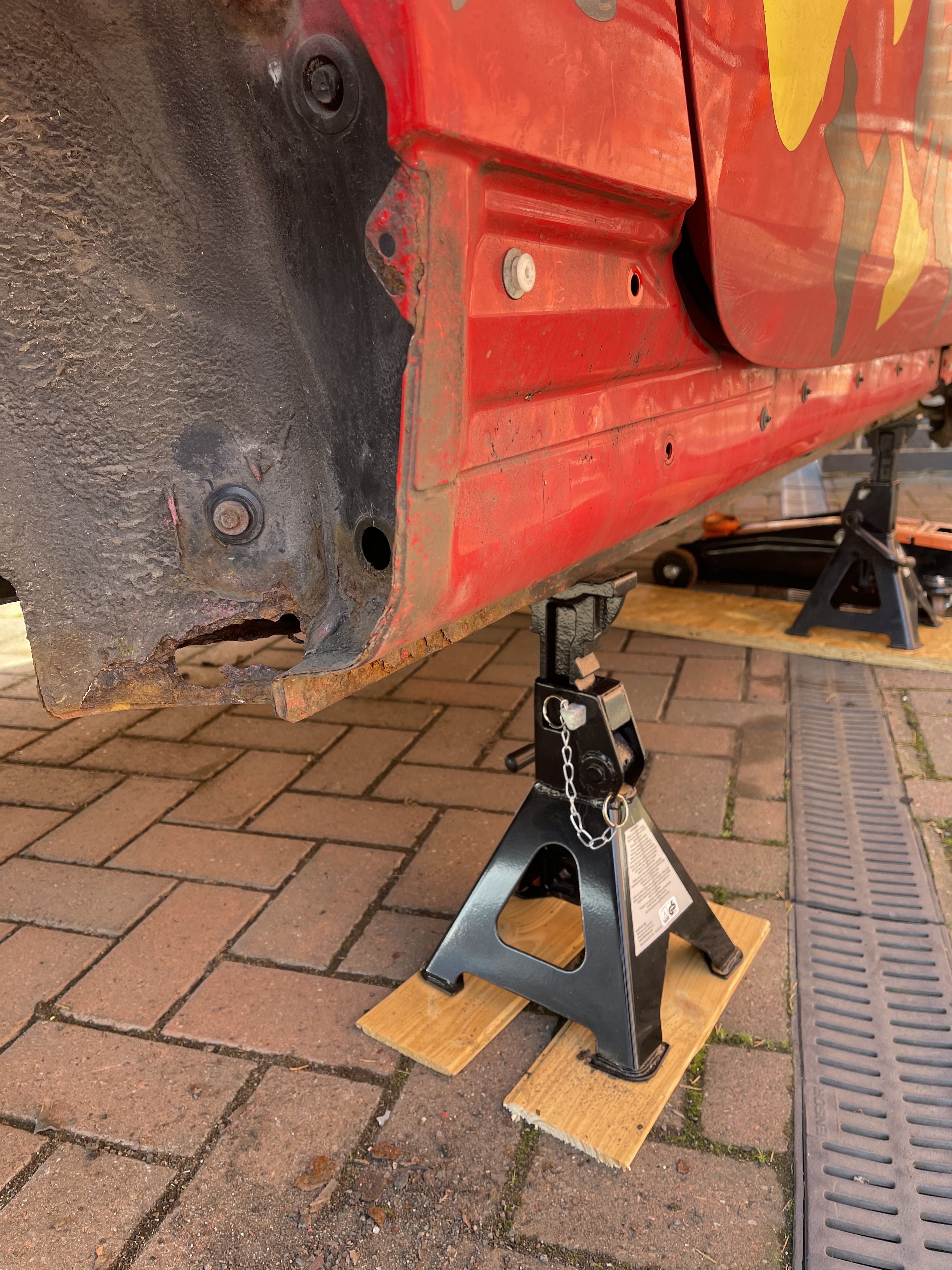

No it’s the inside not the actual outside it’s the front of the rear inner wheel arch behind the lining.
I’ve had a very helpful answer from the wonderful guys at mx5city saying no there isn’t a piece for this but it is not complicated to make out of sheet steel.

I keep meaning to get the wheels off and pull back the lining to check mine at some point. Would be interesting to hear how you get on :sunglasses:
What lies behind the Mazda carpet of doom?
Dare you poke that brown scab with the screwdriver? :grin:
I did not dare… the damn mot tester had a field day :slight_smile:

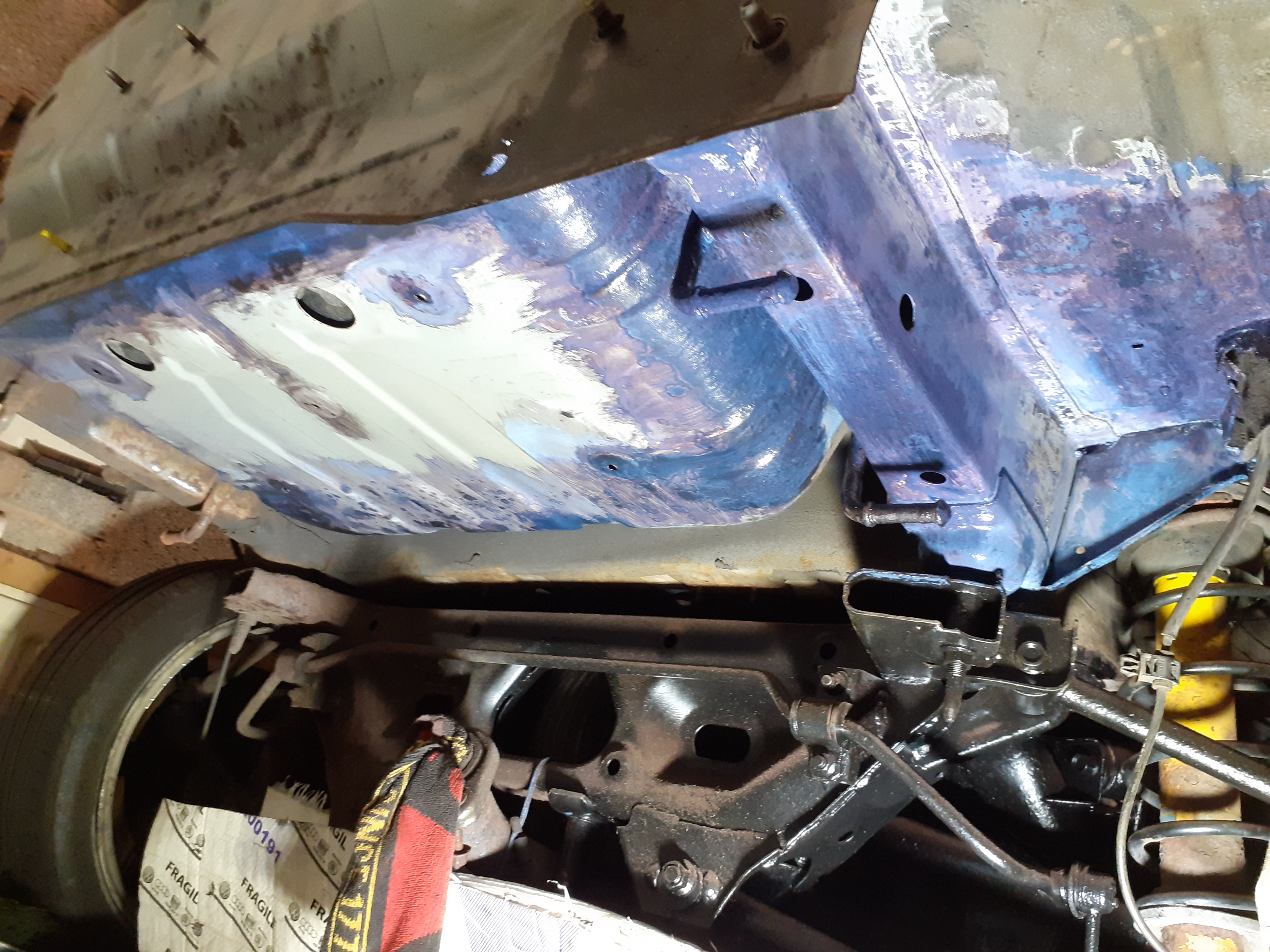

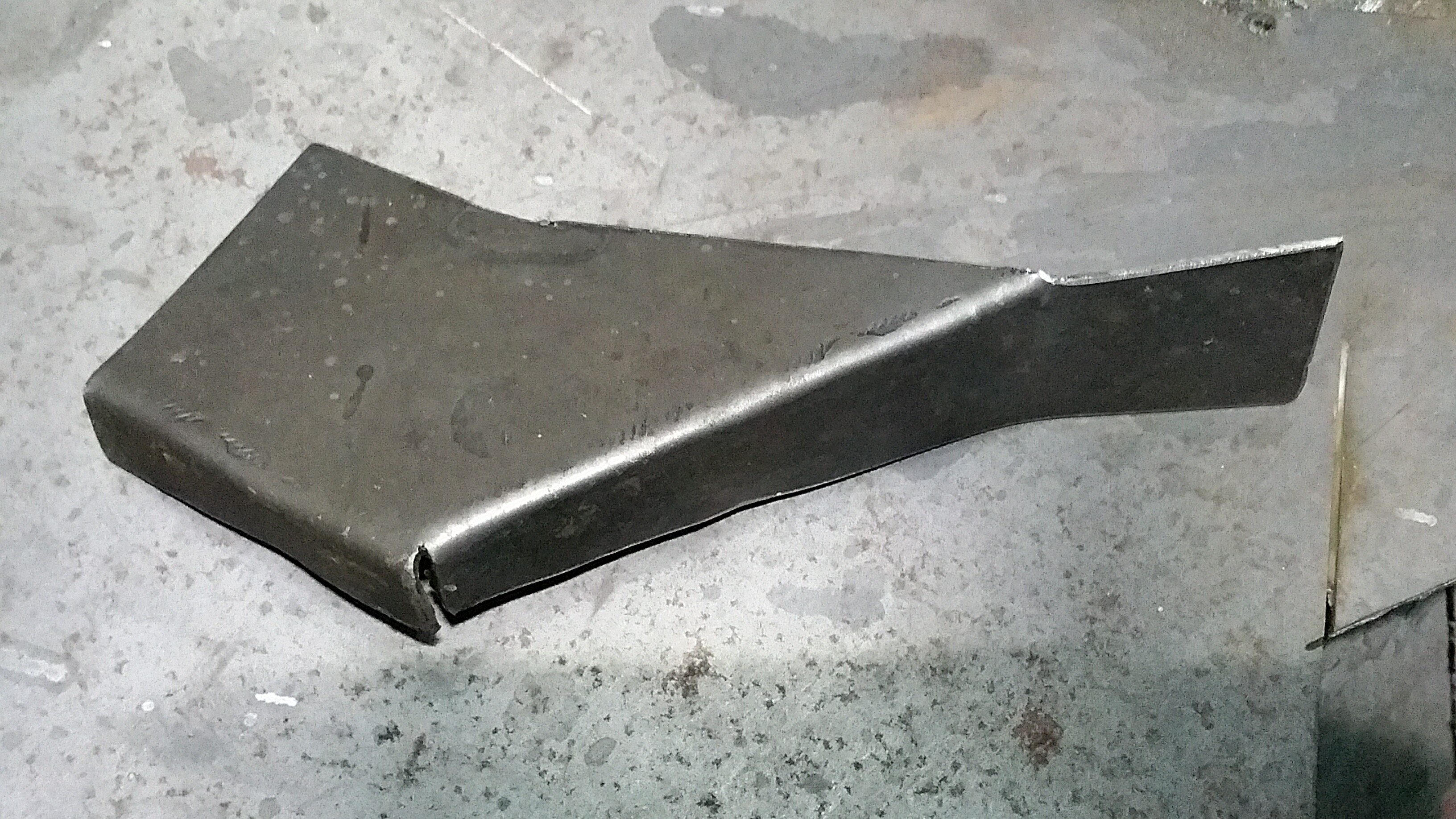

Morning Bob, did you ever source the panel you needed, I am in the same boat and need a panel but on the passenger side, inner arch. Have been doing a bit of undersealing, noticed a bit of filler, started to chip away, …DOH!!! :dizzy_face: :pleading_face: :flushed:

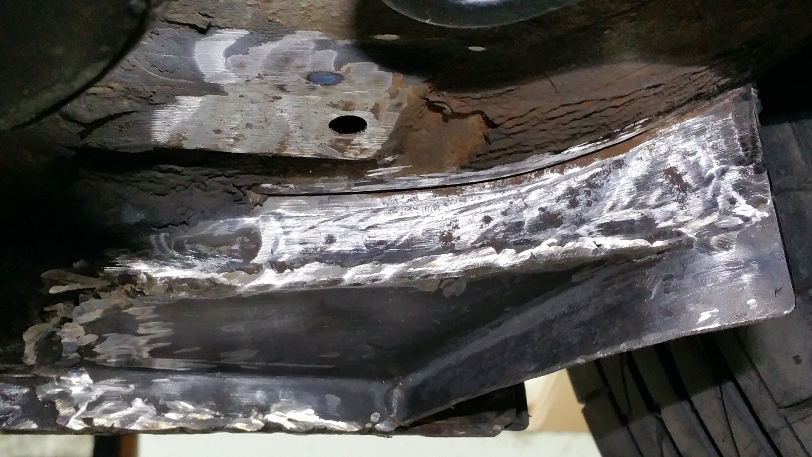

Bob, hehe :slight_smile: nah after the advice above, I got some sheet steel and make some up and just wing it.
This is what it looks like
similar to mine but the opposite side, I think it could be an MOT fail, what size plate did you go with, did you MIG Weld it. Its a pain as I have spent virtually every weekend getting rid of the surface rust in all the usual places and found it as one of the last areas I was doing :triumph:
Not done it yet. Got some 1.5m plate trying to decide if I’m brave or stupid enough to try it myself.
