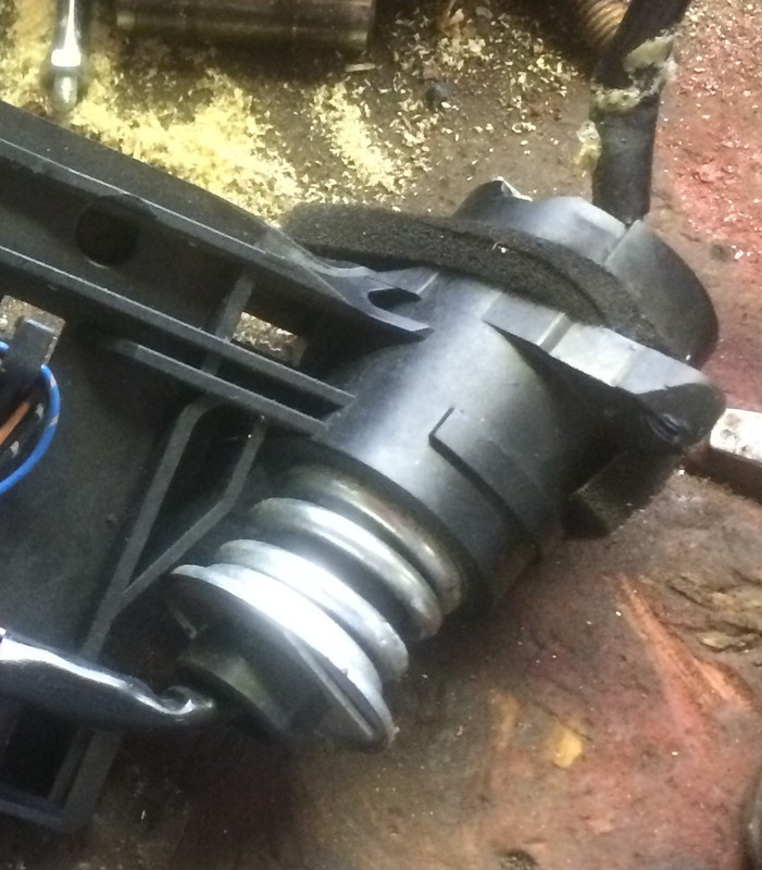

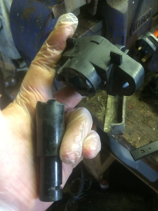

I picked up a cheap NC 1.8 for my wife to drive which has a few minor problems. One of them was a loose passenger side mirror glass. On investigation it was apparant that the break shaft had sheared and been repaired using contact adhesive to lock the break shaft in one position. I decided to investigate whether this could be repaired properly rather than cough over £100 on a new replacement.

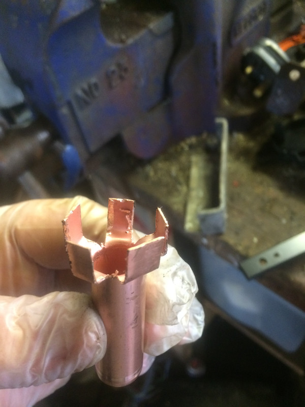

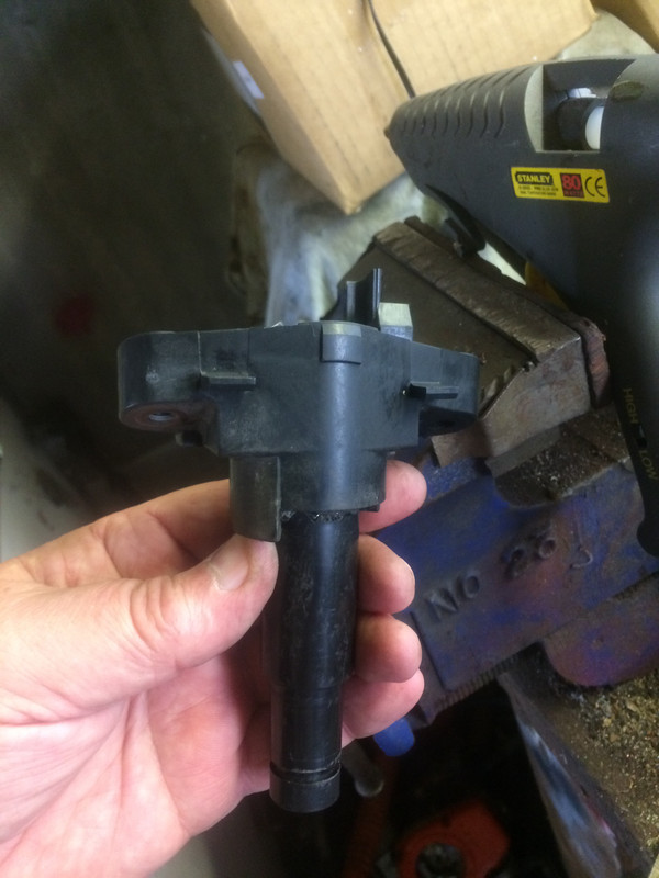

The significant challenge was to find a way of creating a solid fixing for the break shaft that has a hole through the middle to feed the wires for the mirror motors and heater. The solution was to use a piece of 15mm copper plumbing pipe, about 3 inches long, splayed out at one end and glued into the break shaft using a hot glue gun. Once glued and cooled I ran a drill through to clear the hole enough to get the wires back in.
Re-assembly is also a challenge; trying to find a method of compressing the strong spring to get the collar and U pin back in place. Eventually I compressed the spring in my vice and used a couple of pieces of stainless weld wire from my MiG twisted up like locking wire to hold the spring compressed a bit. Once installed I cut the weld wire to release the spring

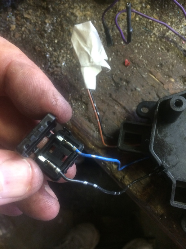

You also need to dismantle the two plugs than go to the mirror motors so that you can get the nwires through the break shaft hole.

Yes my method allows the mirror to rotate out of the way just like the original. The splayed end is to help the glued-in tube resist the pressure of the spring that would try to pull the glued joint apart.
