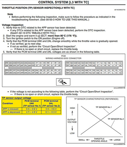

Also to point out, I have got other manuals, they tell me almost everything I need but they seem to be missing some key information that when comparing it to the cx-7 wsm doesn’t give me the voltage range for sensors, only an diagnostic software error code - which costs 20x more than a multimeter…

Thanks, I had already found them, they where the 95% I need but in the cx-7 workshop manual it has a little extra about the voltages
where as those manuals rely on the m-mds software (from what I read mazda as 2 diagnostic software, that one and another) that require specific hardware
The issue is this is for a conversion over to the cx7 engine and ecu - the connectors seem to be the same for a load of things but I need to know if the sensors are outputing the same signals (which I dont think that there are too many that would be an issue but the app sensor is different shape between cx7 and mx5 though the connector is the same - wiring may be reversed in said connector, dont know on output signal though)
