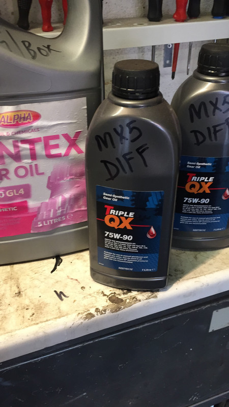

did mine a couple of months ago , heres what i used ,
changed gear box oil today @ 48370miles
( GL4 )
while under there i did the diff oil  (GL5 ) as well , i had the oil in my garage from the last mk3

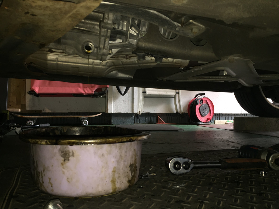

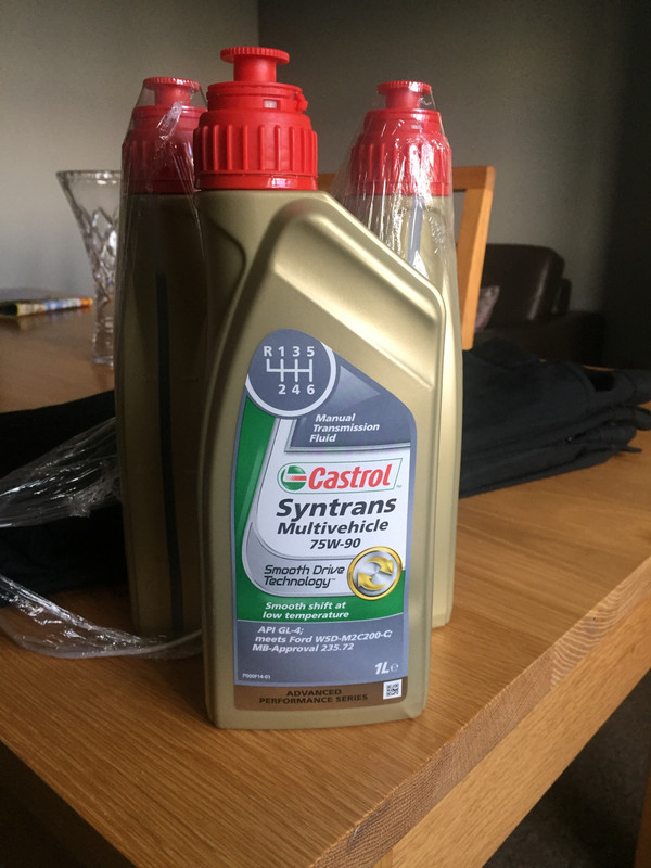

I have just changed the gearbox and diff oils on both our MK1 and Eunos.
The important thing is to change the oil. I cannot stress that enough having inspected the magnetic drain plugs and seeing the metallic particles in suspension.
I went with the recommended castrol GL-4 for gearbox and GL-5 for diff(MK1 - MK2.5) - it seems similar advice for the MK3.
For me it was an experience worth sharing, so hoping to post a thread about these oil changes when it is proven we did right after a few more weeks and some miles.
