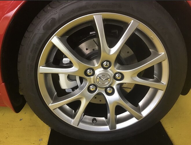

A couple of years ago, I replaced the original discs (which were badly rusted, especially the rears) and pads, with some Brembo units from ECP during one of their discount weekends. Got the lot for about the £150. Painted the calipers at the same time. Very pleased with them.

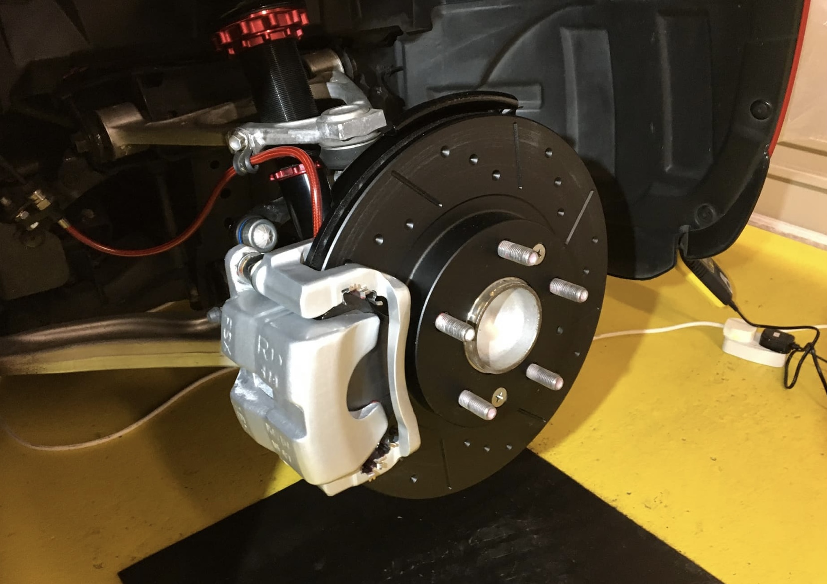

I went with Mtec discs, Ferodo pads and kept the callipers silver. The brake lines are HEL braided ones. The callipers and hangers were all smoothed down to remove the mould lines before painting and lacquering. I’ve never wasted money on calliper paint ever, just good prep and high temp paint/lacquer and never had a problem.

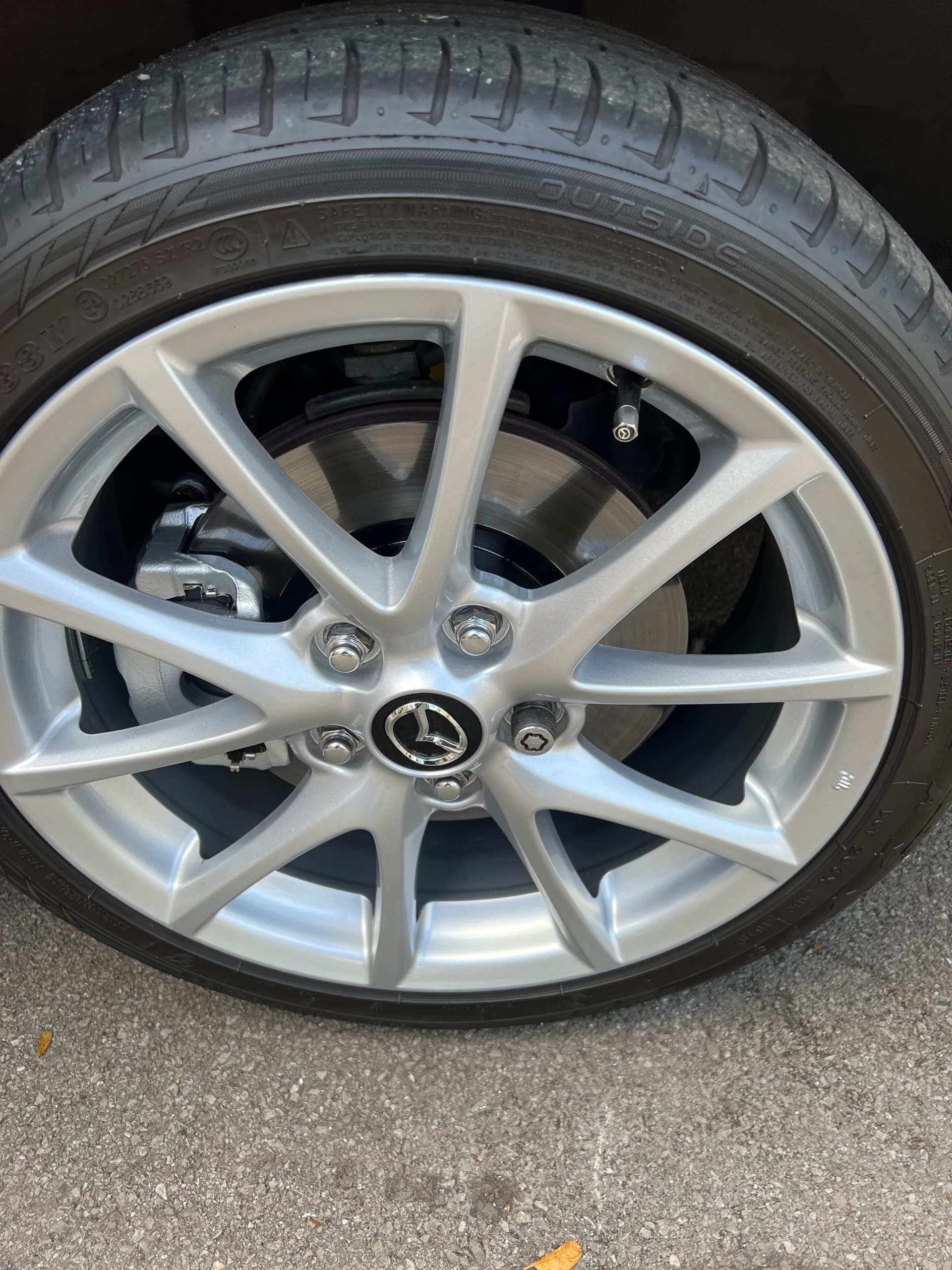

Did them early September. :slightly_smiling_face:
