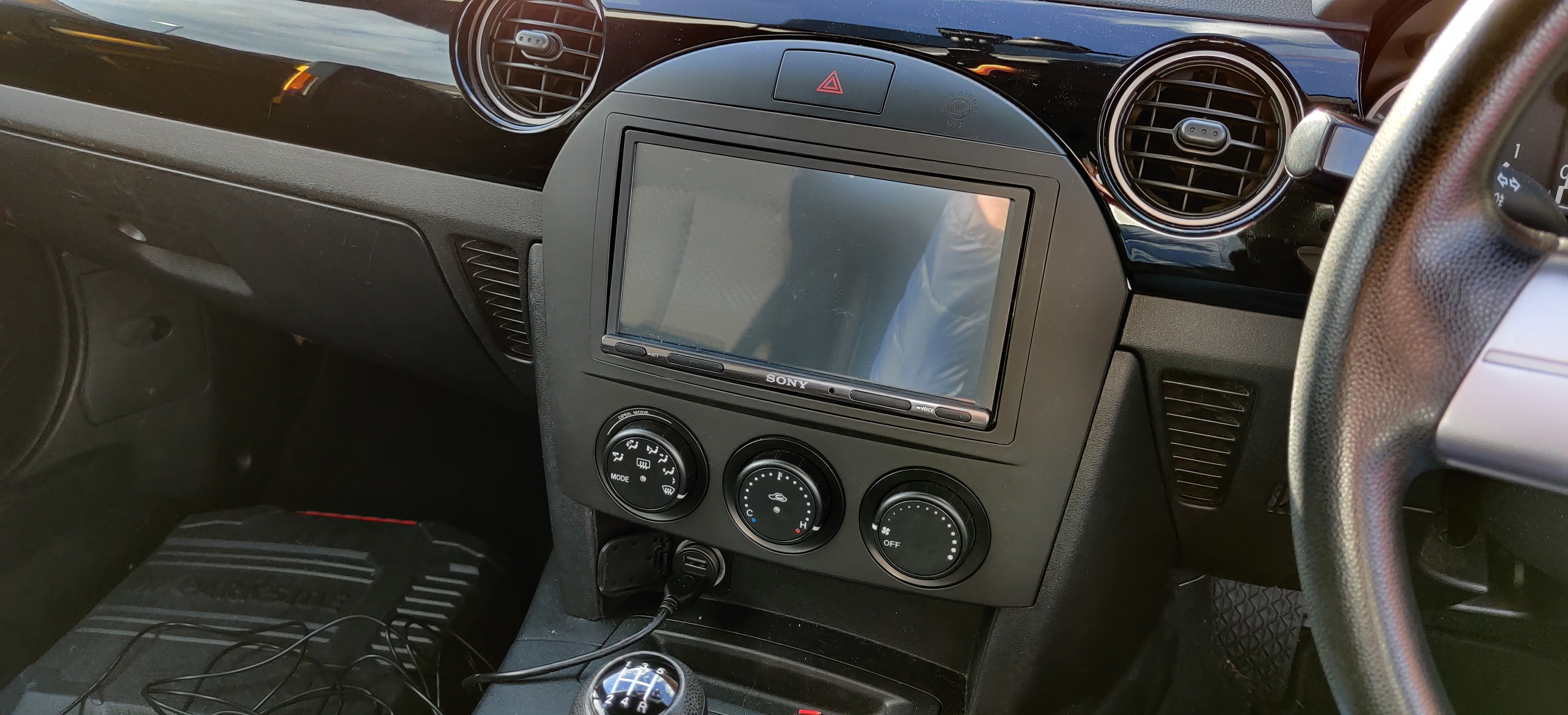

Here’s an image:
The panel gap between the fascia and the section with the hazard lights button is pretty noticeable and the OEM side panels don’t seem to fit quite right either, they don’t firmly click back into place and can be removed with a slight nudge of a finger. There’s also a sizeable gap underneath but this can’t be seen.
There is also the gap around the radio, which I’d like to solve but that’s a secondary issue. I used the trim piece from the kit, not the radio.
I’ve fettled with it as much as I can but can’t seem to improve it.
Does seem slightly different to my Connects2 kit. The trim piece is tighter fitting on mine.

Your pictured kit fitted in the car isn’t the same kit as mine, definitely not. I think there’s your problem, have they tried to pass it off as a Connects kit?

Also, every existing listing for the Autoleads kits seems to resemble the one you have, hence my confusion. The giveaway is the protruding section under the double din opening, where mine is totally flat.

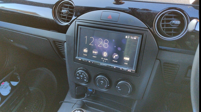

In the end I went and splashed out on a Metra Fascia (which I believe was the American brand for the Autoleads fascia) and it’s a much better fit. It also seems to closely resemble the fascia @MickAP has posted above.
Yep that’s looks the business.:+1:

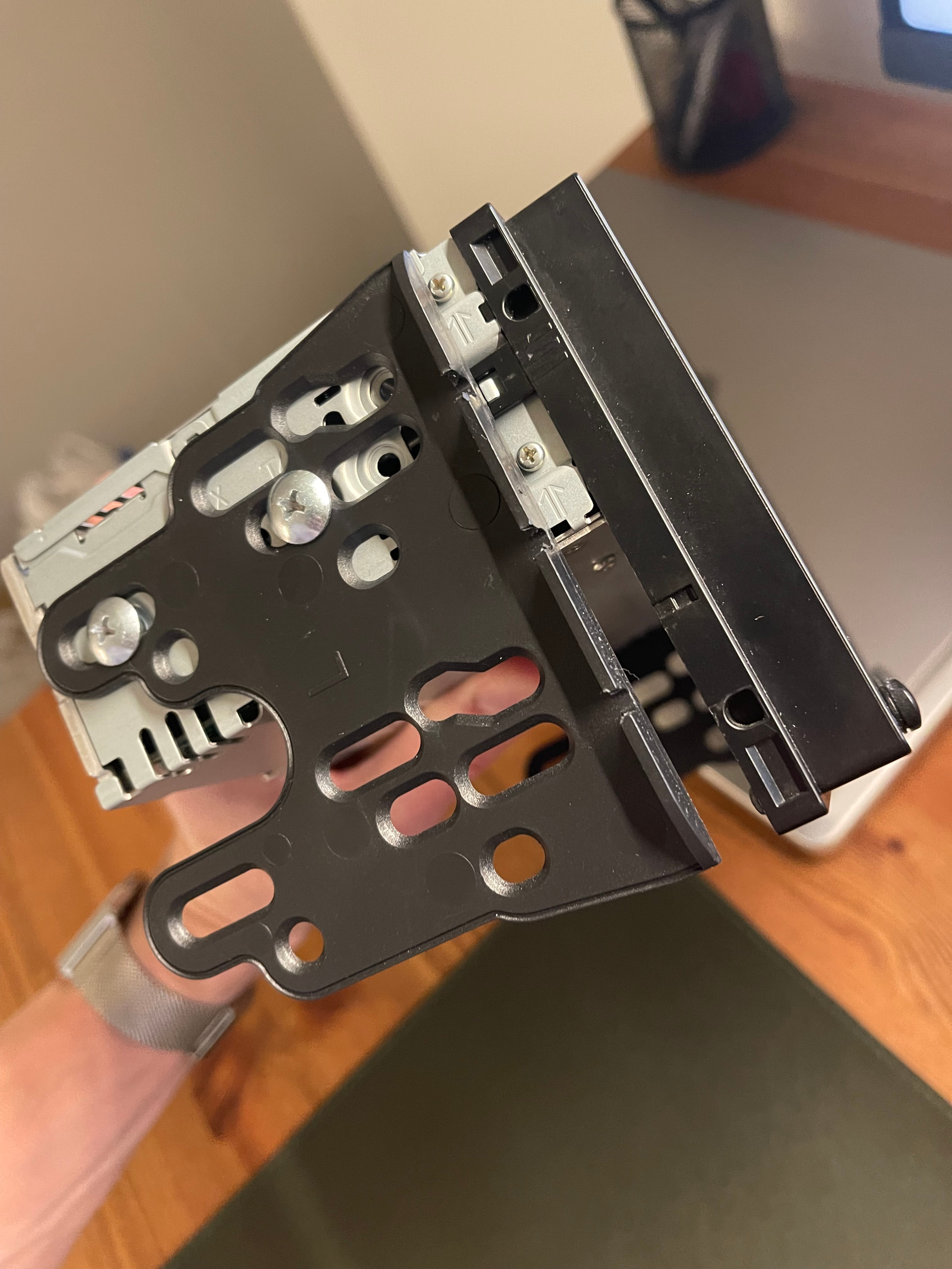

Silly question, when using this type of fascia how does the head unit actually attach to the fascia / inner bits under the dash? I assume no “mounting sleeve” has been used here? Is it as simple as these plastic bits mounted on the sides of the unit, slid into the fascia from the inside, then the trim ring snapped from the outside holds it in place?
I seem to remember you push the mounts sideways in to the facia plate opening and then mount the head unit in between them to hold them in place.
Then add the trim ring to the front and adjust the depth of the head unit so it sits flush with the facia plate.
