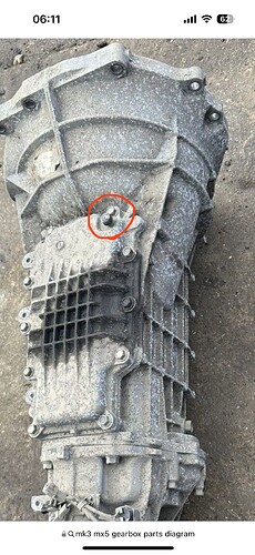

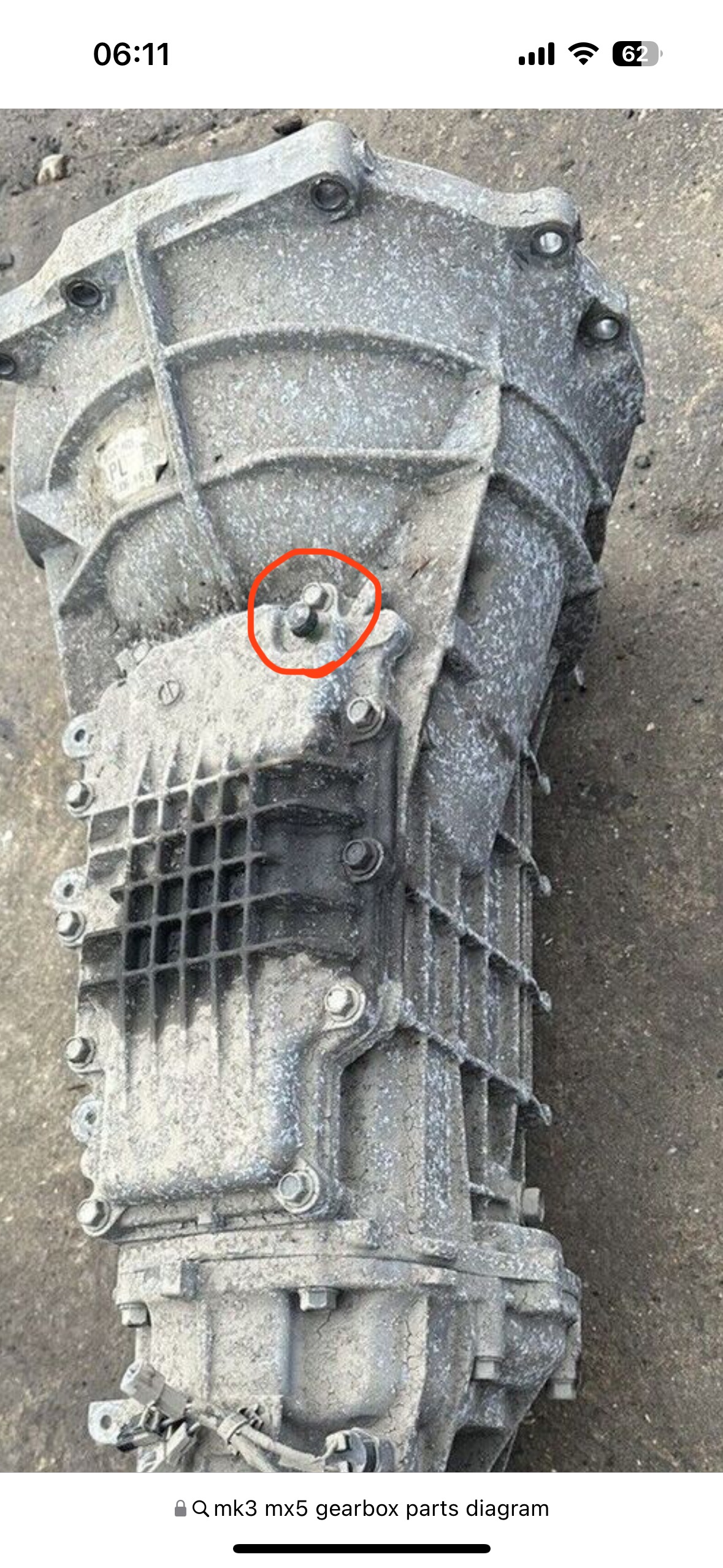

I assume this is the vent, drivers side just back from bell housing?
Probably just going to be a case of reaching up the side from below.
