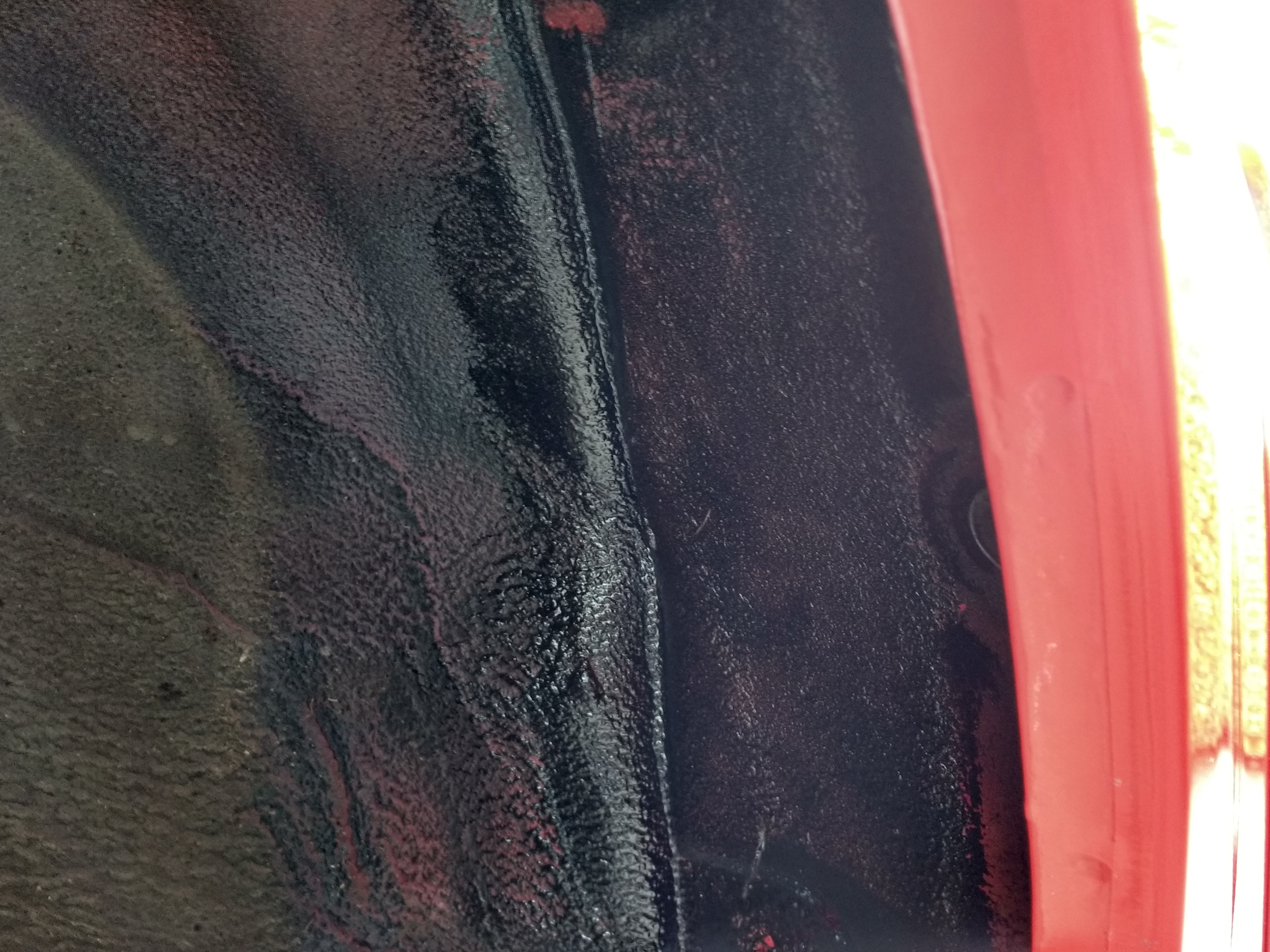

If it helps I did this to mine, pics below.
Removed arch liners painted with Hammerite up under the arch and the inner part of the lip. No rust found there, it was a precautionary treatment. The lip you can see I had a couple of bits with surface bubbling of the paint, about finger nail size on both arch lips. I decided to treat the surface rust then paint with epoxy mastic, cover with grey primer (a light sanding inbetween coats) then finish in body colour. You find it hard to see where I’ve been with the treatment but it’s future protecting the vunerable parts prone to rust.
