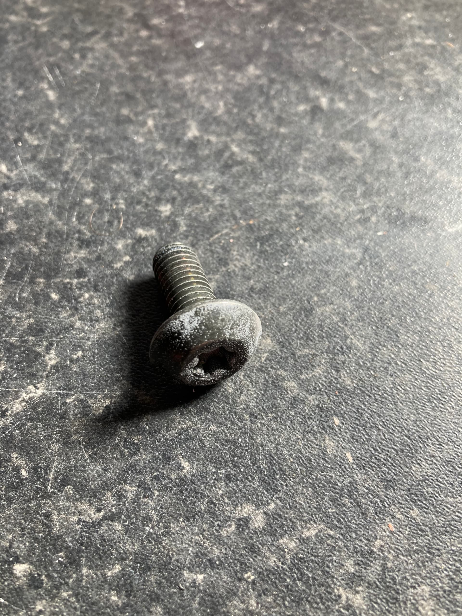

I had a bolt drop out of the central mount and rattling in the plastic. Took me ages to find it because I thought it was actually lower down.

Firstly, it may not be that of course. But certainly worth a look under there.
Remove the bolts from under-the sun visors.
Then the brackets left and right.
Then “tease” the left and right windscreen plastic uprights. They pop off.
Then just pull the plastic tops down, all being well.
Be careful of the central light housing/wires etc.
Easier than you think from memory.
Good luck. :slightly_smiling_face::+1:
