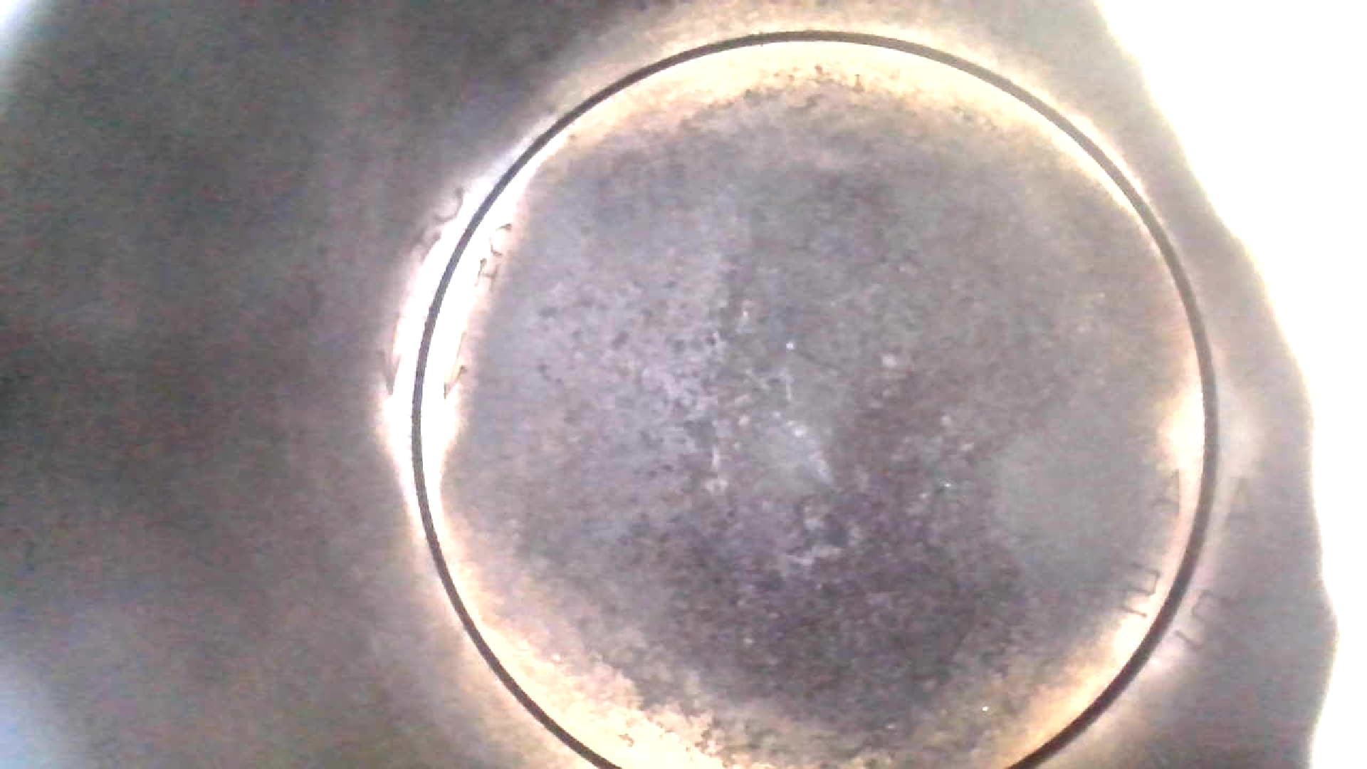

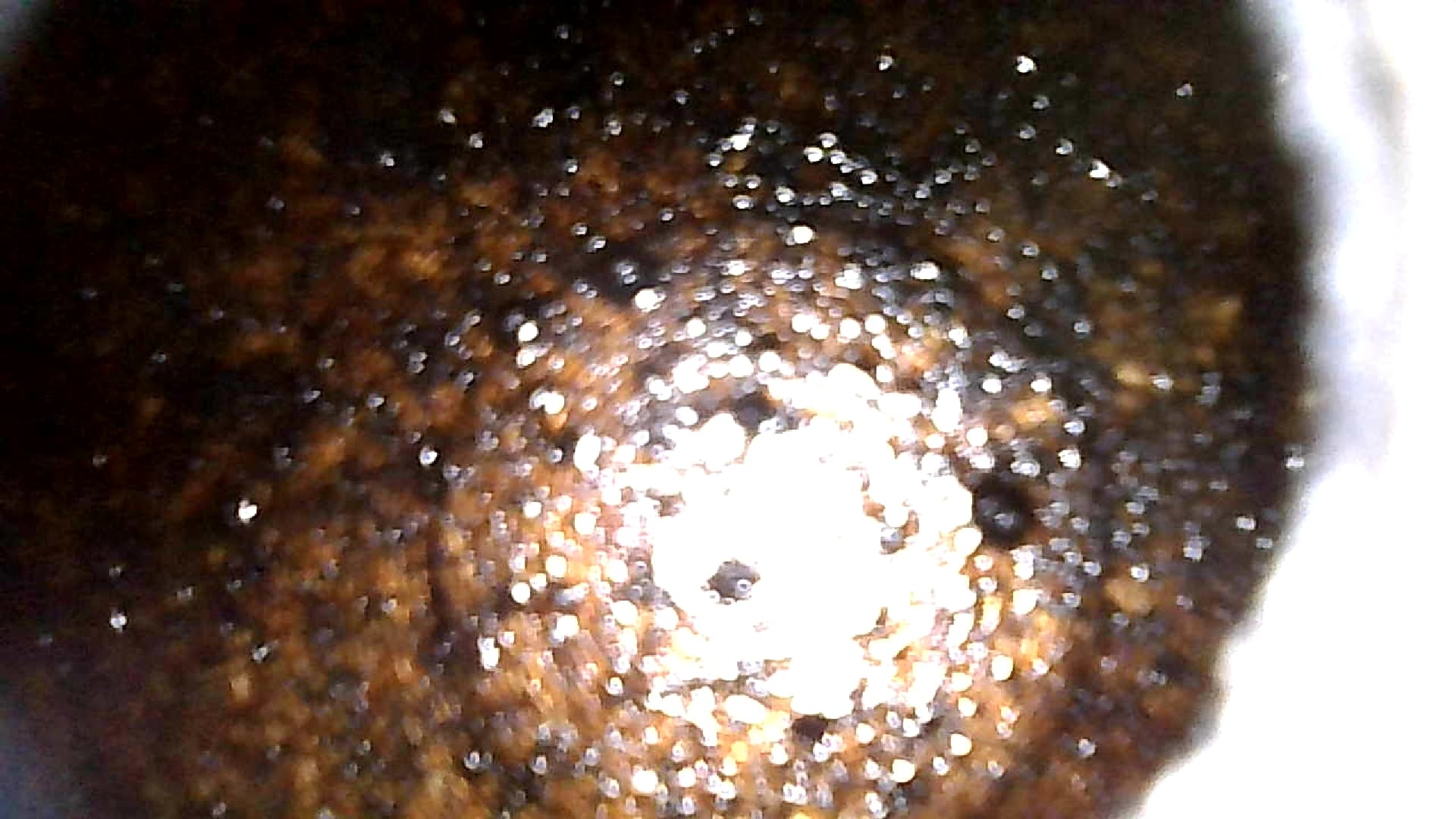

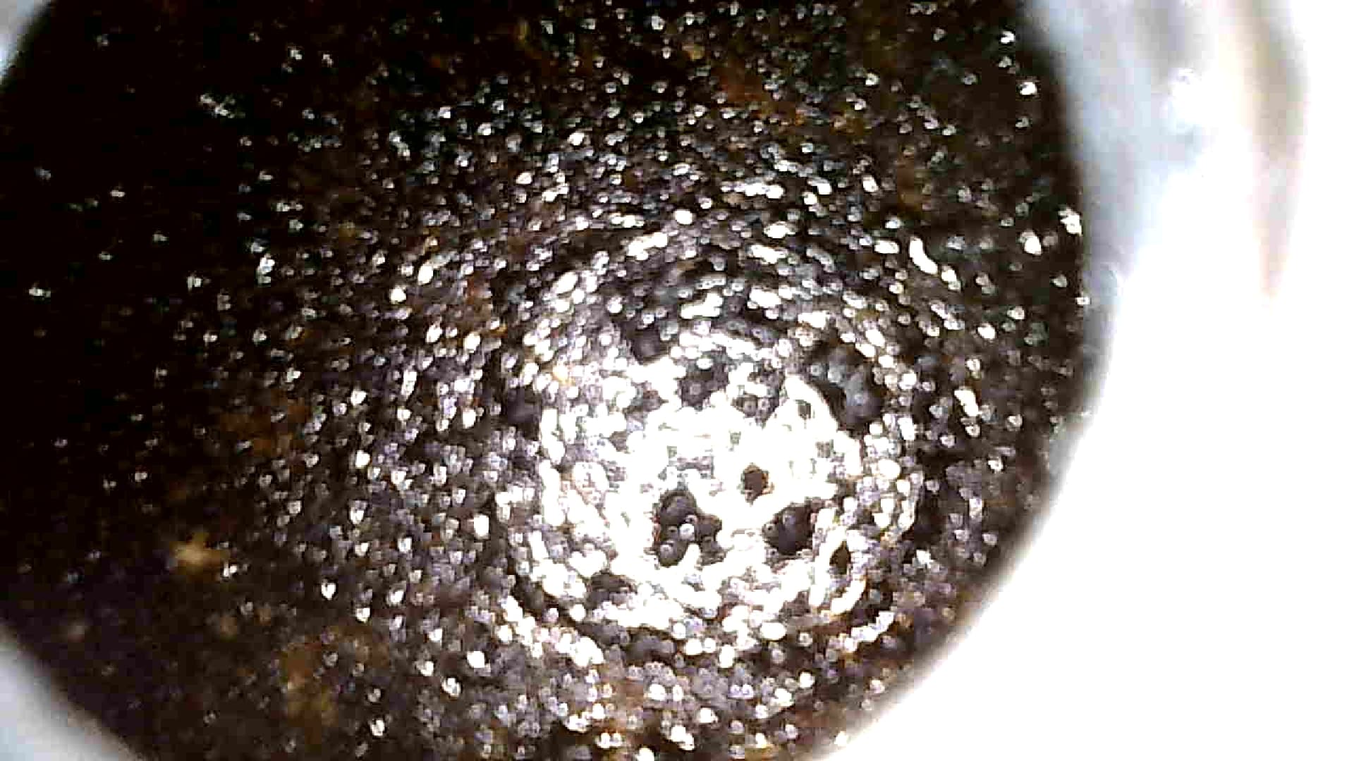

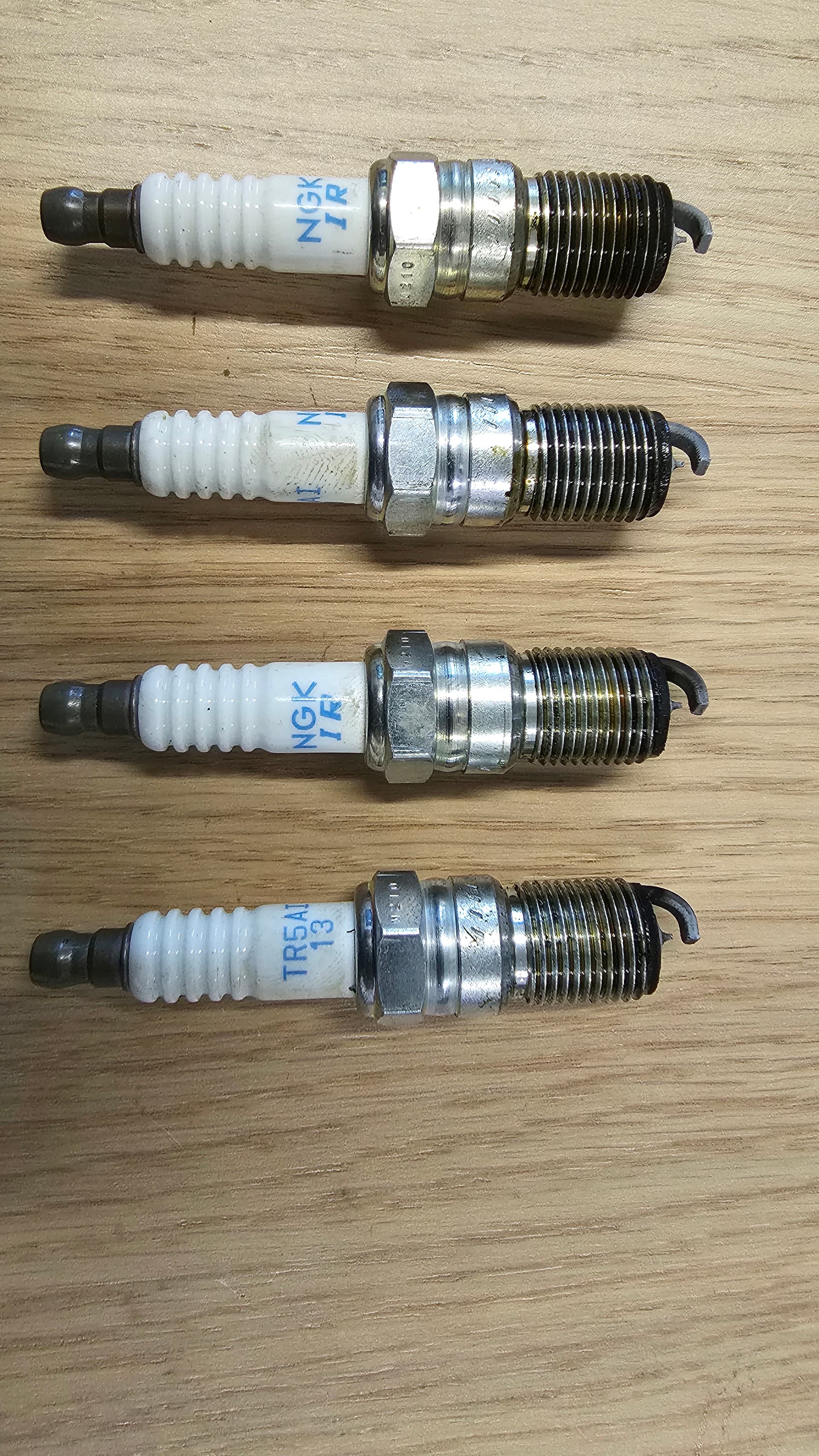

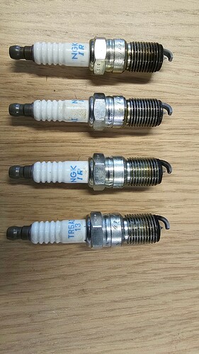

I carried out a Compression Test as per the Haynes Manual procedure and got consistent readings of 250psi on all four cylinders. I checked the Spark Plugs, also new at the MOT, and the two from cylinders 3 & 4 were a bit wet - see pics. I used an endoscope and had a look into each cylinder to find the piston crowns in cylinders 3 & 4 were coated with burnt oil - see pics. Cylinders 1 and 2 looked in great condition, with just a ‘normal’ coating on the piston crowns and the markings on the crowns still visible.
Given that the Compression Test doesn’t indicate any loss of compression and the fact that it’s only affecting two cylinders not all four, my thought process goes like this:
If the PCV was faulty, I would expect contamination in all four cylinders - as it’s only two cylinders could it be Valve-Stem Oil Seals?
I am also wondering whether it’s the Oil Control Rings on Pistons 3 & 4 that have got stuck and whether there’s anything I can put into the Cylinders to potentially clean the burnt oil that might be gumming them up.
Any thoughts or guidance based on previous experience of these engines would be very much appreciated.

Skip to 11.55, it will no doubt be the rings
