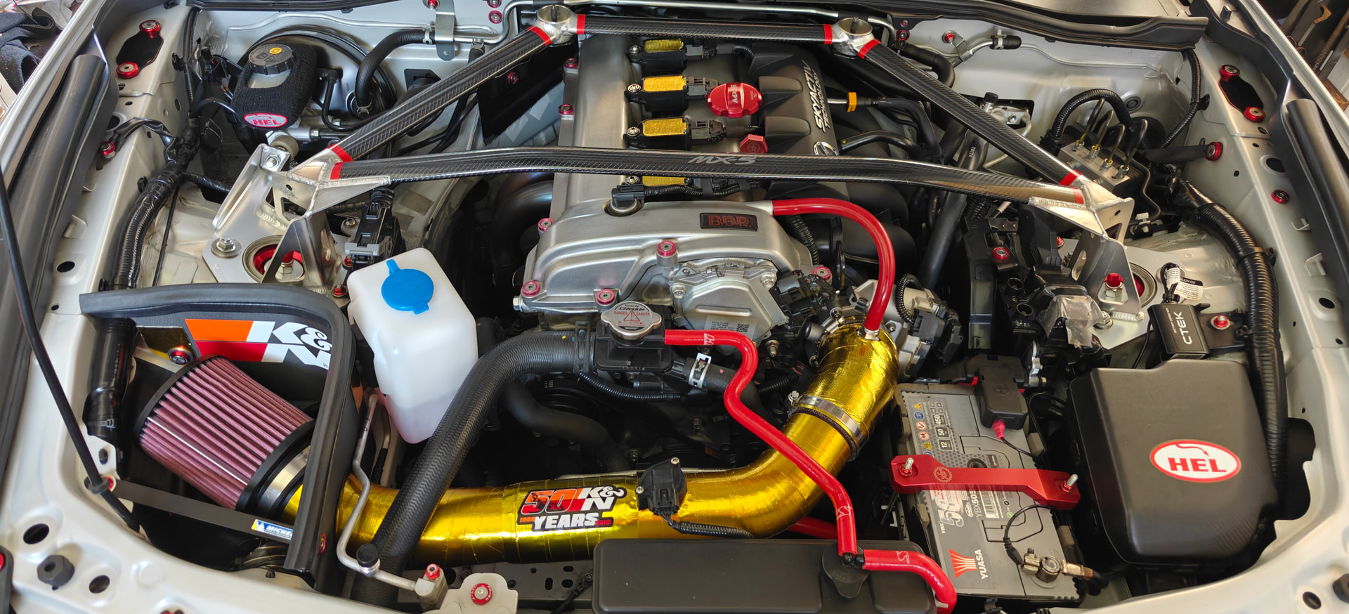

A chap has been making some very useful 3D printed parts for the ND, and turned his hand to an intake system.
The result, is that the OEM washer bottle is removed as that is the optimal place for a new airbox, where it can get cool air from the front straight into the engine bay. (washer bottle can be relocated very cheaply - i spent about £15 on mine).
I picked this up myself and run some testing on it with the EcuTek, and did back to back runs checking temps with it vs the OEM airbox. under full power pulls it drastically dropped the intake temps vs the OEM. win!

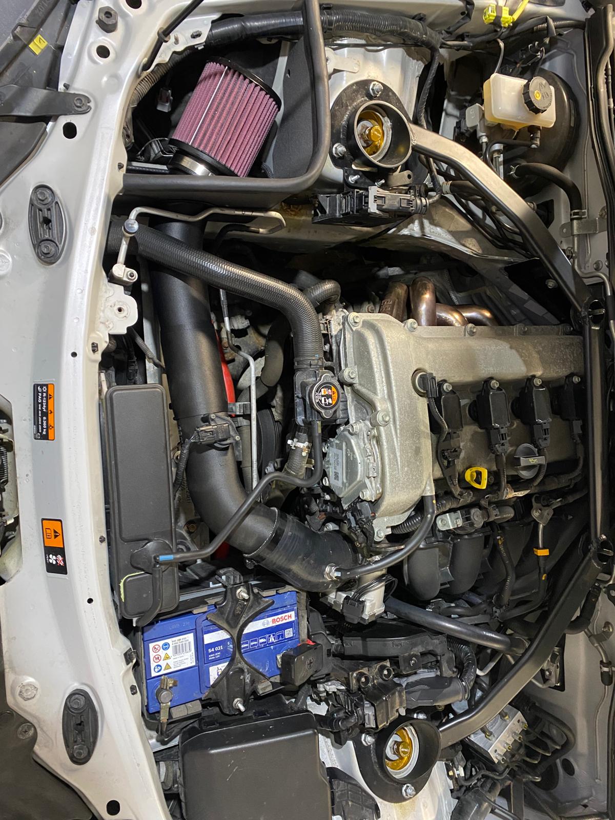

The intake in my car (washer bottle not yet refitted).
