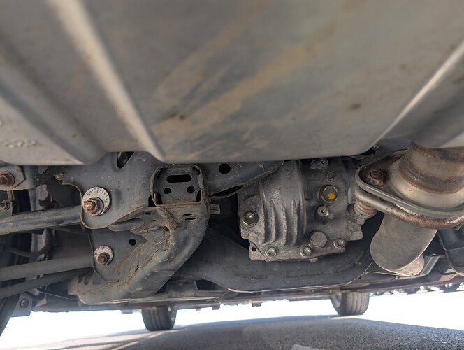

So ive been to look at an ND today an dall looks great apart from a delaminated ICE screen and a few marks on the bodywork. However when looking underneath it looks okay to me but having heard that the underside can be a nighmare for corrosion can someone look at the image attached and say whether it looks okay or not?

Looks surprisingly good for a '16 if it was used ‘as a car’. How many miles are on it?
That looks absolutely fine for a car that is 8/9 years old. It would clean up very nicely with a bit (a lot) of elbow grease.

Built my own Kitcar so okay working on cars. When you say to tackle the underside, what is the recommendation of how to do it. More than happy to do the work underneath, I just need to know what others have done and what to use etc.

You need to start with a degreaser and cloths. Some heavy duty cleaner and water would be good and once you have removed the ‘grime’ some wire brushes to get any surface rust away. After this it depends on how keen you are. Some would go rust converter and paint others might be happy just to use something like Duck Oil Swarfega Duck Oil Multi-Purpose Lubricant, Rust Protector, Releases Rusty Bolts, Light Degreaser, Silicone Free, 5L Can : Amazon.co.uk: DIY & Tools and top it up on a regular basis.

where do you get the Ideal that nd’s are a nightmare for corrosion
Just from what I’ve read from a few posts that it is wise to get the underside protected properly otherwise they can corrode badly underneath due to road salt.

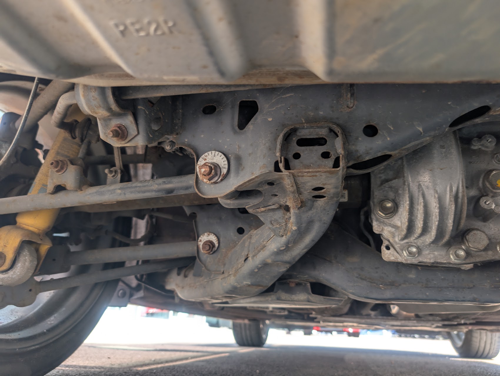

For what it’s worth,I looked at a 15,000 mile, 2016 ND last week. Also had screen delamination in the corners. This was the underneath:

Looks better than my 17K, '18 ND, which over the last 4 years has pretty much seen no rain or salt, and in the early days didn’t see that much, relatively either (and would get hosed underneath regularly etc). I’m not by the coast or anything too.
I’ve just bought a late 2015 ND1, yours looks as good as mine underneath, mines had underseal from new though. Looks like yours will need some too to keep it protected, I reckon it won’t take too much prep for that, very little bits of rust poking through, it’s pretty good actually.

I think you need to buy it if the price and everything else’s checks out ok.:+1:

That certainly looks very good and very similar to the one I have looked at. I guess it depends on when/where driven and if previously protected. Just that I had read that others had said that if driven during the winter months or left out the underside could be at risk from corrosion.
