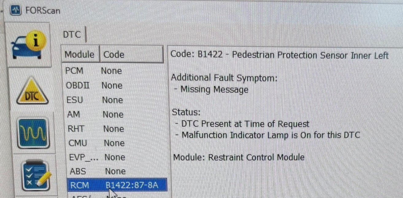

I’m getting a active bonnet error on the dash 4 flashes then 1 flash I’ve plugged it into ForScan and it’s giving me the following error:-
Probably a stupid question but do you think it is the sensor nearest the centre of the bumper on the lefthand side.

Managed to fix it but it was a bit of a weird one the FORScan error code descriptions were a bit misleading.
B1422 - Pedestrian Protection Sensor Inner left.
Was actually the far right hand side sensor (driver side RHD car)
I only found this out by unplugging a few of the other sensors for example I unplugged the far left hand side sensor which came up with this code.
B1427 - Pedestrian Protection Sensor Driver Inner.
Also to confuse matters further the second sensor in from the right that I unplugged comes us as.
B1423 - Pedestrian Protection Sensor centre.
So to summarise the 6 sensors go from right to left starting with code B1422 to B1427.

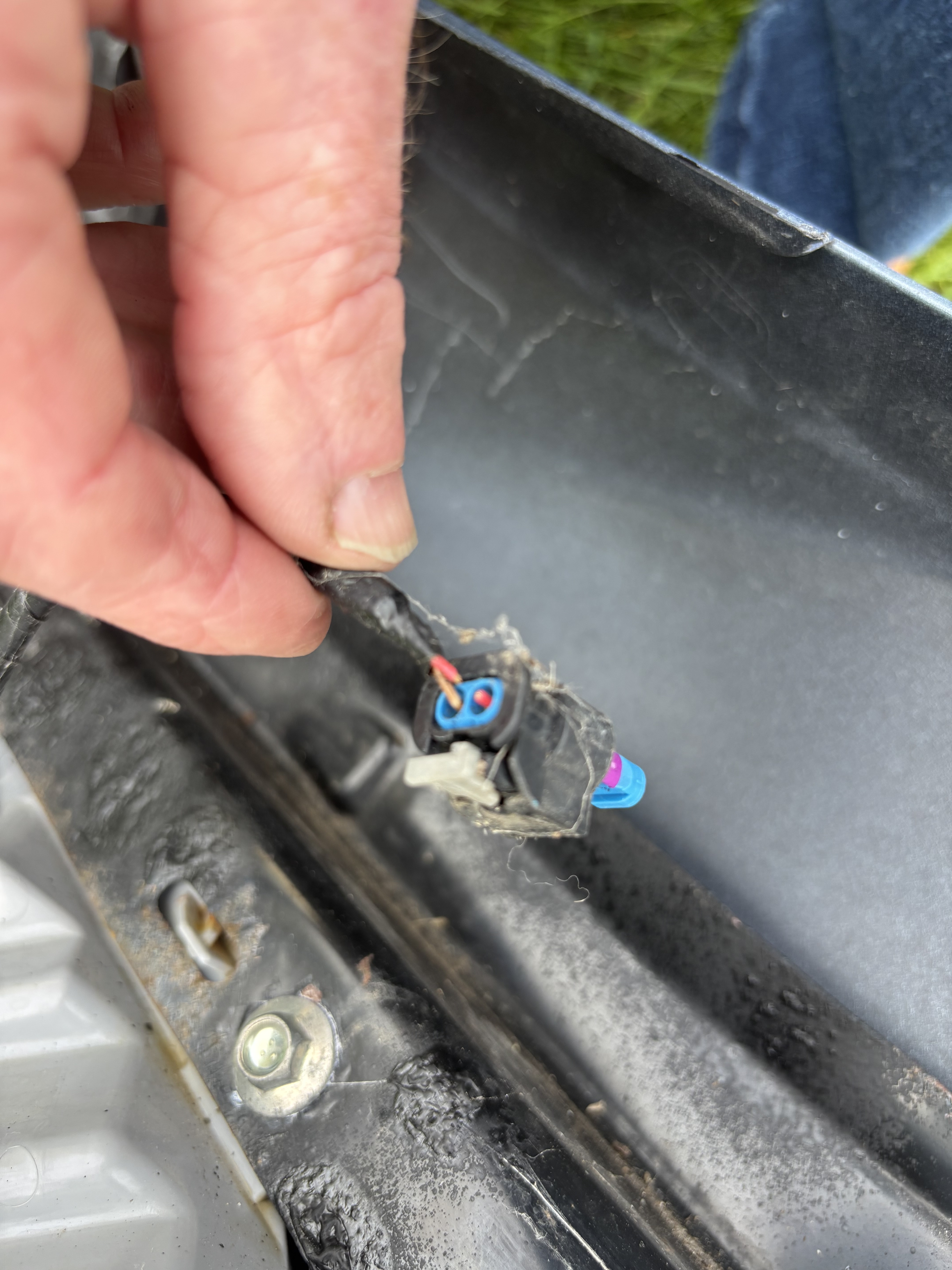

And the issue I had was that the far right hand side sensor had a break in the wire which I have now fixed.
Good detective work, thanks for sharing the resolution.
