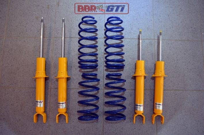

At the risk of being that person, have you looked at BBR’s Koni kit? I find it very comfortable, and most of my driving is on B and back roads.
I forgot about that option but if I remember I kind of ruled it out sometime ago, because when I did speak to BBR I didn’t feel the info was very in-depth about the revalving damper information. Not that I wanted specs, but what did they try to achieve with the revalve etc. but didn’t get anywhere. I have read on USA forums that most seem to run the koni dampers at nearly full soft, and the adjustments was therefore largely redundant?
Good to hear someone likes them, do you run the BBR at nearly full soft too?
As far as I understand it, the Koni option BBR offers isn’t adjustable?
The BBR Koni option sprang to my mind as a suggestion for you as well, but I think you’d have to have a journey out in an equipped car to see for yourself. Given different suspension options, for different people, on different surfaces, is entirely subjective.

The Koni dampers are adjustable!
OK!
It’s this set then?
