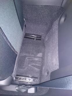

This was done in The Abarth 124 Spider and it does relate to the ND.

looks good, is it possible to increase the front height of the passenger seat?
