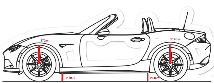

I would set the front to give a height of 320mm from the lip of the front arch to the centre of the wheel. Any lower and you will be scraping. I’d fit Eibach arbs as well (which is what I’ve done).
These are the measurements ive just taken. probably about 5-8litres f fuel from full. otherwise, empty car.
From the underside, there is a little amount of rake. which would increase as the fuel reduces. rear wheel is a little higher in the arch.

Considering the pinch weld height is approximately 145mm all round on a standard ND with Bilstein suspension fitted, the figure seems awfully low. Compared to my figures, you must have no wheel gap?

Based on my measurements from my screenshot above, Blue’s looks spot on, no? a 40mm drop in the arch would equal about 105mm pinch weld. allowing 2mm for accuracy in measurement and/or car fluids.

(for wheel center measurements, i only roughly checked as i dont like that measurement, but its approx 12" and an 1/8th front, and bang on 12" at the rear. )
For comparable reference and future use, could you provide measurements from the wheel centre to arch?

From the center of the wheel in mm for accuracy vs inches)
Front is 310mm center to arch
Rear is 315mm center to arch
I also re-measured from the pnch welds while on the floor
Front 95mm
Rear 100mm (dropped further… or my inaccuracies earlier).
