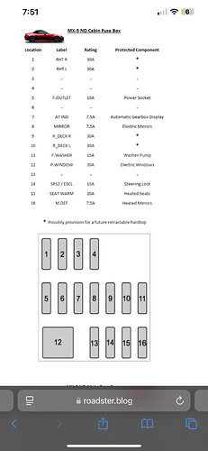

I was doing an installation of my nextbase dashcam and was looking for a live fuse in the passenger footwell fuse box which I managed to find .
It is in position 13 on the fuse box diagram if anyone was wanting to know
and it strangely is listed as blank on the diagram .
I couldn’t find this info without testing it myself.

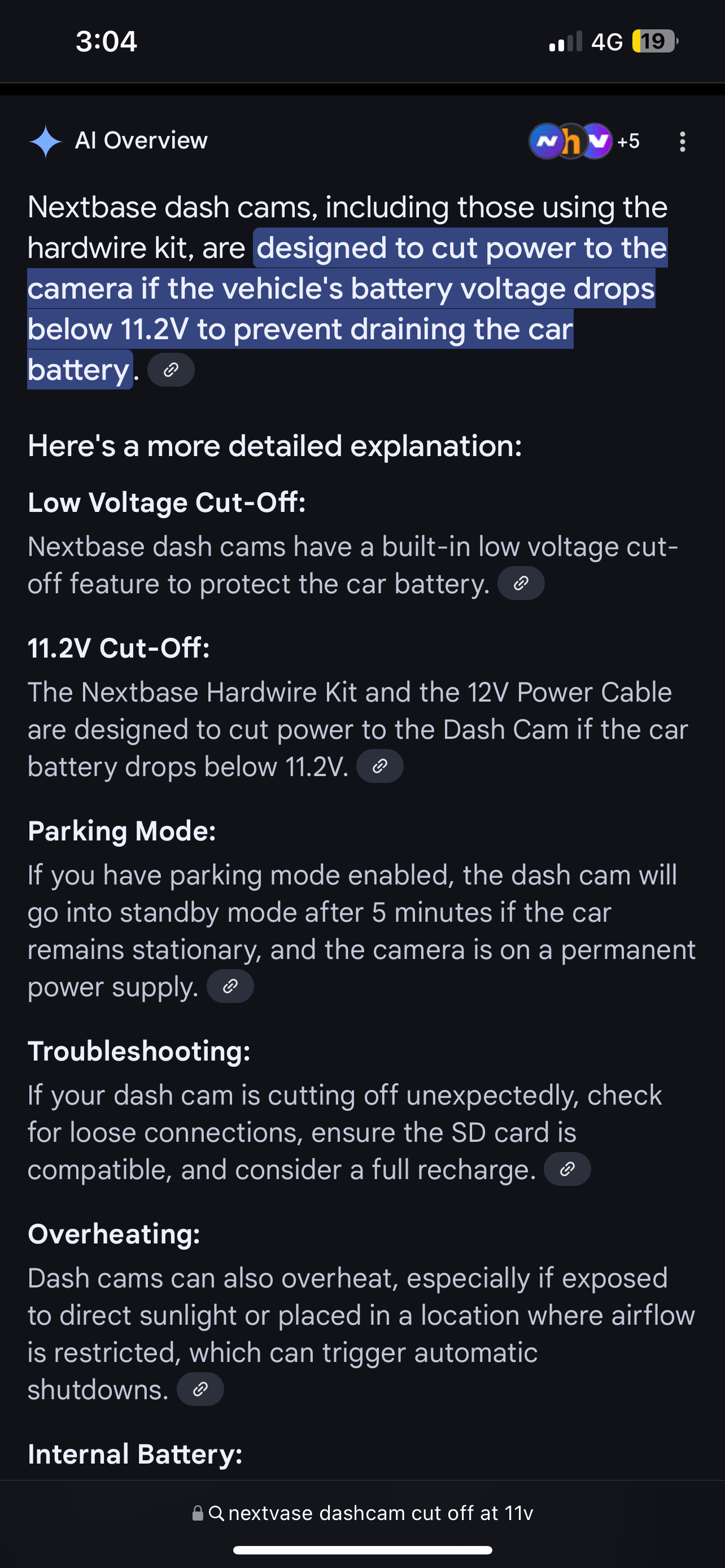

Hi , thanks for your reply Paul , nextbase dashcams are meant to cut off the power supply when the car’s battery drops below 11.2v to prevent the battery from going flat as stated below . So not sure why this has happened to yours but I will keep an eye out ! Also My car is also being used daily. And it had this enabled on the previous car which never went flat .
