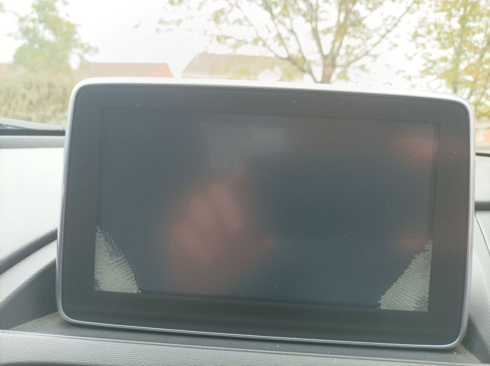

    I bought the car over 2 years ago, the car is just coming up to 5 years old.
    I have noticed that the screen is just starting the delamination process that seems a common fault.

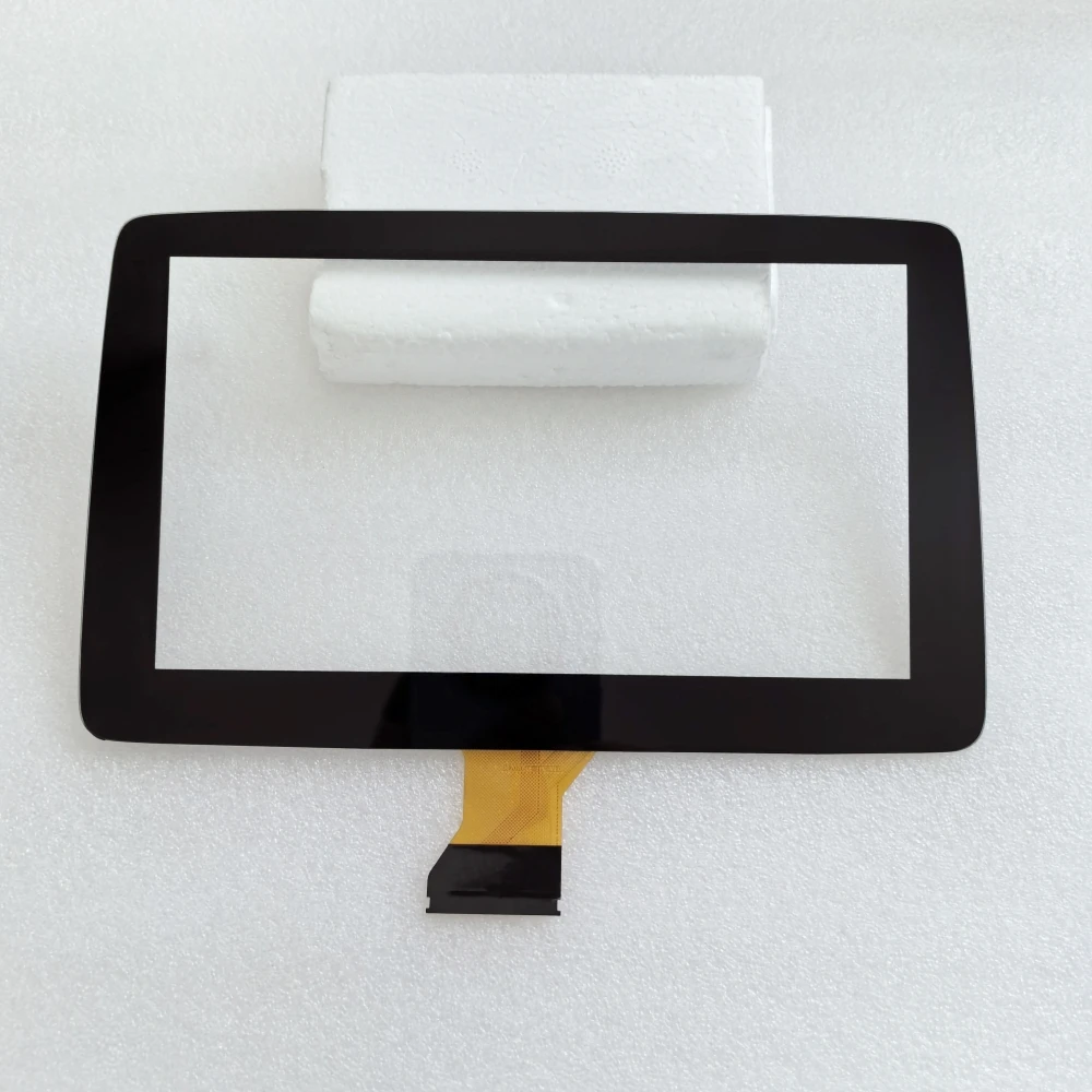

I have an ND1 and this is the item I bought;
Not sure if its the same for an ND2 so best to ask that question before buying.

Before:

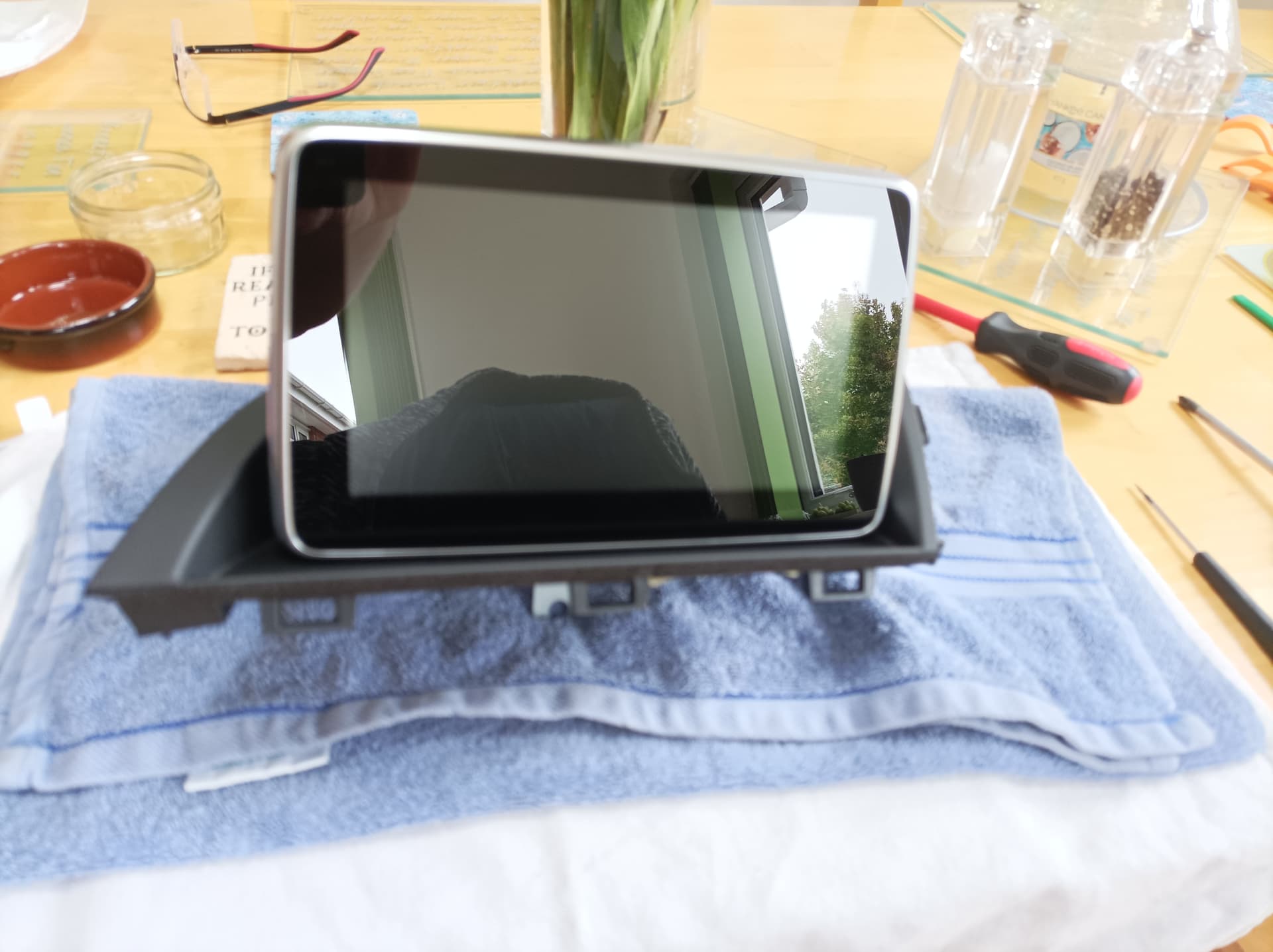

Re-assembled:

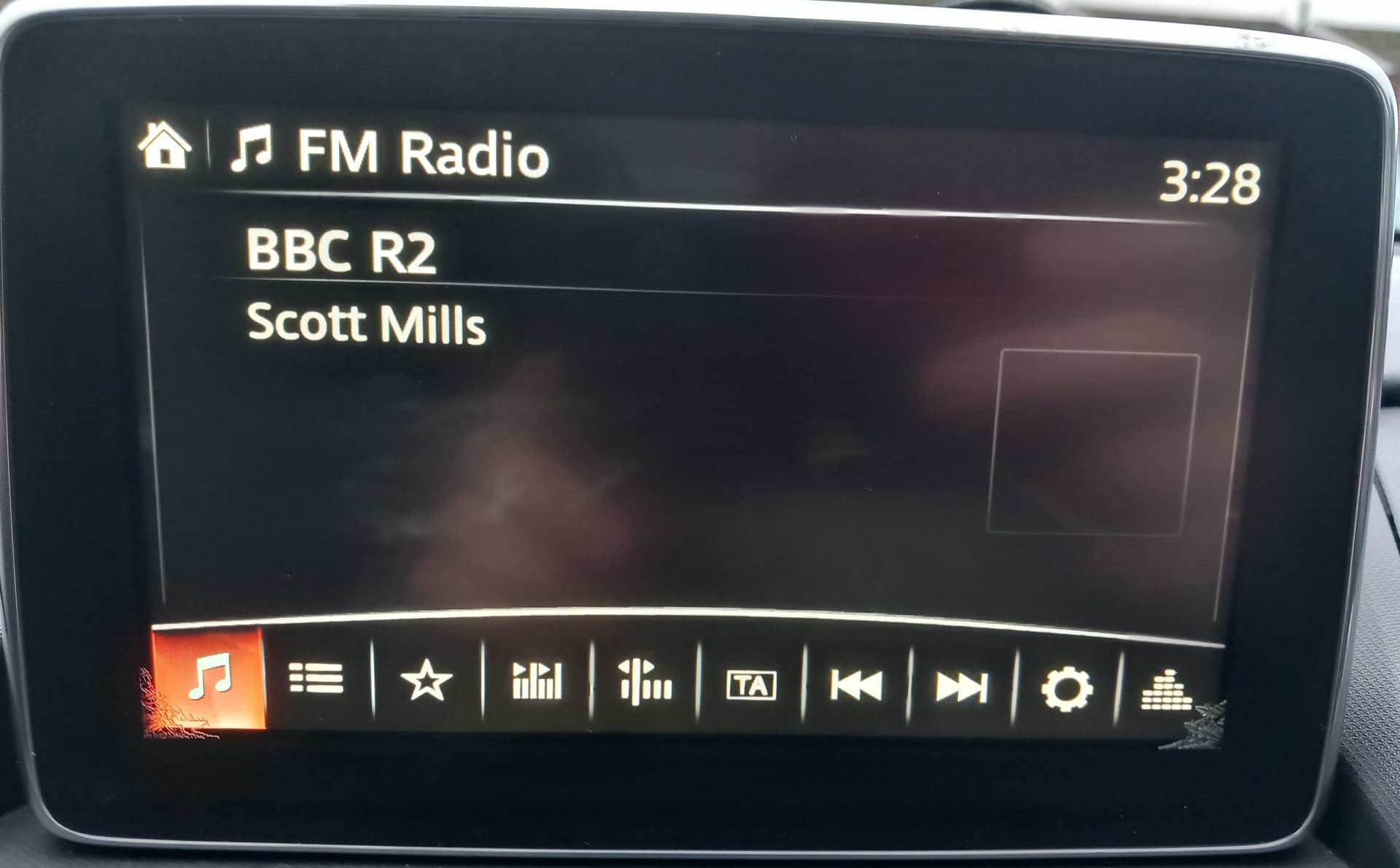

Back in the car:
Total cost: £15, and a bit of stress and swearing.

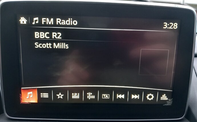

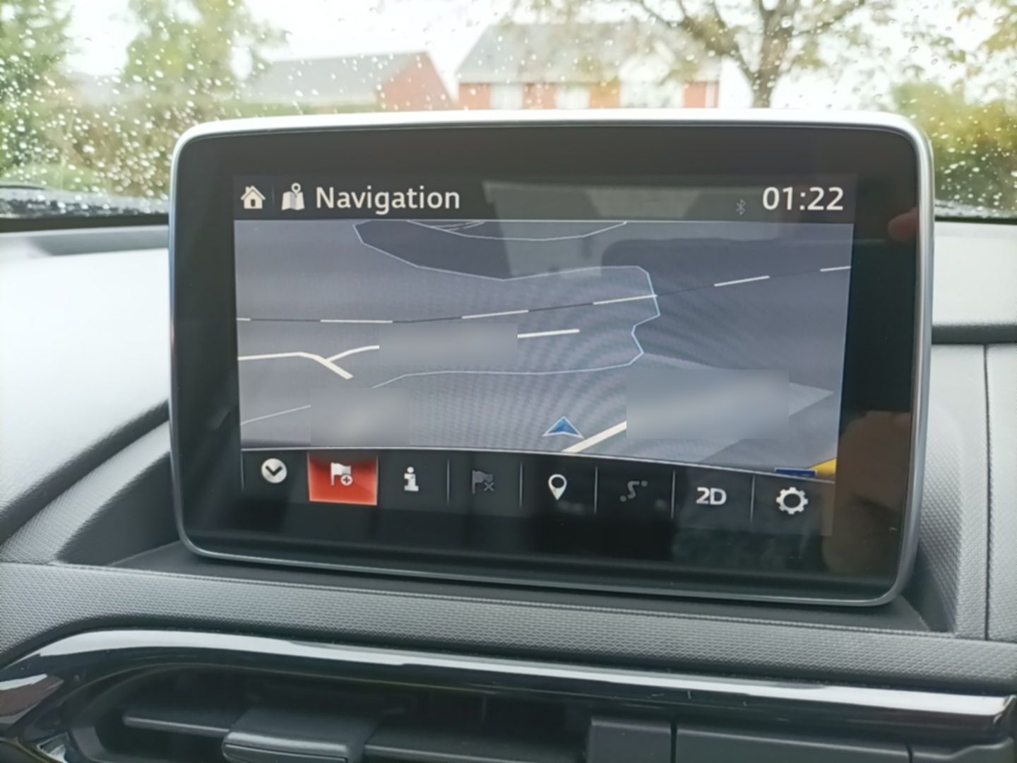

Here is my screen before (compared to after in post 3 above)
Look at the reflection on the screen of my phone to see the effect of the new screen (also visible in jingars before and after shots).

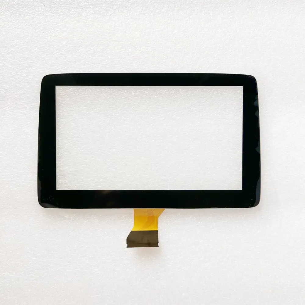

I understand that the ND2 needs the 50 pin screen rather than the 36 pin for the ND1 so probably one like these;
or
Neither of these ads state model year which is what you really want. I notice that they state different screen resolutions which seems odd as they must come from the same manufacturer?
