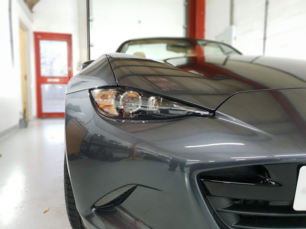

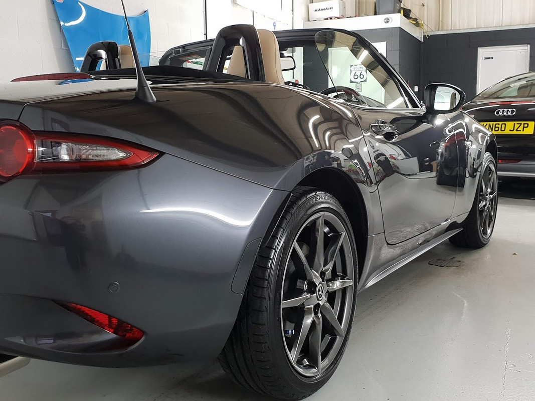

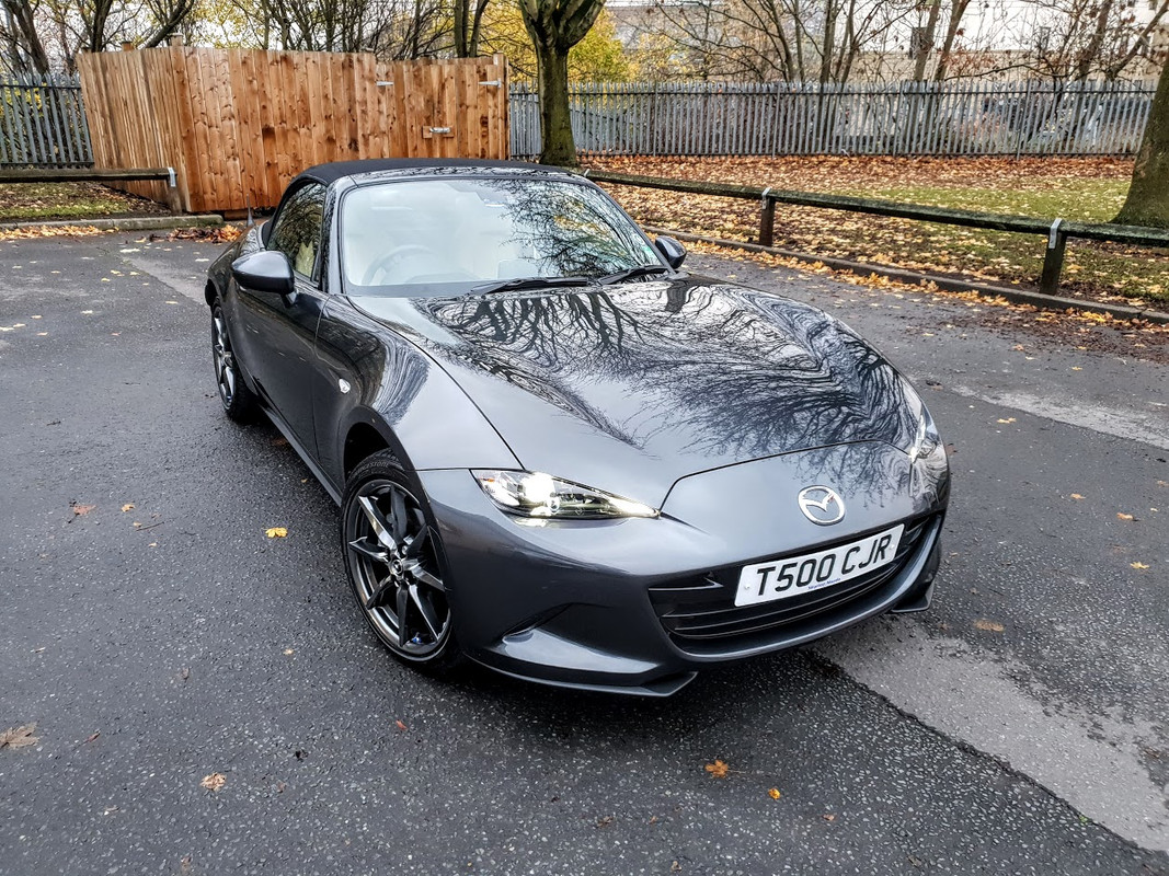

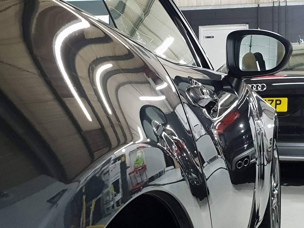

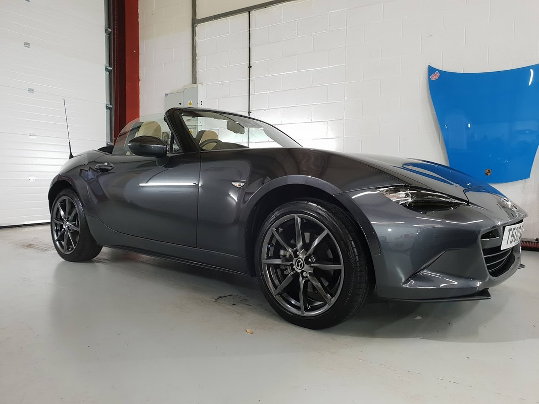

Pictures of the finished car:
A new coat of Infinity Wax to be applied after 6 months, but should last 12 months over the Miyabi Coat with careful washing with pH neutral Snow Foam and pure shampoo

Wow, that looks amazing - especially the 5th picture down from the top
