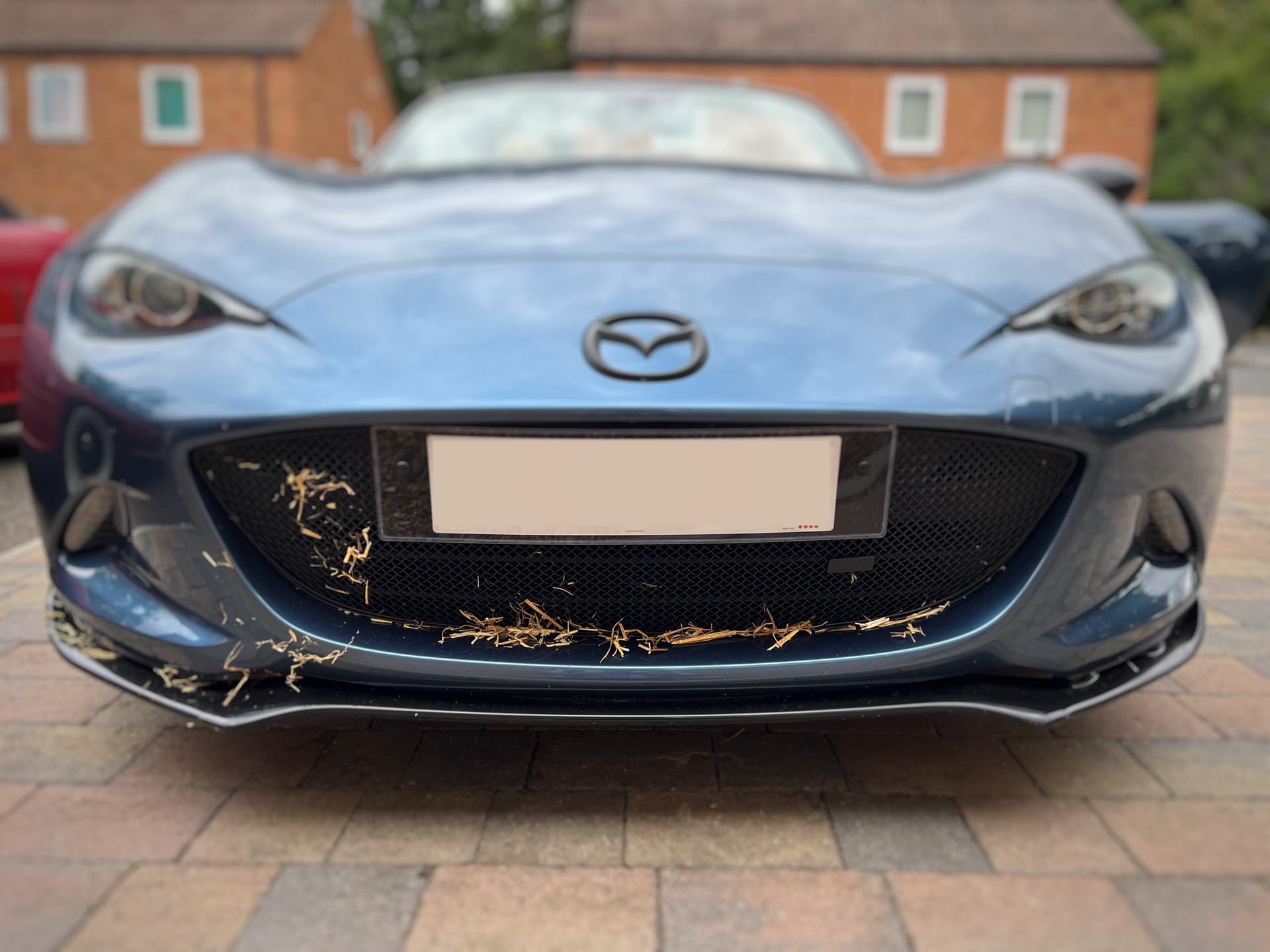

Sorry about the state of the roof - local fields being cut and followed a massive hay wagon along the back roads and it was losing hay under every low-hanging tree branch!
