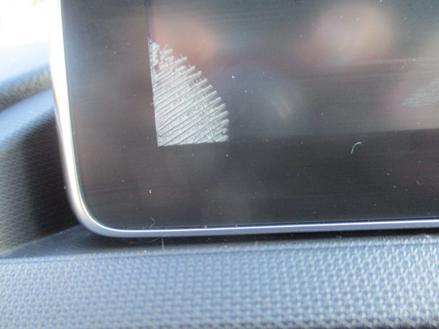

Am looking to buy an ND1 in the coming weeks and I’ve noticed a few of the cars for sale have what look like cracks in the corners of the infotainment screen.
I wondered if this is a known issue? If so, are there ways to fix it (other than the obvious of replacing the entire unit!)?
An example is below. This one looks particularly bad. Does the issue worsen as time goes on?
Thanks for your help.
Has the transit plastic screen protection been left on? Should have been removed at the P.D.I. Just a thought.
Common fault, screens were replaced under warranty. ND2 screen is a higher resolution so some upgrade to that. If you’re buying from a dealer get them to replace it first.
No, it looks like it is in the screen. And as paddyman points out, seems to be a known issue.

Common issue where the screen layers delaminate, usually caused with cars that are left outside and therefore are subjected to temperature changes. The ND2 screen isn’t a higher resolution, but is a better contrast, i recently changed mine to one and on selling on the old screen and Mazda 2 CMU the upgrade only cost me around £10.
I believe it is possible to just replace the glass, but i’m not sure how easy/difficult it is to get hold of the parts or at what cost. IIRC i think dealers were offering the parts for sale as a means to resolve the issue.

There is an ND1 screen on eBay at the moment for sale that could be used to replace a faulty screen, I know the guy selling it as he did the same thing I did and used a newer Mazda 2 screen to upgrade the ND1 screen. But ultimately, if you can do the same and get hold of a newer screen out of an ND2 or Mazda 2 that’s the better thing to do.

My screen has recently suffered from ‘spider cracking’, will it spread!
