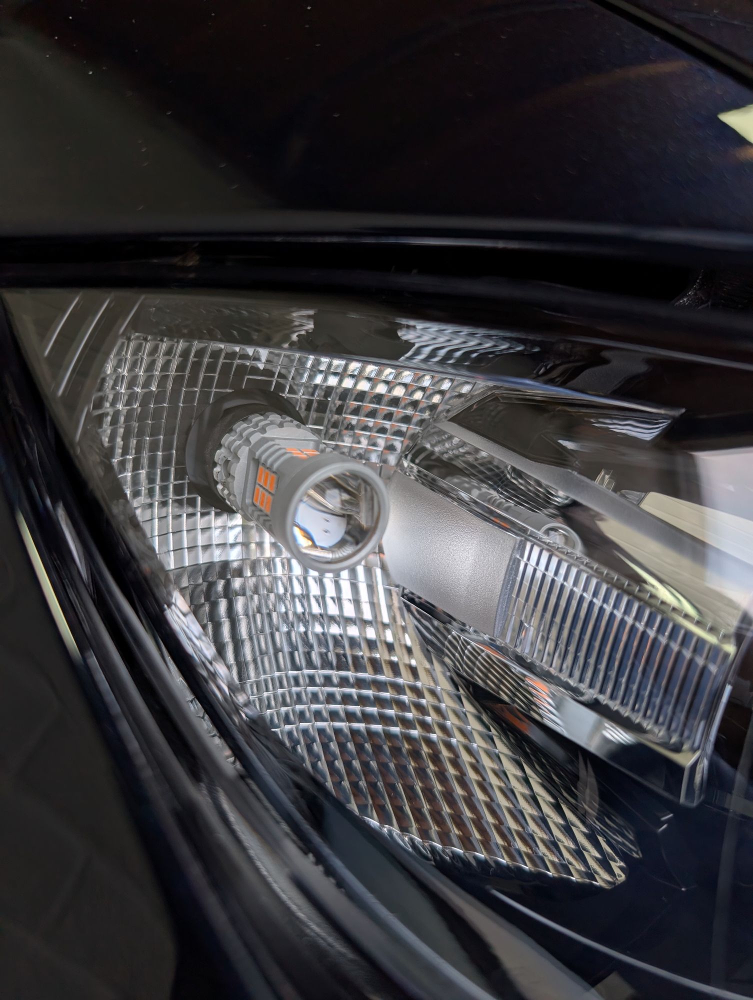

I saw these advertised which promised “no hyperflash” so got some.
It was too sunny to photograph working, but these are at least twice as bright as other LED bulbs and probably three times as bright as the standard bulb.
They illuminate immediately (no warmup time) and NO hyperflash.  No need for extra resistors, a straight swap-over of bulbs.

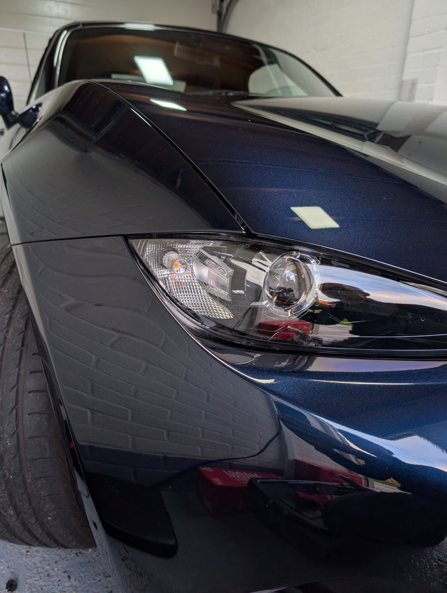

Hi, I would like to do this on the front and back on my ND. How easy is it? Thanks.
Fronts fairly easy, you have to loosen the wheel arch liner and get your hand up into the space behind the headlight. Awkward but not difficult. The rears are another matter. The light units have to be taken out to get to the bulbs. Pain and risks paint damage. There are instructions on the Web and they should be followed carefully.

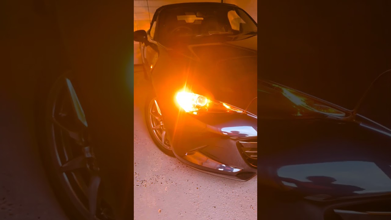

Holy moly, I’ve just fitted these to my NC rears. No problems with fitting, and no hyper flash. But … boy are they bright! I’m not sure if they’re not too bright. I can hardly look directly at them at night. I’m not sure I’d want to be behind a car with these fitted. Anyone else got experience with these? What are your thoughts?
I did say they were bright . . . . :star2: :bulb: :grinning:
:smile: They sure are! They do look cool though. I think I’ll stick with them and see if I get any complaints :smile:

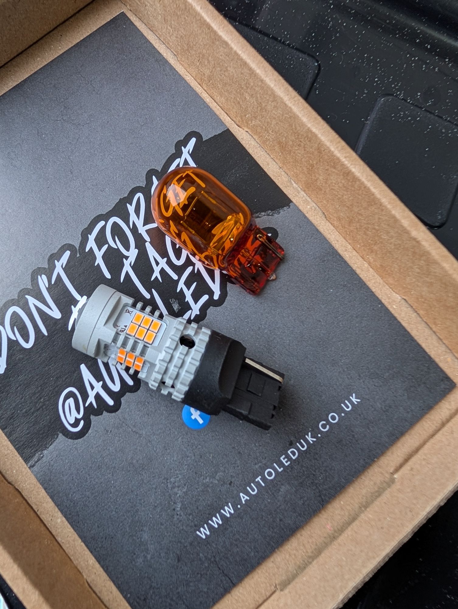

I contacted AutoledUK (no affiliation) a couple of weeks ago to see if the indicator bulbs would work without hyperflashing and they said the LED version they do has the most resistance on the market, so i gave them a try.
Aluminium body, torch like magnification on the end and silver in colour to blend a little better.
they work perfectly and are so fkin bright I couldn’t do the other side for a while as I had dots in my eyes!!
Have you got LED rears as well? The only reason I am asking is I have and when I installed LED front indicator bulbs I got the dreaded hyperflash. I had to put the originals back in to calm it down
The other thing I noticed was when I fitted the LED fronts they were very yellow rather than a good ole orange look noted at the small wing indicators.
