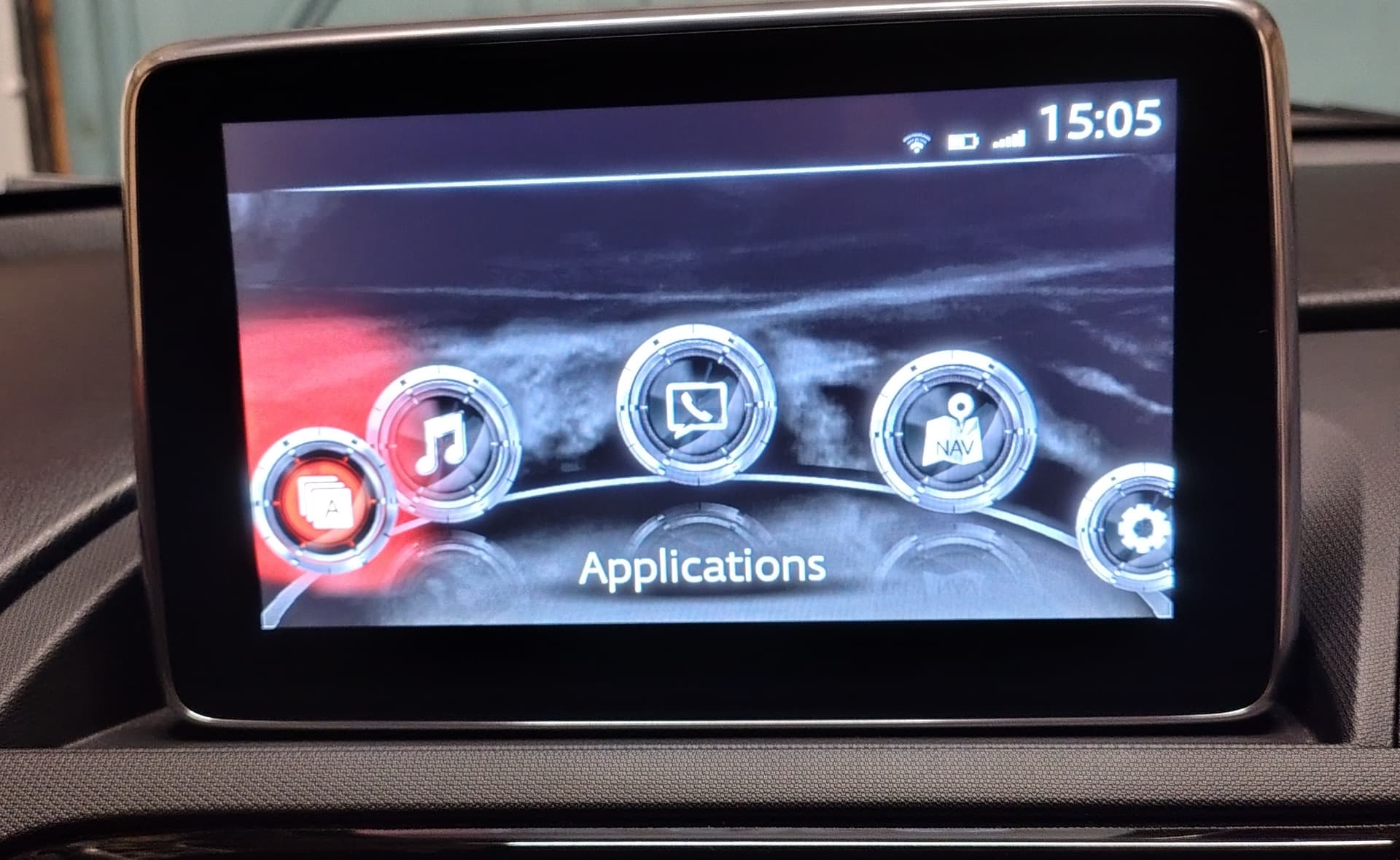

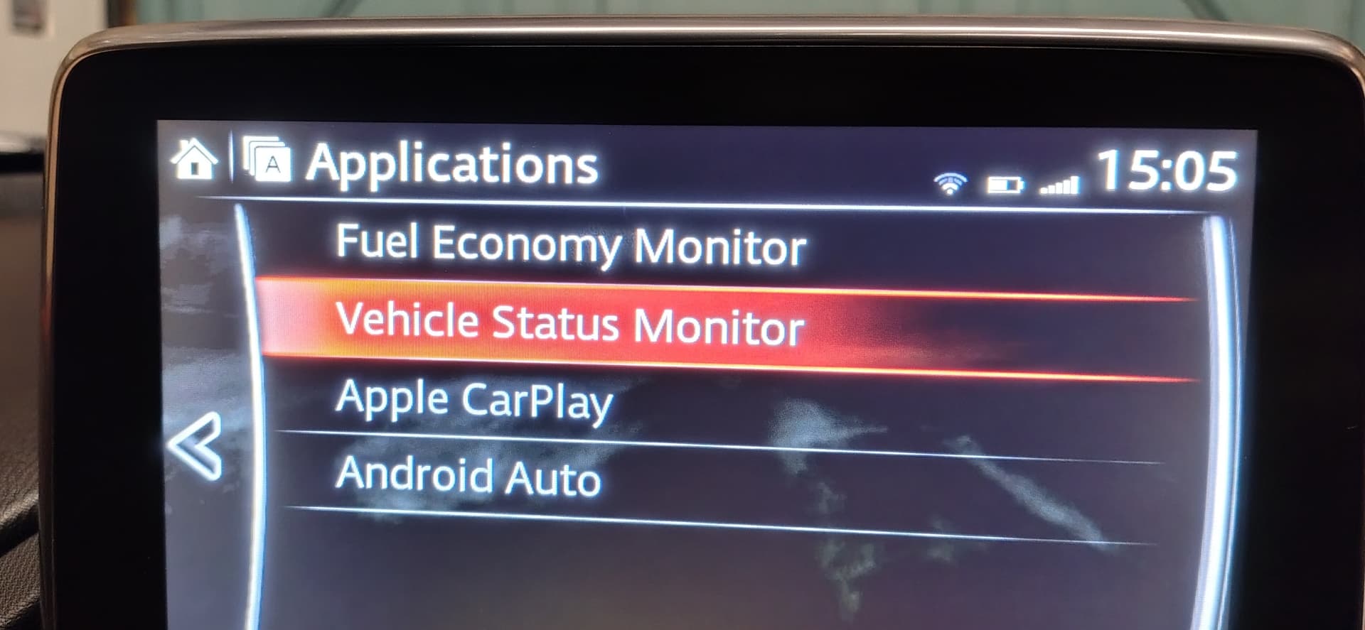

Hit the applications button on the display, then the vehicle status monitor menu. That’ll bring up the oil change monitor/miles etc. You can adjust it reset yourself in the display
