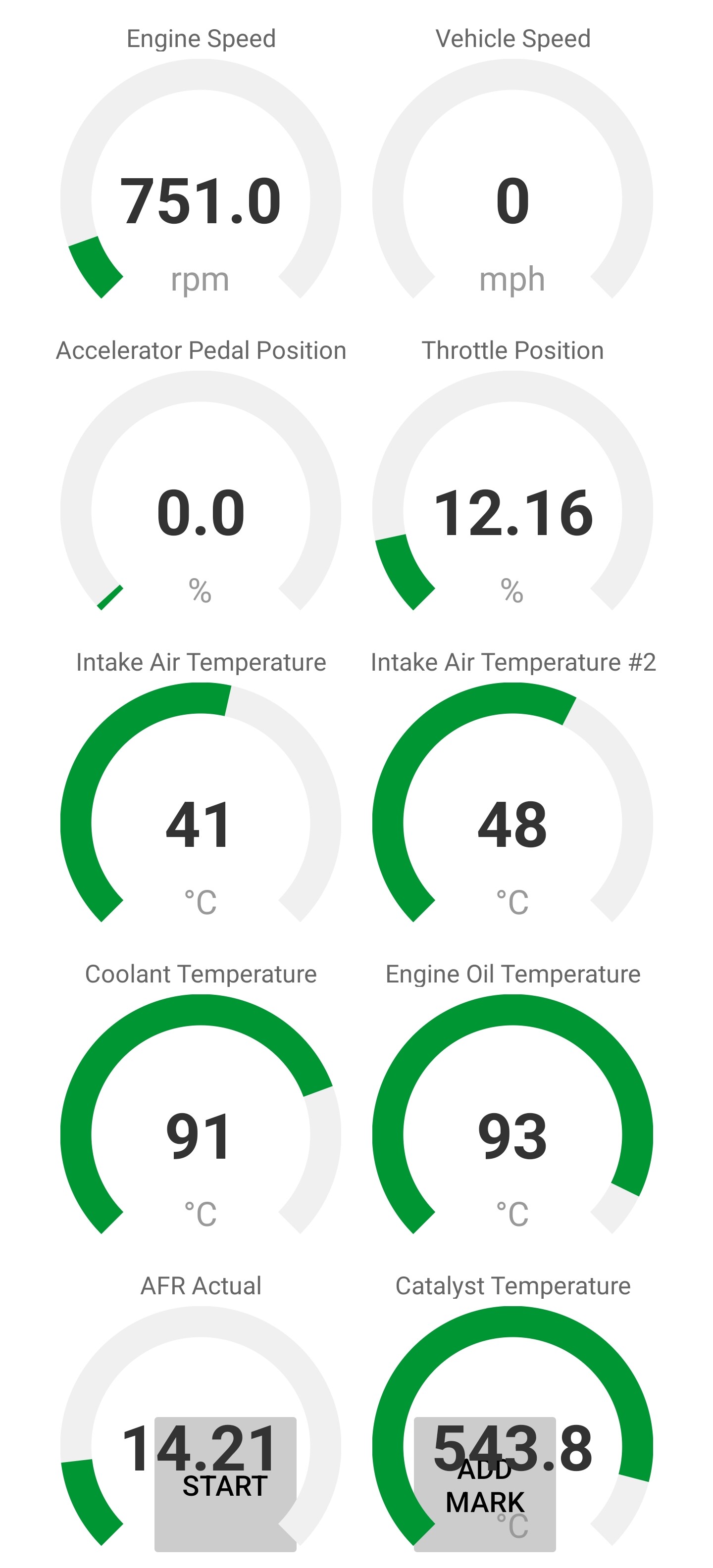

There is no gauge of course but you can access the extrapolated reading via ecu software.

I use Ecuteks ECU Connect to connect via Bluetooth to my mobile device.

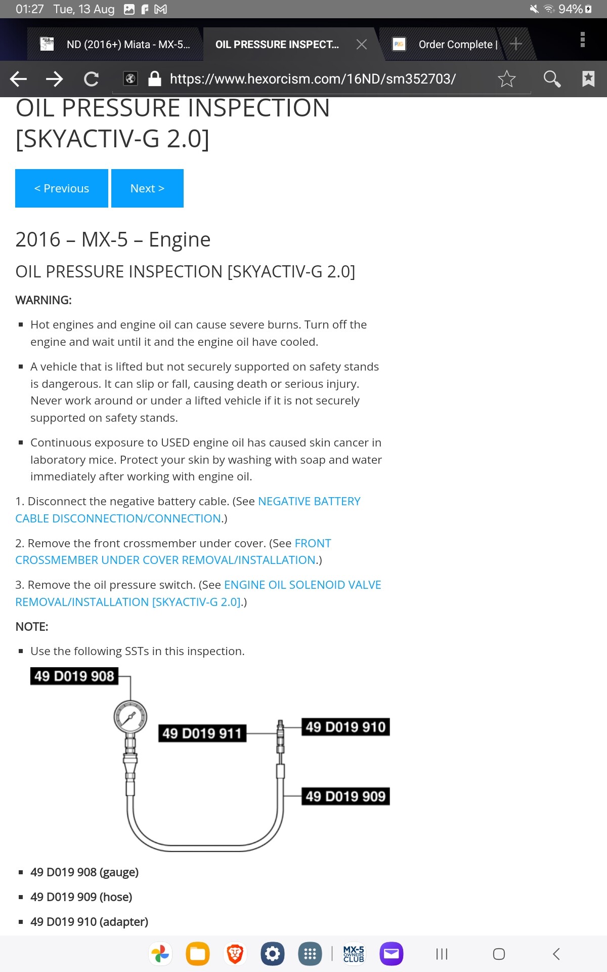

According to the manual there is only the oil pressure switch which has to be removed to check the oil pressure operation
That confirms that then, thanks. After checking, oil pressure sensors are fitted to SKY engines with variable displacement oil pumps.
