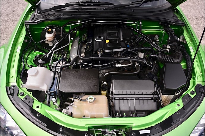

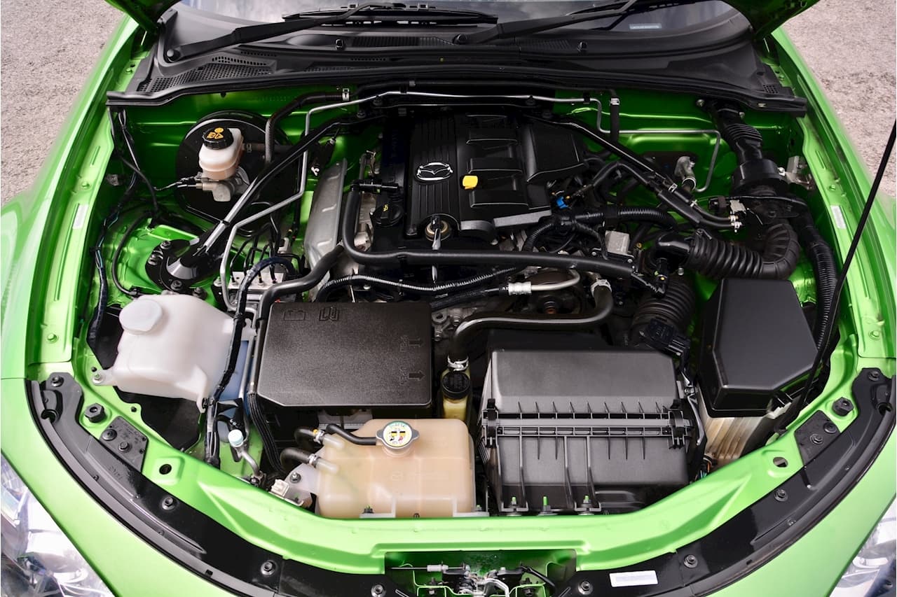

Can’t be sure if they did things differently on the ND or not. I’m not seeing any holograms under the bonnet anywhere.

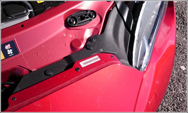

There should be one on the underside of the bonnet, one near the passenger headlight, both door edges, two in both door jambs, and underside of bootlid

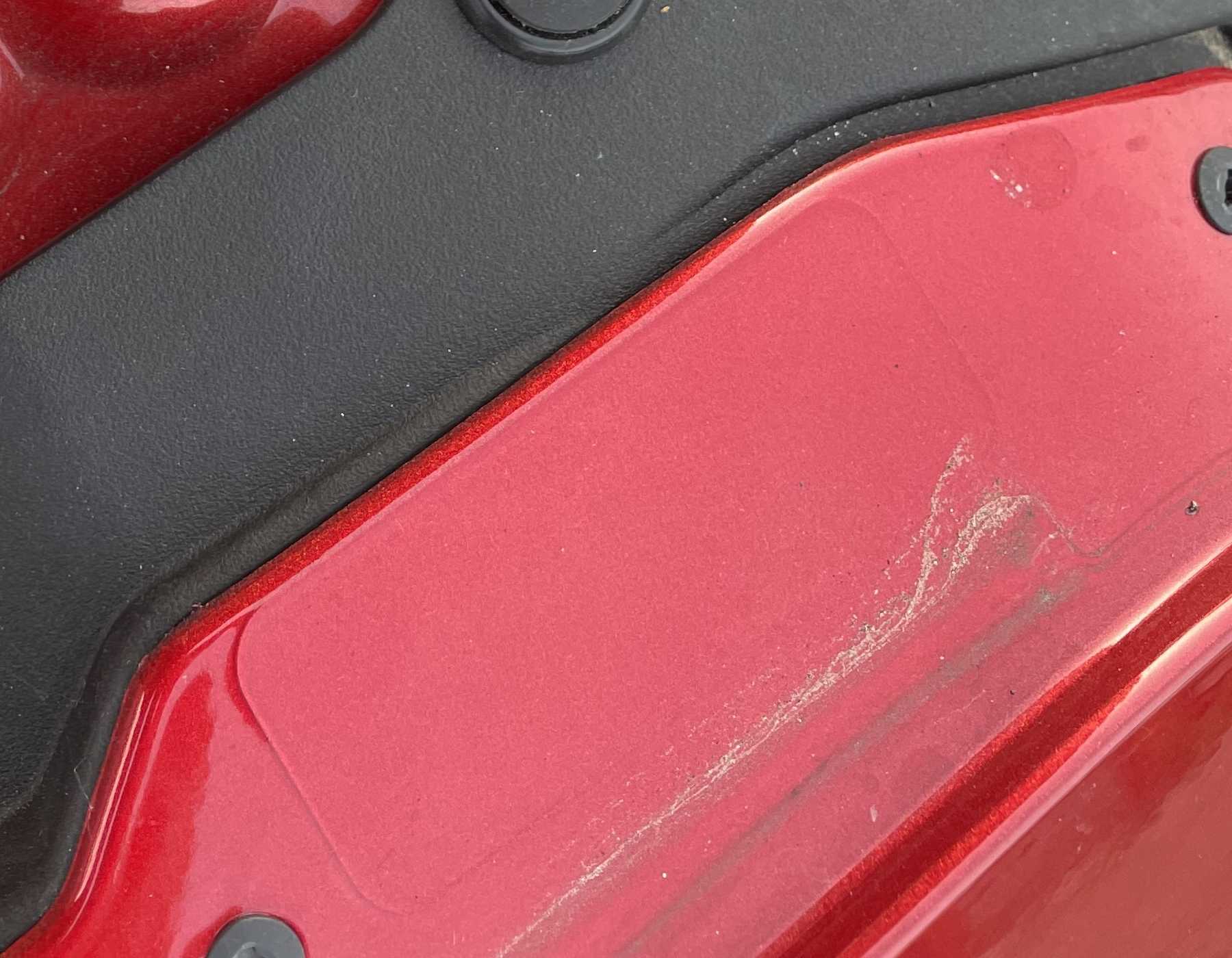

A VIN sticker on the front bumper has been painted over, The outline is visible in this detail from your photo.
Possibly repaired after it’s had the bonnet activators blow?
