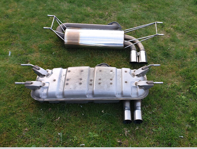

I have the one for my 2.0 2019 back box going free if you want to pick it up it up from rugby its only done 1005 miles :wink: The one on the piece of carpet…..

I’m fairly certain it’s the same part, between 1.5 and 2.0 models.

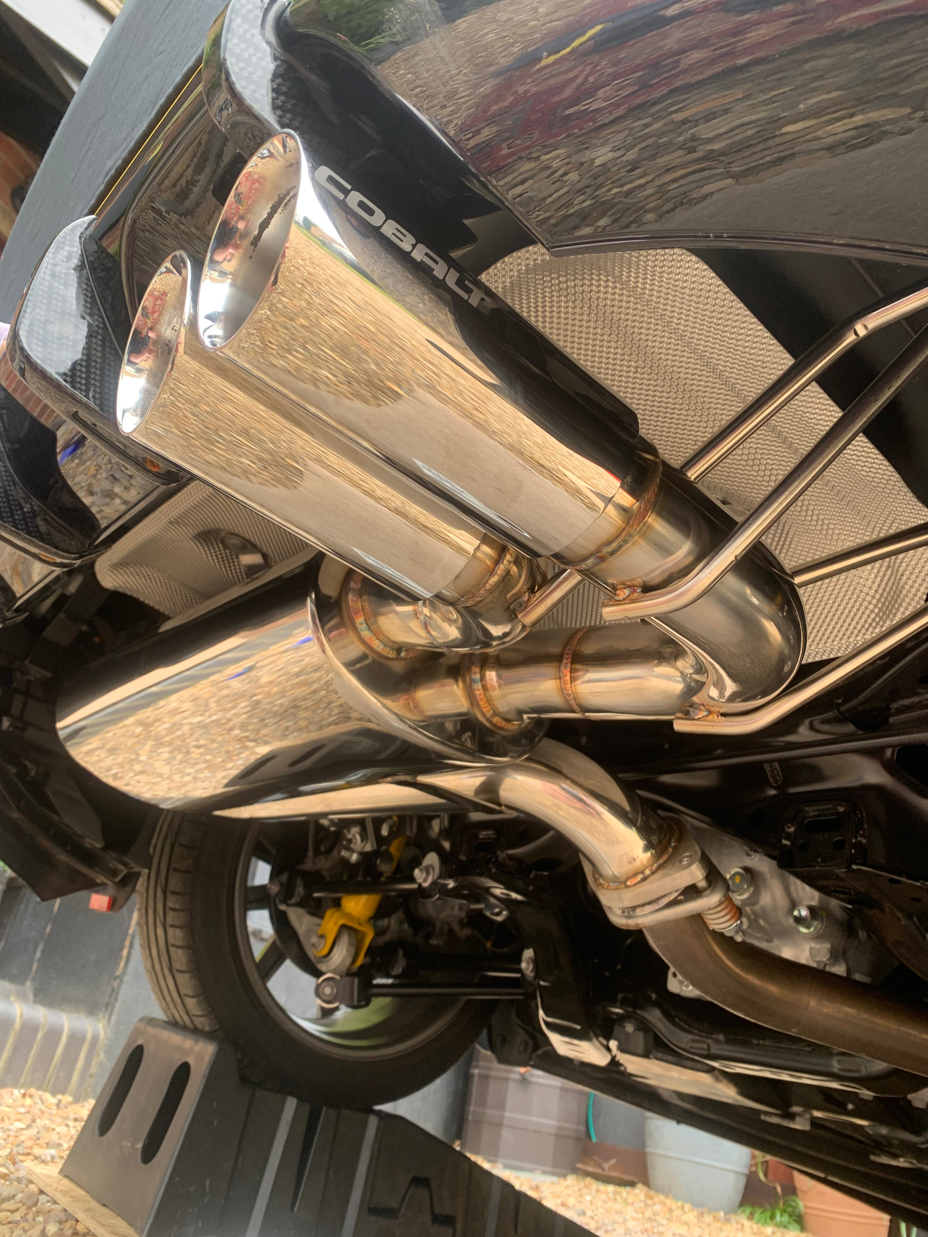

Cobalt is quite nice.
I’m going to list a Good-Win Super Street single tip soon though it will be about the same price used as a Cobalt new.

The cobalt back box looks like a popular upgrade. I haven’t read of any weight saving or performance increase only a more sporty sound.am I correct in this analysis and is the exhaust sound better?
Better is subjective, but it sounds sportier and people seem to be happy with them. There aren’t many if any back boxes that genuinely add performance without the rest of the exhaust being changed too and a remap. Just go with one that looks and sounds nice.
