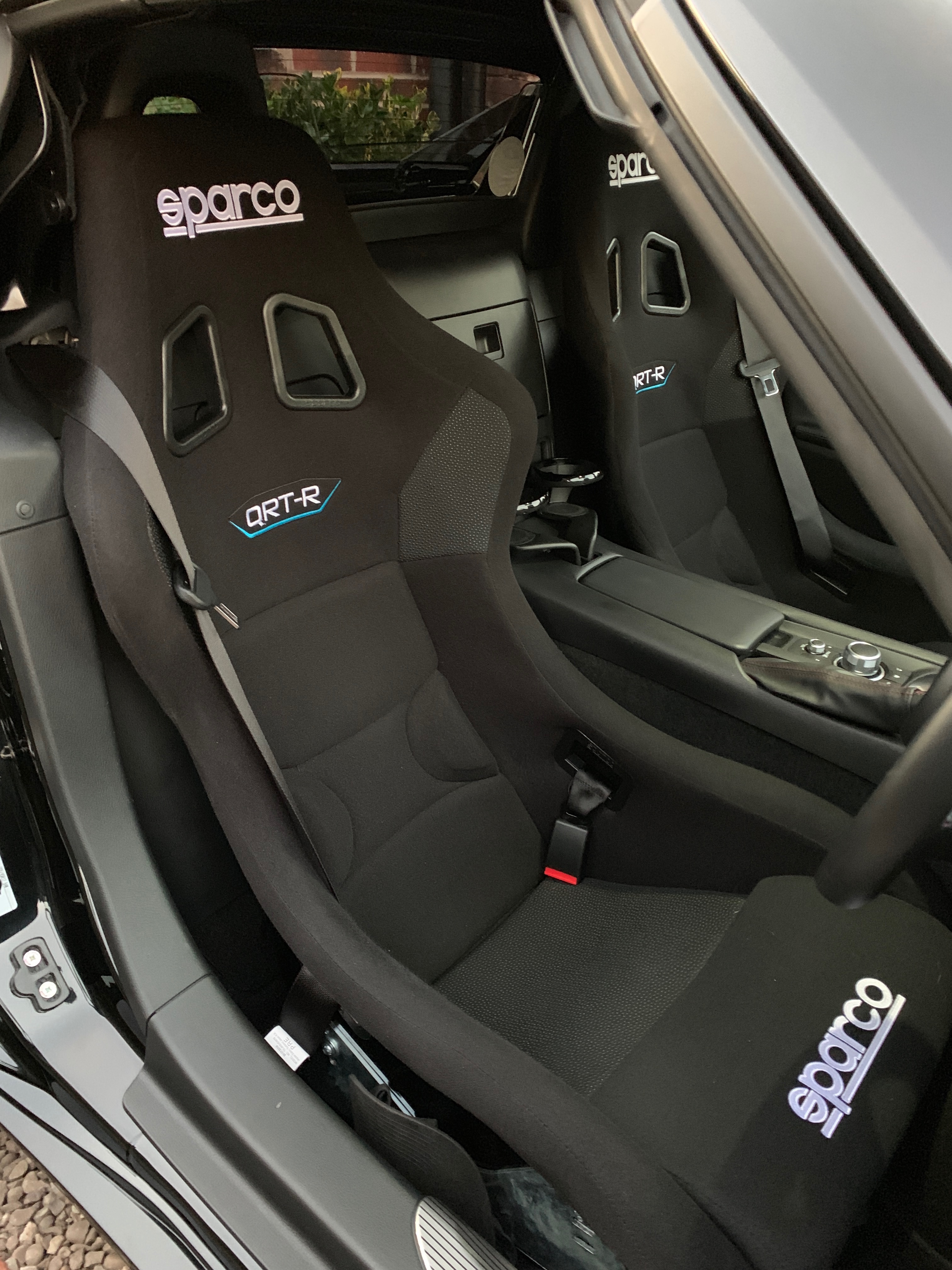

Seat fixing certainly look the identical to me ND1 to ND2… I had an ND2 RF which I changed the seats in (fitted buckets) and have more recently built an ND1 race car, so I’m fairly familiar with swapping seats around in an ND.
I can double check next time I’m at the unit with the race car as I had some mounts fabricated to fit the buckets in the ND2, these were a little heavy for the race car tho so I used something different.
