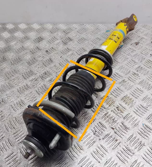

It’s a sleeve essentially that sits at the top of the dampener, to help prevent dirt getting in. So they can be replaced separately.
Here’s a quick reference photo of a Mk4/ND Bilstein unit, with the cover highlighted:

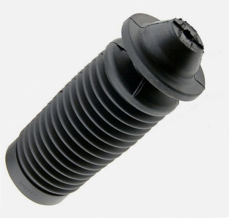

And an example spare part:

The shocks need to come out to replace the dust covers. A lot of labour for a cheap part. If it’s only an advisory item, I’d be leaving it until any bigger jobs were needing done then have the work done then.
