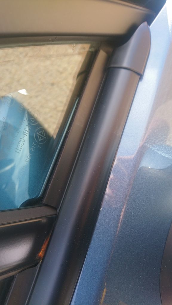

My ND is 8 months old and has rust at the bottom of the little side window pillar. Quite a common thing apparently, has anyone had it fixed by Mazda yet?

Sorry for the terrible picture but I couldn’t see the phone screen in the sun. This is the drivers side (RHS) though there are reports of it occurring both sides.

That picture has nothing removed, as far as I can tell it is the vertical trim strip that has the rust from where it is rubbing on the horizontal part.
Wow!  Nasty!  No mine has nothing at all!
Yep. Mine is showing signs of it on the drivers side.  It is the rubber window seal which has rubbed through the (thin) paint on the vertical window guide

Exactly the same happens on the NC. Mazda replacement has a plastic piece to stop it happening again, quite a few posts on this forum about the NC problem. Can’t understand why this hasn’t been done on the ND.
Mazda Service information. RO2/17 April 13/4/2017
( Corrosion on front Door Quarter Glass Guide at where it contacts the Beltline Moulding, )
Your Dealer should replace under warranty

My NC has this on both sides, mainly bottom of the pillar but a small amount at the top as well.
I’ve used some Hammerite Rust Removing Gel on it. Has done a fairly decent job, but not perfect.
I Repaired mine on my NC, stripped them out of the car completely, stripped, repainted and then applied black vinyl wrap over the area where the weather strip rubs about 1-2 inches, mostly hidden inside the door where you can’t see it.
Seems to be fine now.
