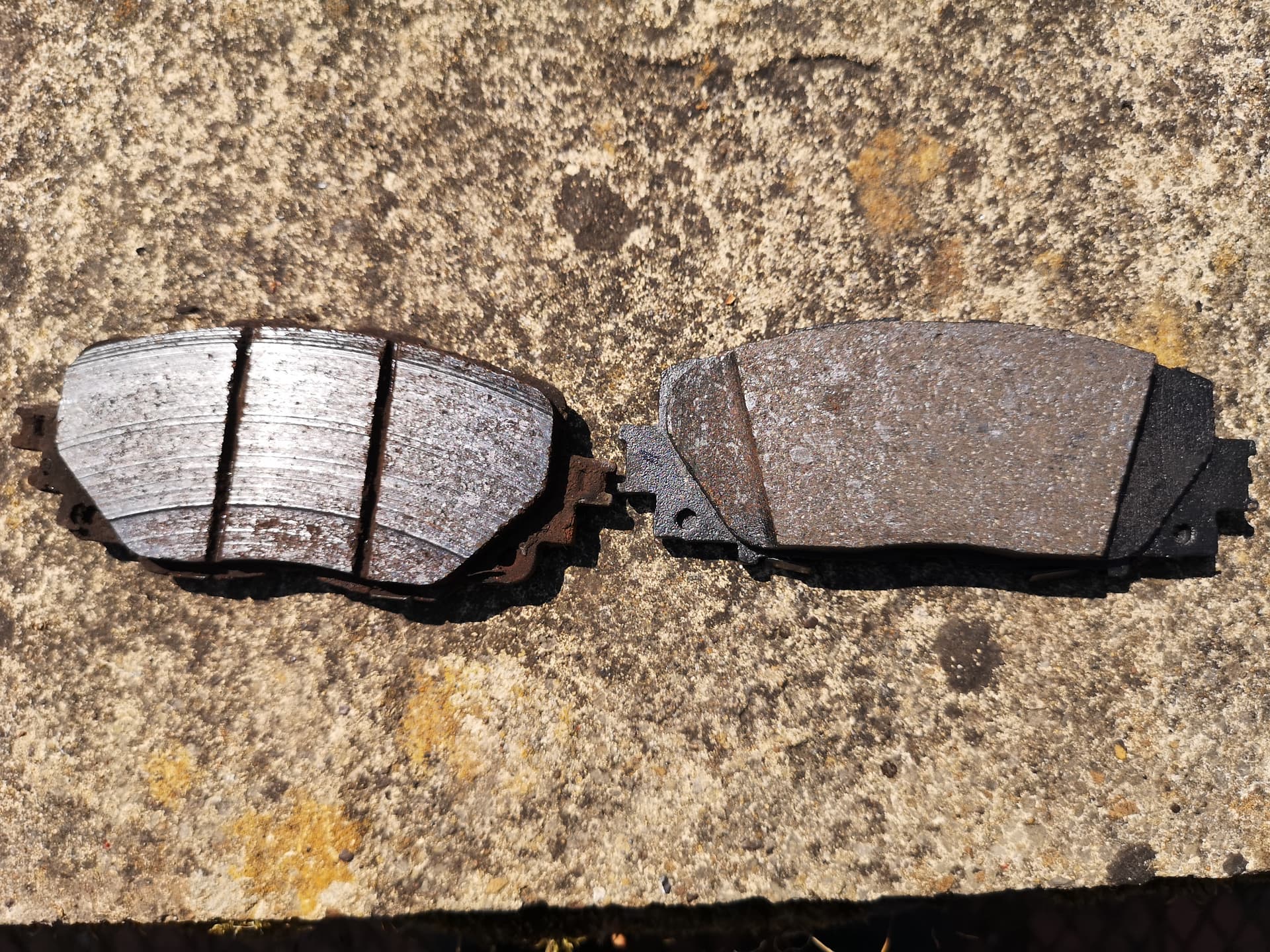

Went to change the front brakes today with Brembo disks and pads for “non performance brakes” and the pads are totally different and won’t fit the caliper bracket. They only list 2 types of front pads - one fit Advics and one for Brembo. I’ve got the Advics ones according to the Brembo brakebook which eurocarparts list as the non performance ones. So, do standard Sportnavs have Brembo brakes?

Thanks for the pages - that’s the manual I’ve been using and it is excellent. It’s definitely the single piston set-up and the pads are listed by Brembo as for the ND but as you can see the lug is significantly wider on the new pad and the friction area significantly smaller in both directions - doesn’t show well in the pic but the new pad has a step at each end
This Brake Pads | Front & Rear Car Brake Pads | Euro Car Parts for the 2.0l shows what look like your pads.
That’s them I reckon. Have ordered them from Halfords delivered at £35 for delivery tomorrow against £60 at eurocarparts. Can’t understand why they are so expensive these days. Halfords even undercut them recently by 50% for Qashqai disks and pads.
