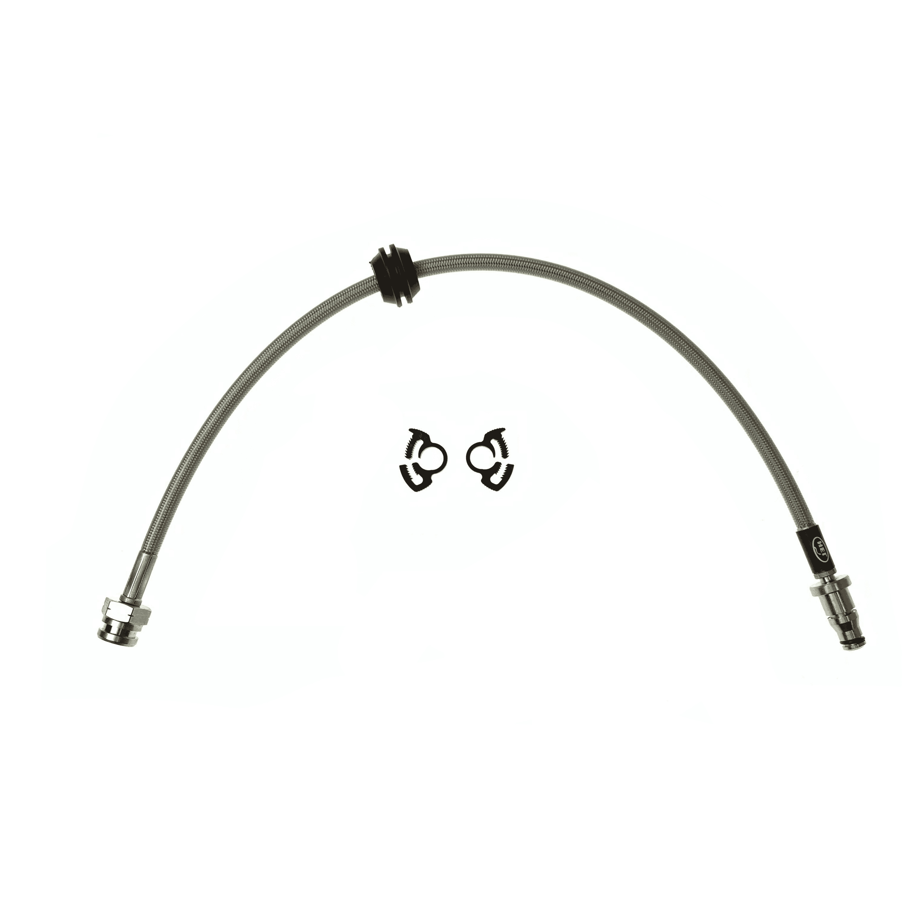

Looking at fitting a HEL stainless braided clutch line whilst doing brake lines. Has anyone done this, and tips or guides? Not found anything specific to the ND but guessing other N* models are similar.
I have the Hel clutch hose and did look to fitting it last year but although easy to change the clutch slave end the other end is in a hard to reach position above the gearbox and I couldn’t quite get to it. Something I’ll have to do the next time I do brake bleed.
Yes I could see that end being tricky. Have seen people replace it with the gearbox out, but not seen any guides when the box is Insitu.
