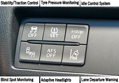

You haven’t inadvertently switched them off have you? My Mazda 6 has those and there’s a button called ‘AFS’ to switch them off/on.

Do you not have the AFS switch in the little panel of six switches to the right side of the steering column
Nope. Mine only has the “Lane Departure Warning”, “Tyre Pressure Monitor Reset” and “Stability/Traction Control”. The AFS is accessed by the Mazda Connect system. I have checked that it was switched on, which it was and I have switched it “Off” and also “Reset” all the Light system controls to “Factory Settings” and none of these made any difference. I will see what the dealer says next week and report back. Thanks for all your advice.

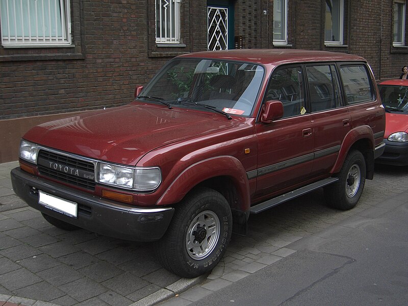

I have driven cars with steering related headlights - not overly impressed with any benefits that I could see however my HDJ80 Land Cruiser (sorely missed) had three front lights. A dip beam a high beam and an outer corner light that illuminated each side when indicating with headlights on, superb and simple - especially when trying to find an entrance in the dark. Image below wasn’t my vehicle.
