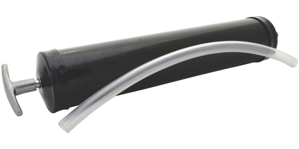

When I went to buy one I found this instead Laser Multi Purpose Mini Pump | Halfords UK which is (a) cheaper and (b) holds more than 200cc so doesn’t have to be filled ten times when filling the box.
I’m sharing this because it seems to be the perfect tool for the job. Clean, trivially easy to use, gets the oil in quickly without having to heat it first, the hooked end fits easily into the gearbox and diff fill-holes and there is ample space to operate the plunger. Both jobs were a breeze using this pump.

I just wanted to second this recommendation. I bought two of the linked Laser pumps off the back of this post and was pleasantly surprised at how quick, easy and clean they made the gearbox and diff oil changes compared to syringes or, god forbid, trying to funnel them in!

To keep this current, the Sealey TP6804 Multi Purpose Mini Pumpappears to be the same item. It holds a litre and works fine. It was a couple of quid cheaper on Amazon when I bought it.
I don’t know if it’s suitable for a ND, but the 500 cc Hilka Pro-Craft oil suction gun works a treat on my NB, and at £10 from Screwfix is an absolute steal.
