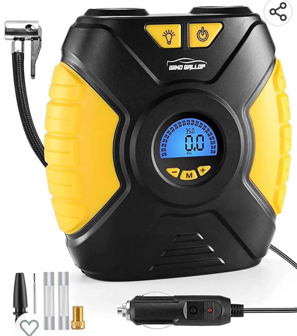

I carry a small battery inflator which includes a tyre guage in my car. It comes in handy on group drives if anyone needs a quick check.
Also you have to reset the monitor esch time you pump up the tyres. Which I didnt know until soneone told me.
This is tge one I have.
