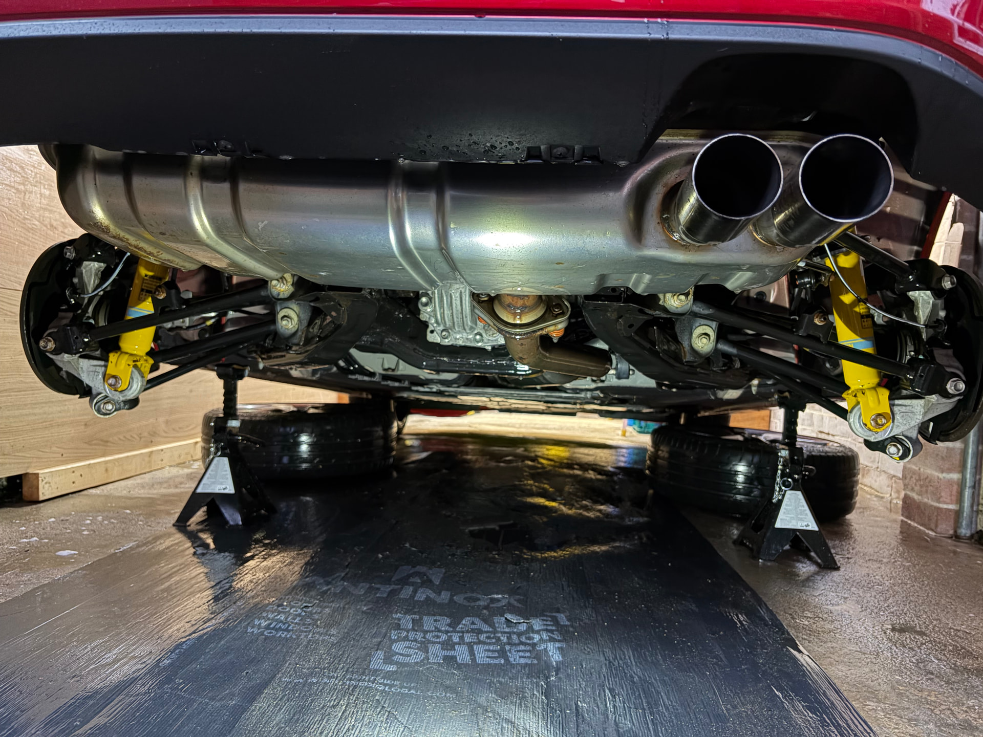

I’m doing some underseal on my ND at home.
I’m planning on using Bilt Hamber Dynax UB, UC and S-50. I had a look at this cool post from a while ago.

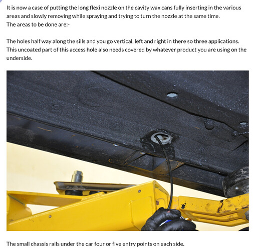

What’s the best way to inject S-50 into the sills? Do you remove the lower cavity bung? Or do you remove the door sill plate and inject from above? Does the door sill plate just pull off?
Any other tips? Ta
I will download and re-link the pics at some point, we did the sills from underneath through the bung holes.

You are best using a compressor. You NEED to remove all four wheel arch liners and the liners in the boot. Remove as many bungs as you can see.
Then you inject your chosen product through every crevice and hole you can see using a long ‘wand’.
Be prepared to get very messy.
