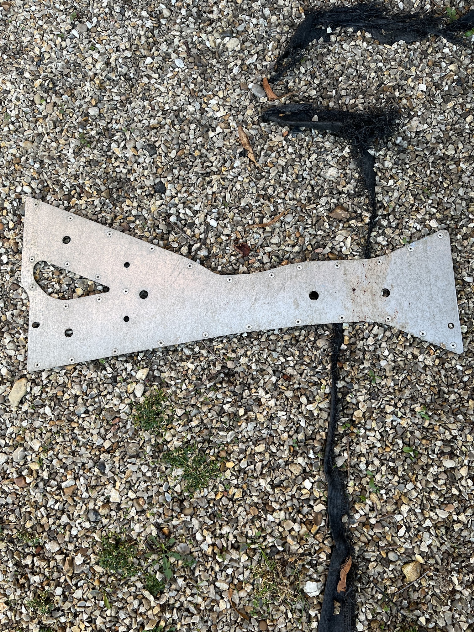

Hi all. Is anybody able to identify this part?
Sadly on a recent drive I was unable to dodge the remains of a deer and some of it hit the underside of the car and took off this piece. It’s very thin metal and appears to sit a bit behind the front wheels. I’ve not been able to get properly underneath the car yet but it didn’t appear to be covering anything particularly fragile.
Any help greatly appreciated.

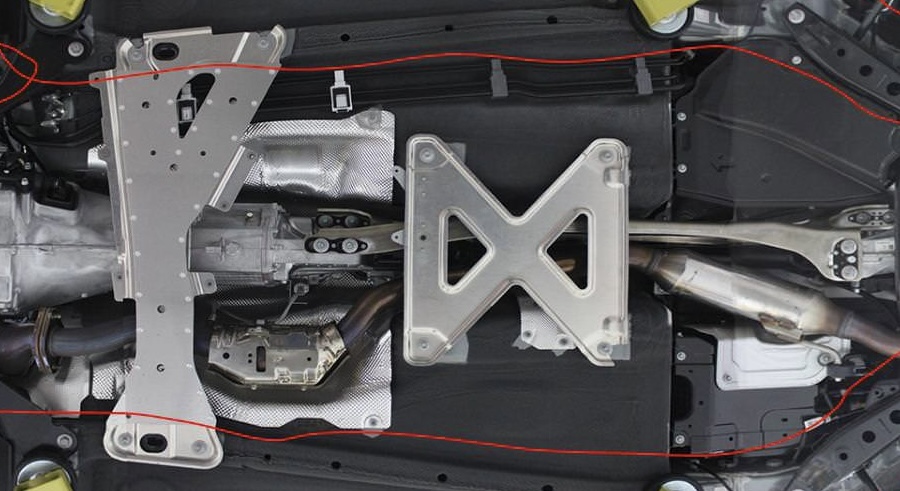

Looks like some of the metal from the centre brace, nothing to worry about in terms of driving the car, but it should obviously be there.
Don’t worry mate, that’s an antler that’s been squashed flat!
Replace it with one of these or one from a dealer
Superlight Front Lower Chassis Brace, MX5 Mk4 – MX5 Parts_gaNTc2MTM1NjUwLjE3MjY5NDE2NzE._ga_9YTNRXK1MQMTcyNjk0MTY3MC4xLjEuMTcyNjk0MTY4OC4wLjAuMA…
I just rivetted mine back together as was loosing the spot welds. Not difficult but a lot of rivets.
Left hand brace in the above picture ^
As @BlueAgave said, you can get after market upgraded versions.
Otherwise you are looking for Mazda Part No. N243-56-A9XA:

Amazing. Thank you!
