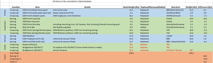

Mazda Weight Loss/Gain
I’ve been doing a few bits on the car since getting it. and i’ve been making a track of all the parts going on and off (except at the gram level, i havent weighed in new bulbs or phone holder for example).
Below is a list of what i’ve changed so far and their weights.
*Note i dont plan for this to be a thread for weight-watching. theres a ‘decent’ list i found on the Miata forum which has various items. but i couldnt find any full lists. certainly not for my mods
for anyones interest: ND component weights - Page 5 - MX-5 Miata Forum
In short summary, after 12 aftermarket parts/items, i am up 5.5lbs in weight total, but have a net loss in unsprung weight :+1:
Single biggest gain was the Eibach front sway bar! that was very heavy.
Single biggest saving was the 6-pot willwood calipers (front).
Weights are accurate with scales typically used for postal items.
*exception being the OEM exhaust - as these i have taken weights from another forum as mine are still on the car :stuck_out_tongue: but the replacements are accurate i can be sure of as self-weighed.
The 6-pot willwood were lighter than expected. like for like (caliper, braided vs rubber hose, and pads) they actually came in just shy of 1.5kg lighter a corner AND that was with my near-death pads :stuck_out_tongue: (advertised was 1.3kg. bonus!)
I was most surprised about the cobalt backbox! it wasnt something i had fitted myself so was amazed how heavy it was. its half the size of the OEM, they must have really crammed in the packaging :slight_smile: , this might need to be a re-visit for me in the future if the decibel track limits are in range. ‘free weight’ to be lost there with the right product.

Interesting! Thanks for sharing. Are you sure the original front sway bar is just four pounds? Amazed at the weight change of the front calipers ( at some considerable cost though)
I recently got an Il Motorsport backbox S/H. I’ve yet to get the original off but have strong hunch it going to not be an upgrade weight wise….
i took the sway numbers from the other forum. only as my OEMs are in a box in the shed. if it sounds like wrong number i’ll go check tomorrow.
by that i mean i WILL go check tomorrow as you have cast doubt in my mind :smiley:
yea the calipers carried a high price tag :expressionless: but, my goal isnt weight loss in general, i just like to record things.

i didnt fit the suspension myself as i had a garage have the fun and hassle of dealing with the old bushings, and then setting ride hide to specs :slight_smile: but… i have since fitted the rear strut bar myself. the room is tight by the rear bulkhead but its just 2 bolts per shock tower. each side has room for a breaker bar on one, and the other needs the ‘double spanner’ extension for the leverage.
also to confirm above… i double checked the weights of the rear and front anti-roll bars - they are indeed correct.
(i had forgotten how silly then the rear is! smaller than my little finger. )
Four pounds is nearly two bags of sugar so that’s actually fine. I think I just found the weight difference between that and the aftermarket item astonishing.
Yes the rear SB is a skinny thing but it doesn’t have to control as much inertia once it starts moving.
Interesting info from the track cars is it’s often left standard or removed when an upgraded front bar is fitted.
I found someone on here is that suggested it’s nice to have a car that doesn’t roll as much but it can make a breakaway more sudden. I can see the physics of that
Also some think the fitting of typical aftermarket coilovers tightens up the car enough to preclude the sway bar upgrade for road use.
Anyways, it’s interesting stuff
Confirmed - Recaro Alloy wheel weights 9.08Kg per alloy
i took it down to the tyre shop today with the garage scales, and asked them to whip off the snow tyre so i could weight it separately.
