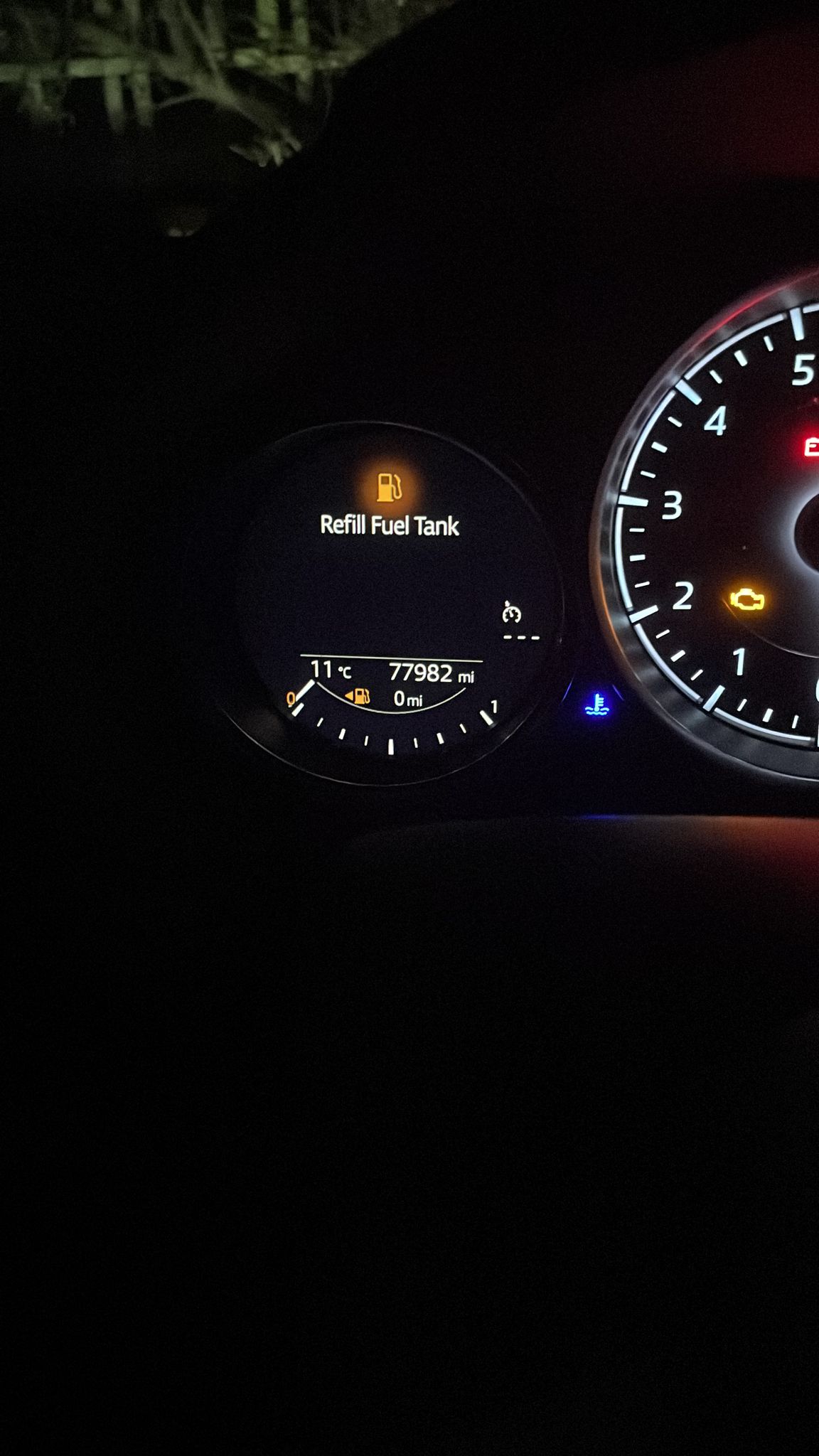

I don’t have any photos of that far but do have these:
And I then filled up with 43.64L, so there was still some space left…
Thankfully I haven’t run it dry and usually only get 39-42L on a refill.

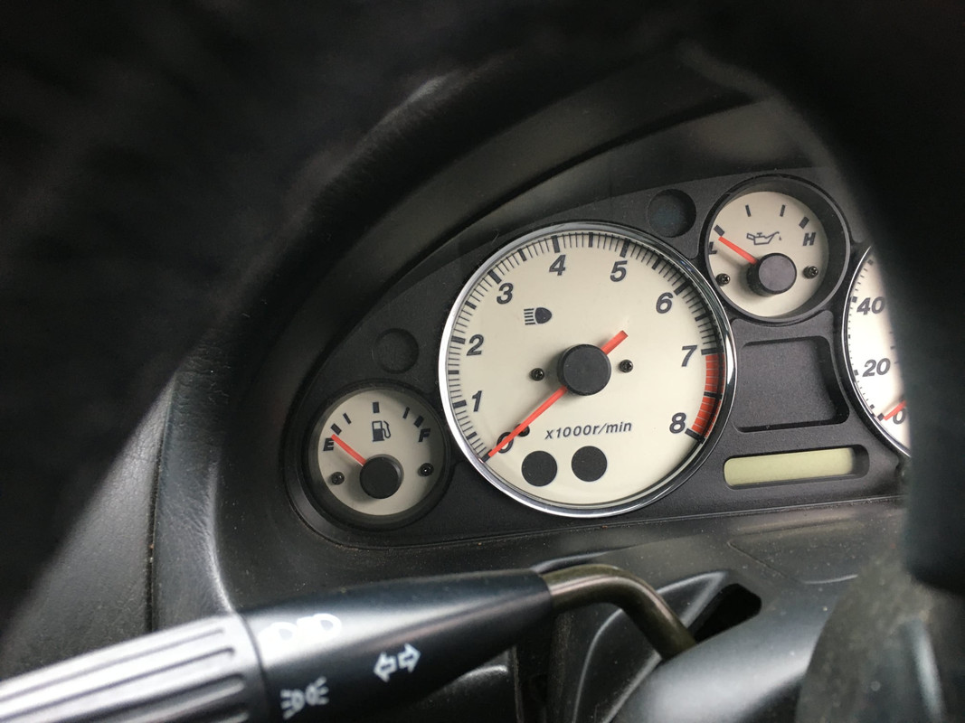

Dearest Madge
A picture paints a thousand words…yep that’s the line just above the ‘E’ that I tell my owner ‘Feed Me Now’ with my Petrol Warning Light
Sounds like our owners have leant by our misbehaviour that we Not Happy Bunnies below this and they should listen to us
