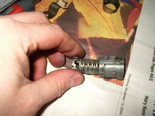

Depending on which model it is, there will be a 5-digit number stamped on one of the door lock barrels. This can be used to order a new key from Mazda, even for imports. See here (before anyone says, I have distorted one of the numbers in this image to stop any low life from ordering keys to fit this lock):
Note; not all cars will have this number. I’ve come across blank castings before; not clear if this change was year or market specific.

Not hard, but you need to remove the door handle, and there is no guarantee the number is there.
To get at the lock you just take the card panel off of the inside of the door and using the correct size socket poked thro the door to unscrew the two nuts that hold the door handle on. you may have to un-clip the horizontal rods to the lock to do this so take a photograph of it first so you know how to put it back again. A good pencil type torch is ideal for you to locate one of the two nuts which is a bit difficult to see.
