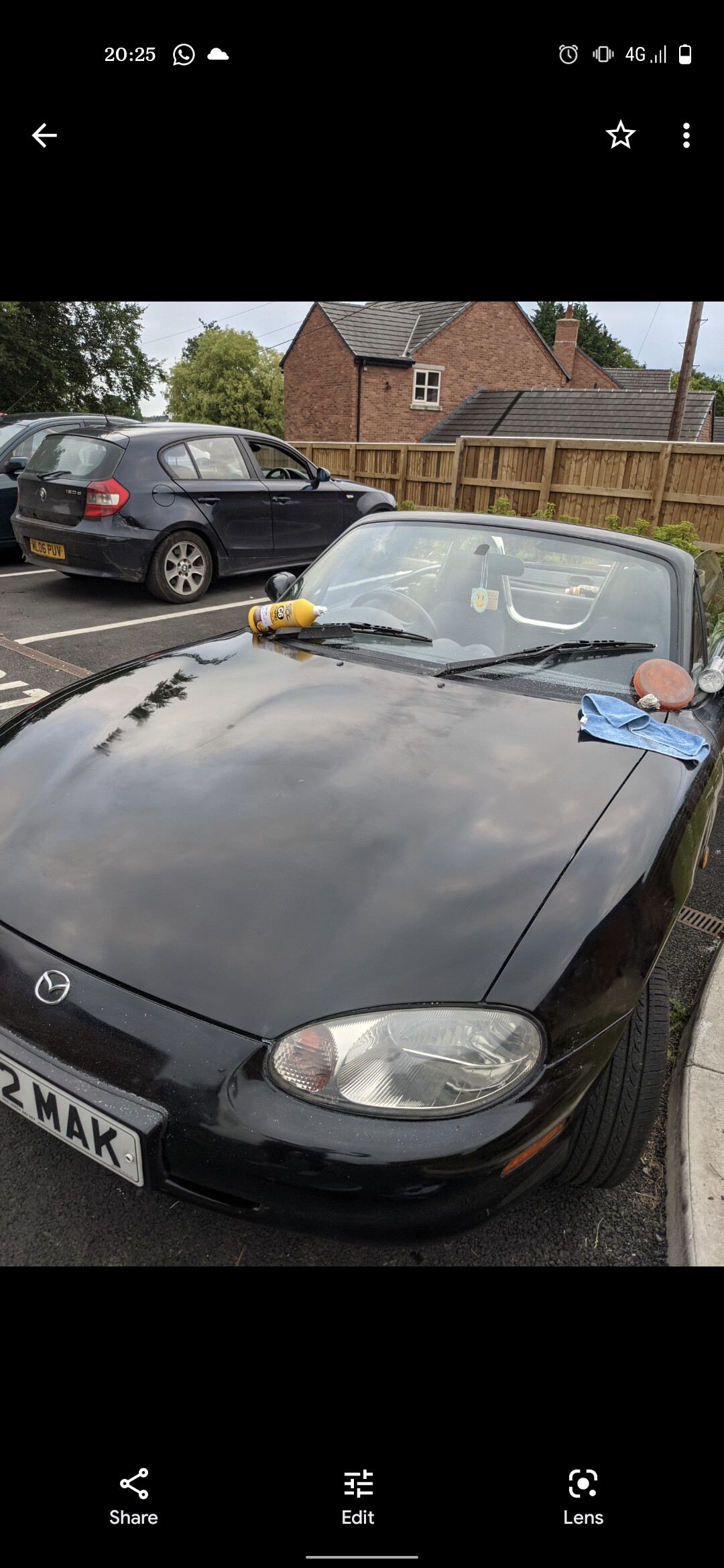

Hello everyone I have a MK 2 I’ve recently brought and looking on getting back to its natural beauty before modding it to my liking, the previous owner looks like he’s either sprayed it for some stupid reason or the paints been sat in the sun, not been looked after and baked! I’ve wet sanded it down and buffed it out which got rid of most of this access stuff that was on the bonnet and on some of the front wings. But it’s not coming back to its natural black! Is there a really good polish that will bring back the natural colour and make it look the way it once was?
Thanks in advance
(If it’s worth just re spraying let me know)

Barrie yeah I’m pretty sure it does, If you look at the pictures before I started to polish it, it looks like the previous owner has possibly started to spray it then given up after like 5 sprays
Yes, I see that, TBH, you’ve done a decent enough job bringing it back from its previous condition

Judging from the black I can see on your pad, and the aggressive polish used on a rotary, if it was clear coated painted (2 stage) you’ve possibly had a strike through onto the base paint so it won’t be further improvable without a respray (or you could try spraying some lacquer yourself from a can but no idea how that would pan out, I’ve never done it). What you have so far is a lot better than how you got it though!
If it’s a 1 pac finish (single stage) then getting colour on the polishing pad is fine, you probably just want a finer polish, ideally something diminishing, to bring out a final finish.
Poorboys Blackhole as recommended by others is suitable for both 1 and 2 stage paint, and leaves a lovely finish by filling in all the defects. However, it is a temporary fix because it’s a glaze, so after a couple of months it will degrade or be washed away, you can top it with a durable wax or sealant to make it last upto around 6 months but then you would need to reapply. Autoglym UDS is a similar boat, it lasts better than Blackhole but UDS cannot be topped by anything to extend that.
