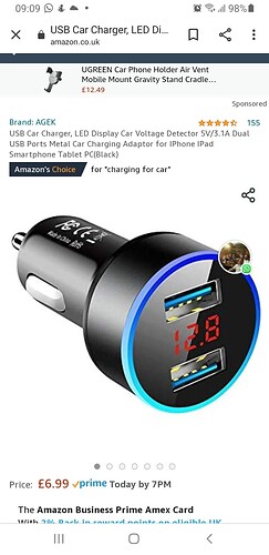

Maybe one of these could help diagnosis the problem
