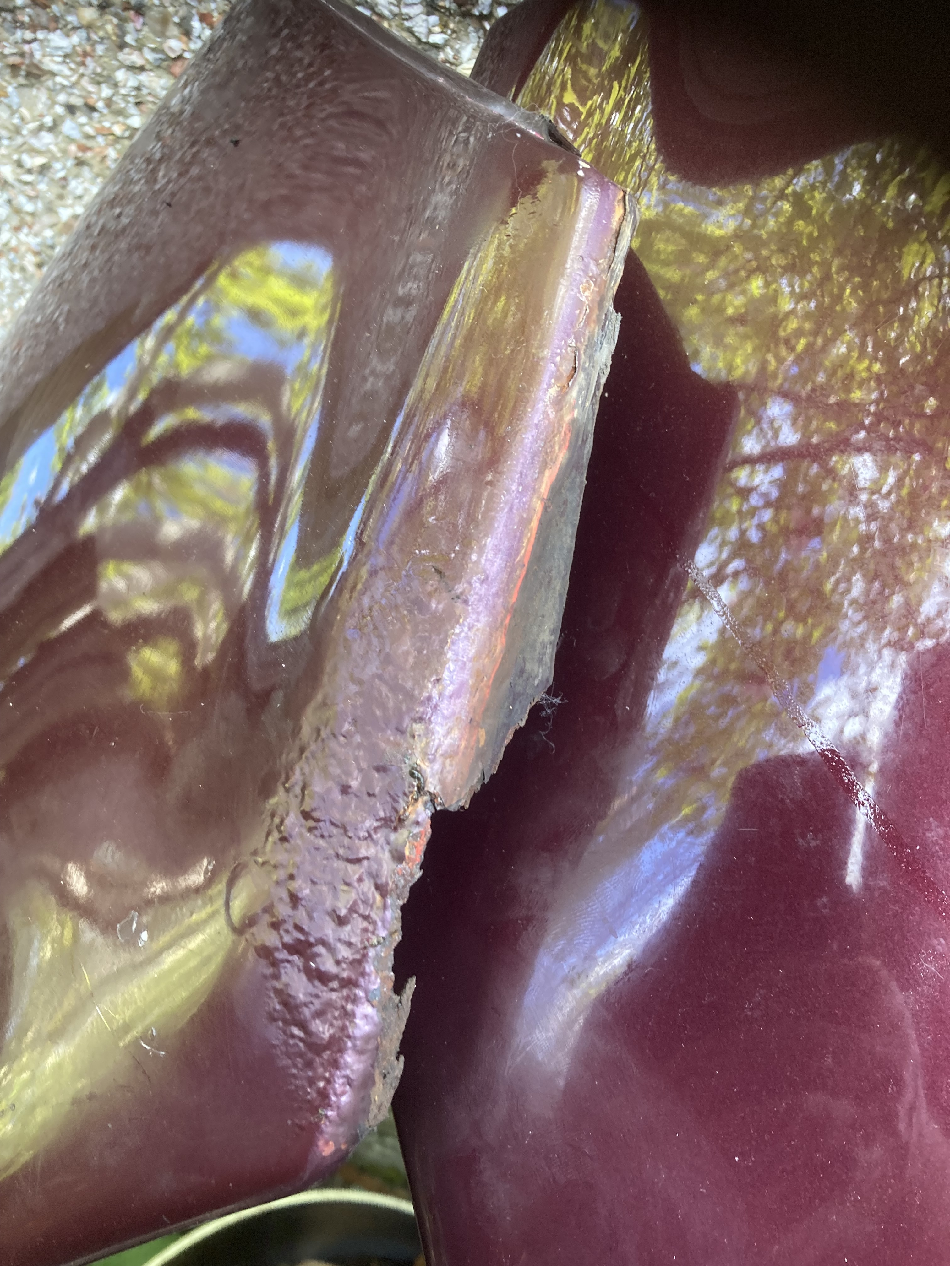

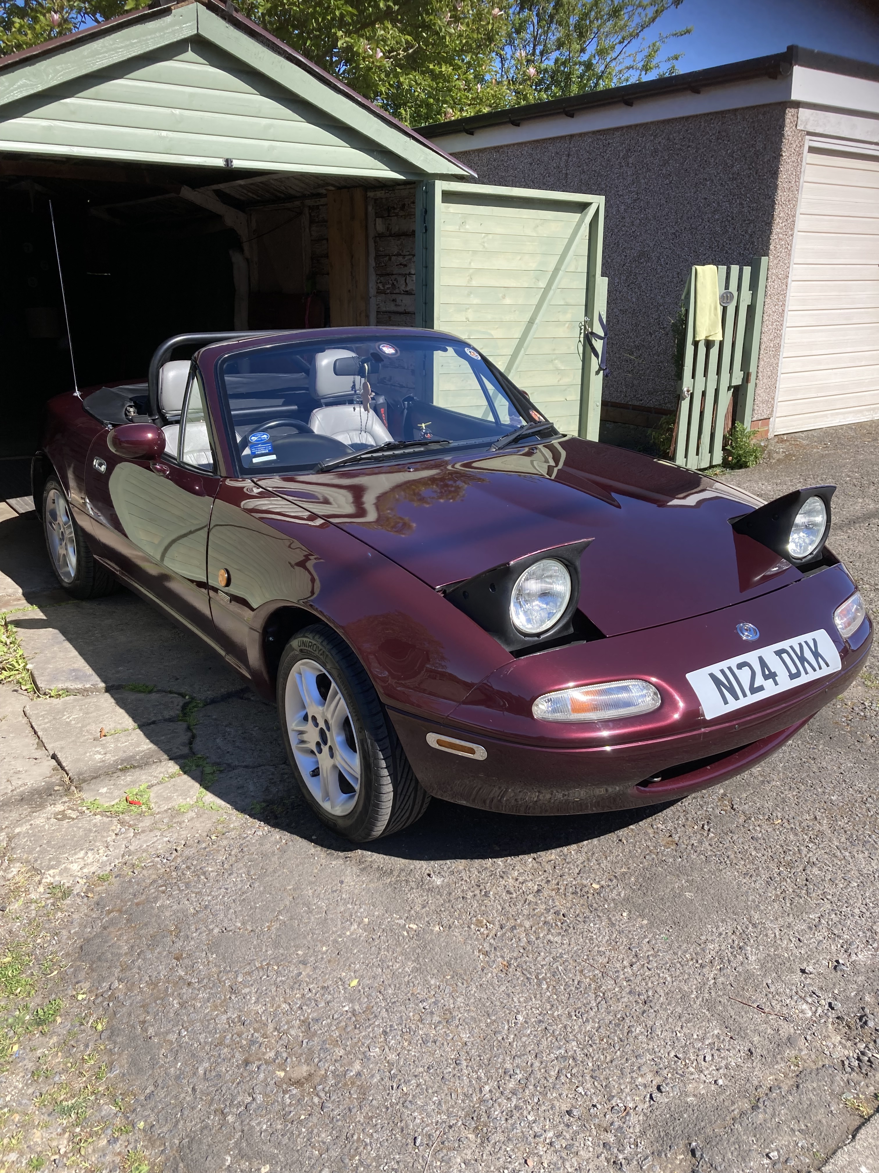

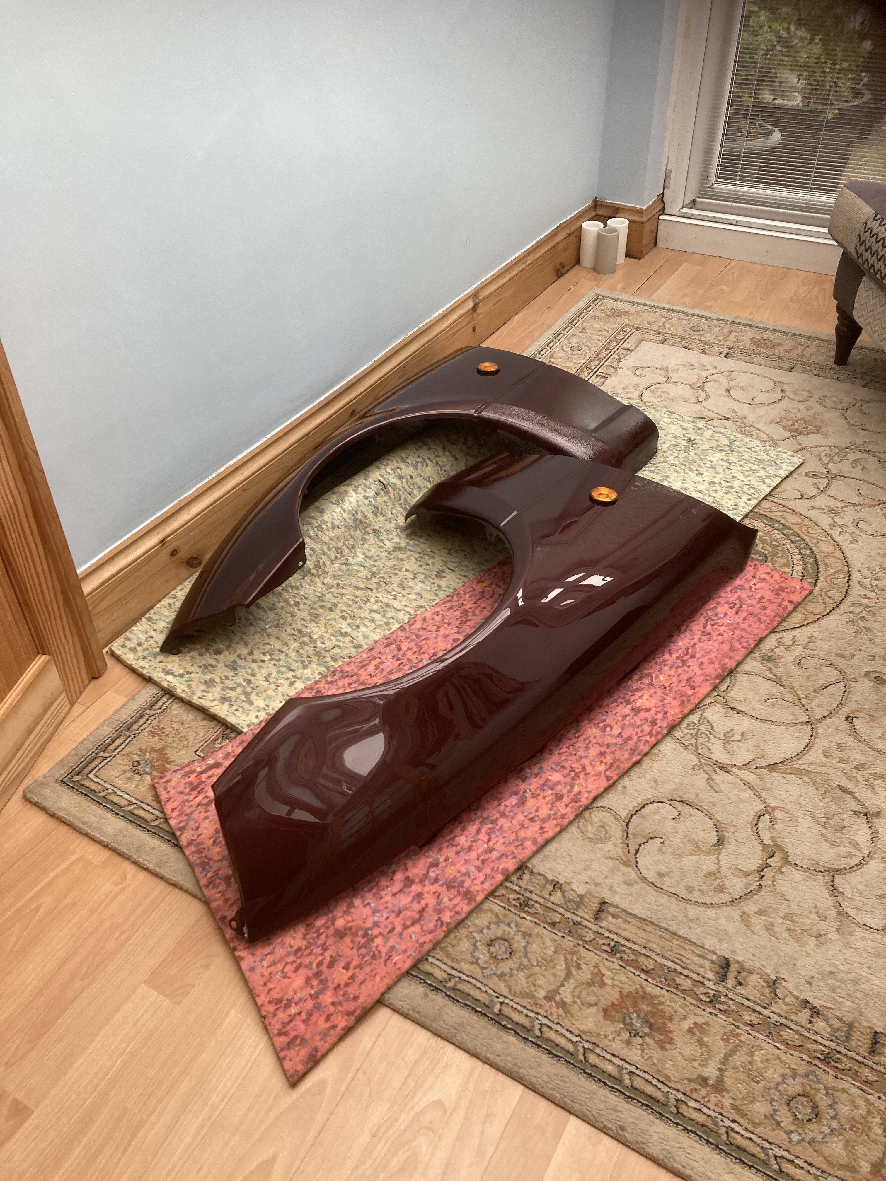

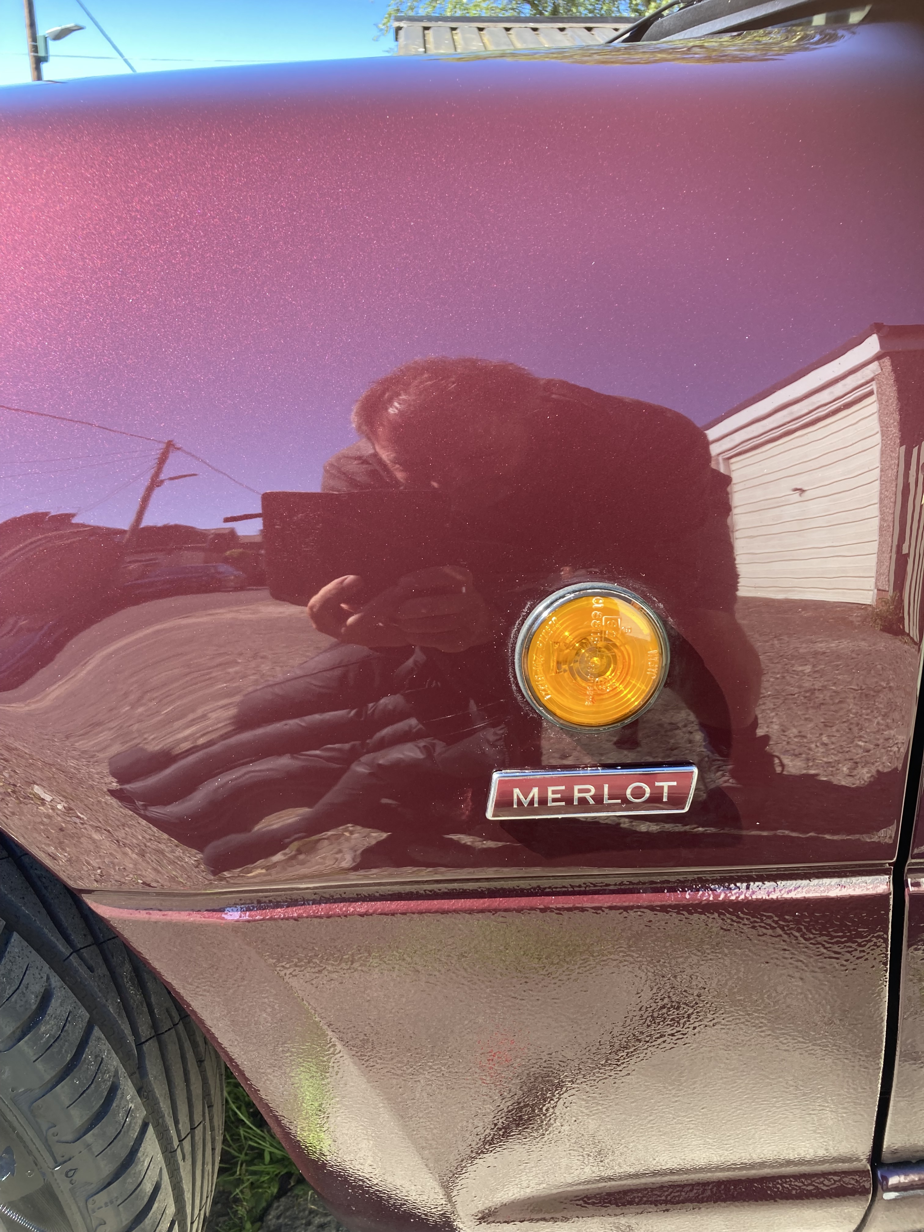

So my beloved Merlot had bubbling/ rust on front wings usual danger area i was aware of this when i bought car , so purchased 2 new wings sent off to body spray shop , was delighted yhat i only snapped 1 bolt result :+1: all inner panels and sills were solid no rust or holes so very happy took opportunity whilst old wings off to underseal with lanoguard all suspension spot on everything clean and tight :folded_hands:, only problem i had was 1 panel top holes was 3 mm out so filed slightly larger to make alignment same as opposite side last job was orginal Merlot badges put back on put all new bolts and clips on instead of using old ones pleased with end result :folded_hands:
Looks fabulous
Good job. :clap:
