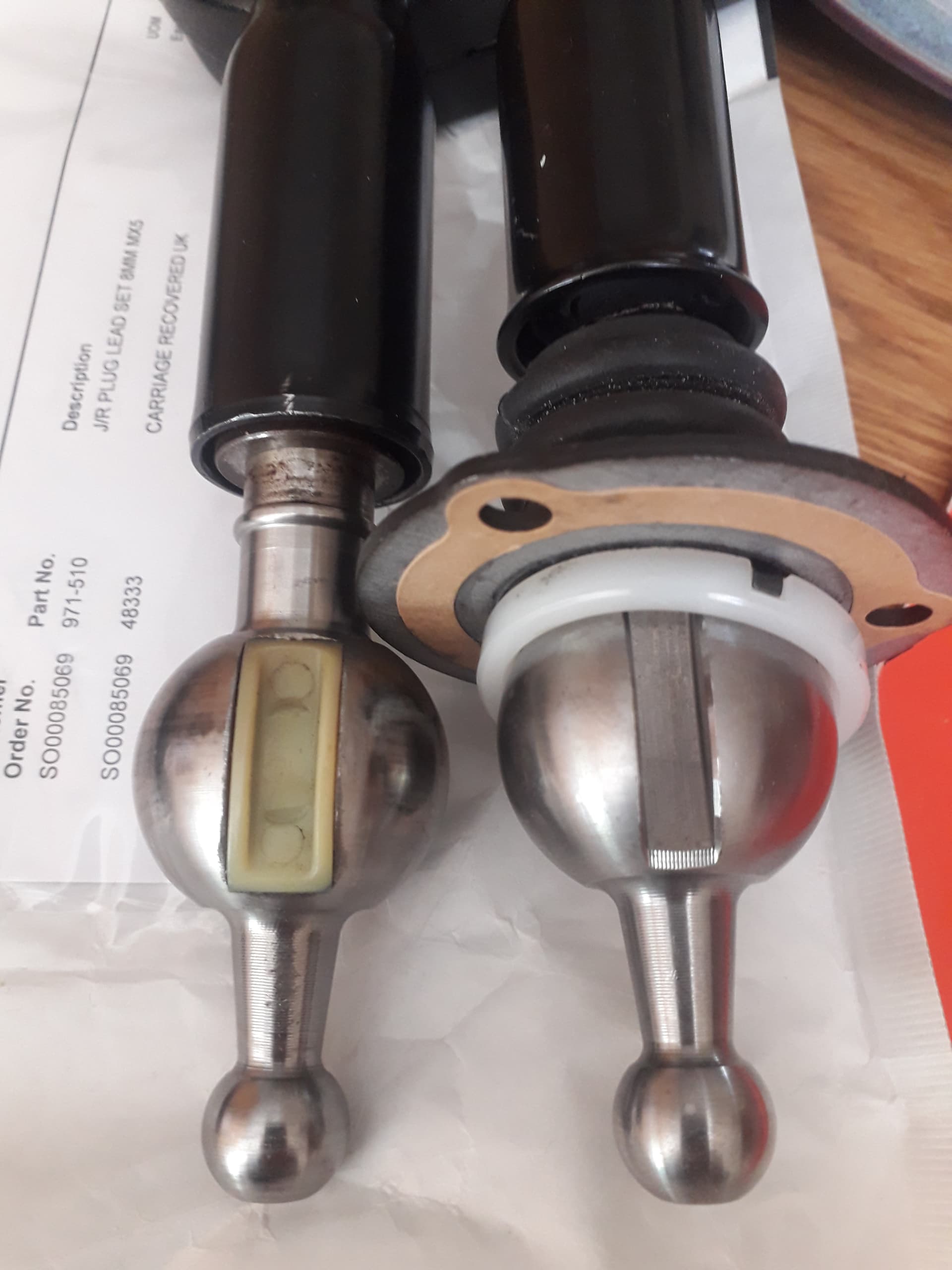

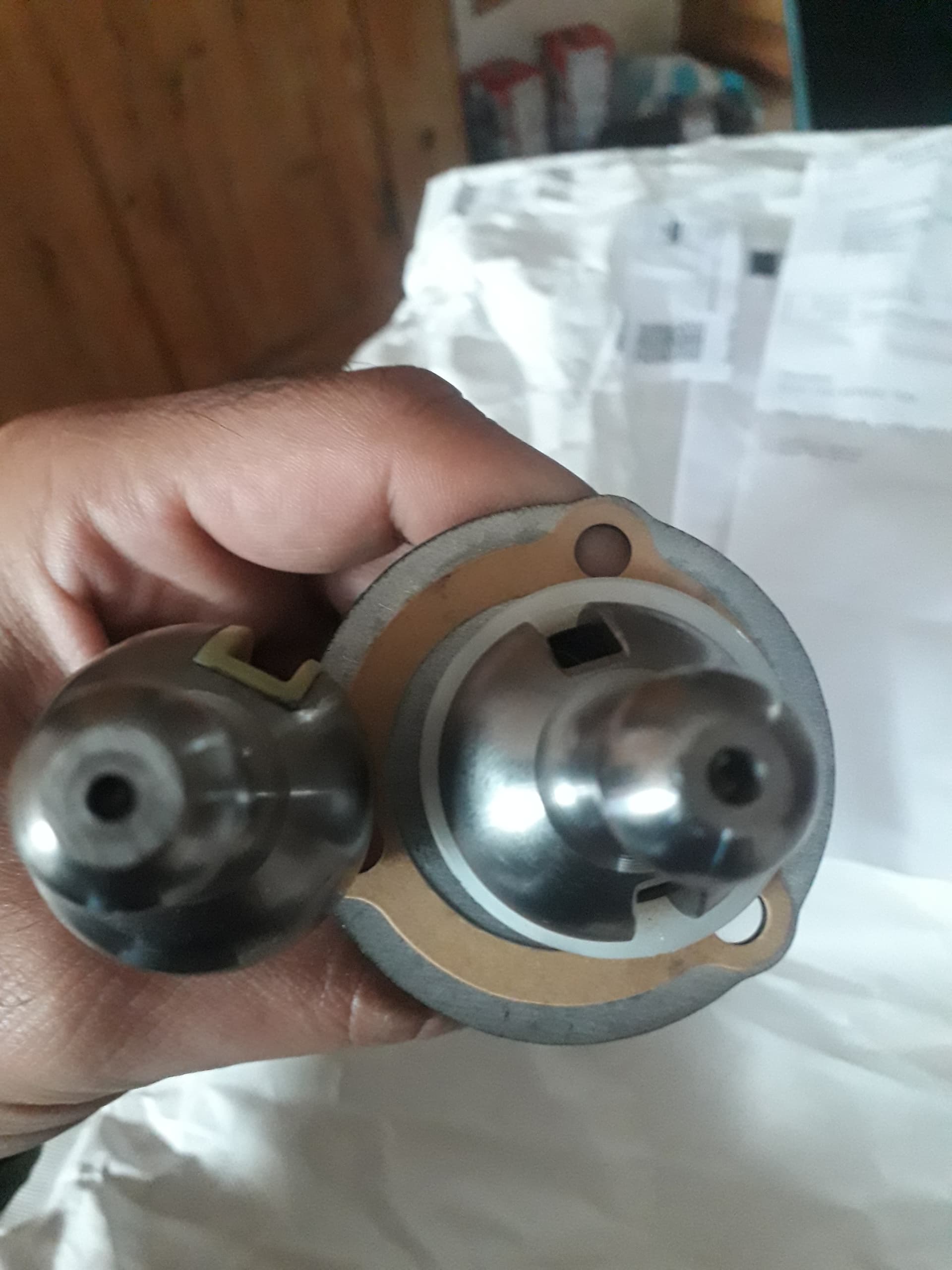

New Gearlever, is this correct?
MX-5 mk1 1.6 MY1992
New Gearlever on the right…
The new shift lever is for a NB 5-speed, hence the double grooves and lack of a slot bush. You shouldn’t need to replace the shift lever, as all the bushes are available.
As always Saz…spot on.
Replaced the bushes, springs and oil. Feels much better. :+1:
