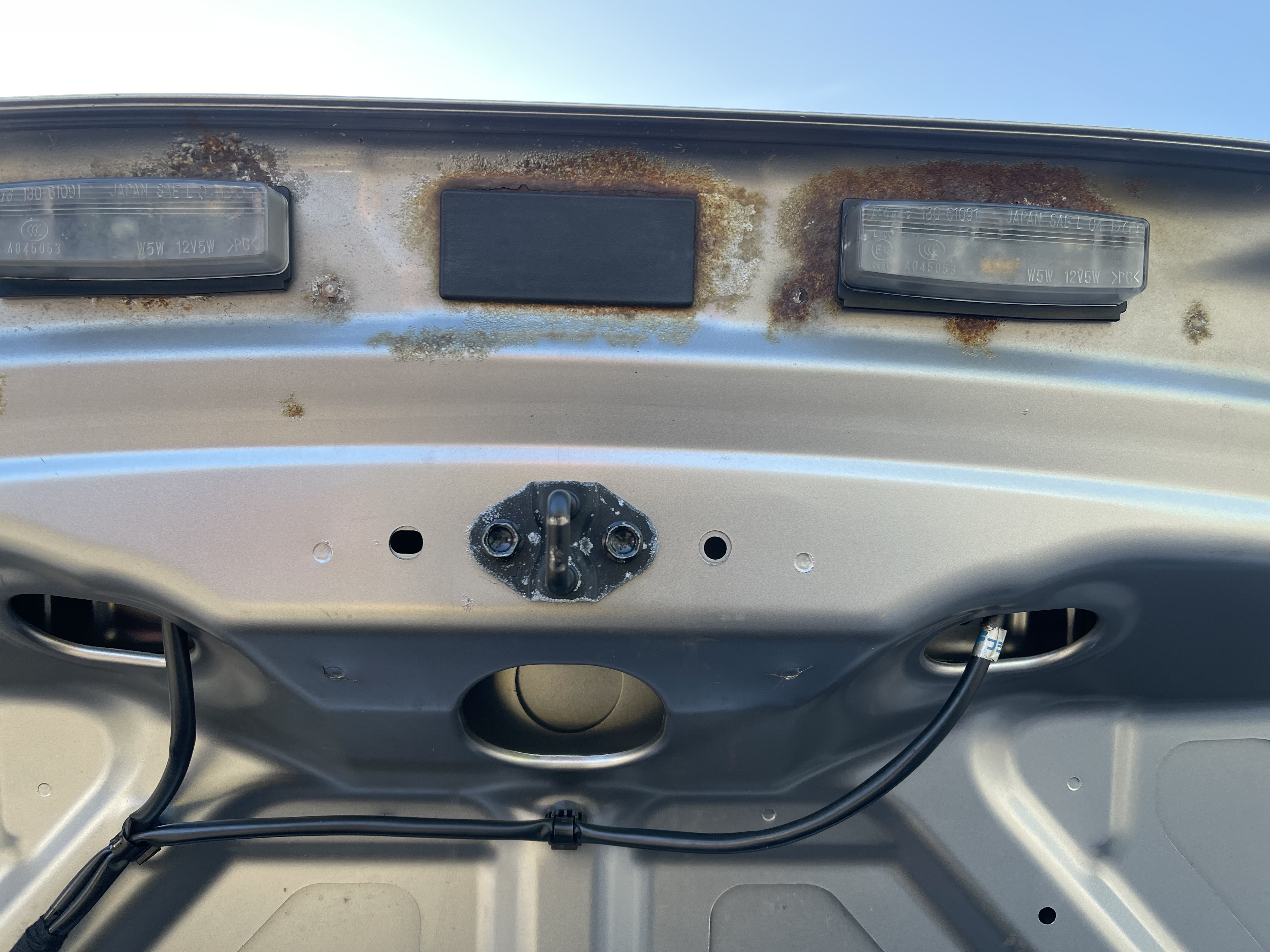

Rust management - the MOT has advisories on rust on the sub frame, generally the body work is really good but there is a little rust on one arch and the inside of the boot lid. I’d ideally like the underside to be treated then wax oiled or something similar (did this on my RX8 10 years ago…)

Boot lid… Around the interior lights ?
On my NC soft top (2006) the lid is aluminium and it’s just the paint flaking not rust…it’s common.
However I’m not sure if PRHT boot lid is steel ?

This is what I’m looking at on my boot lid, it’s the worst bit by far. The arches are only just starting but will get them repaired soon…

Yeah , common area around lights.
They pop out , buff the area and treat with your preffered products.
