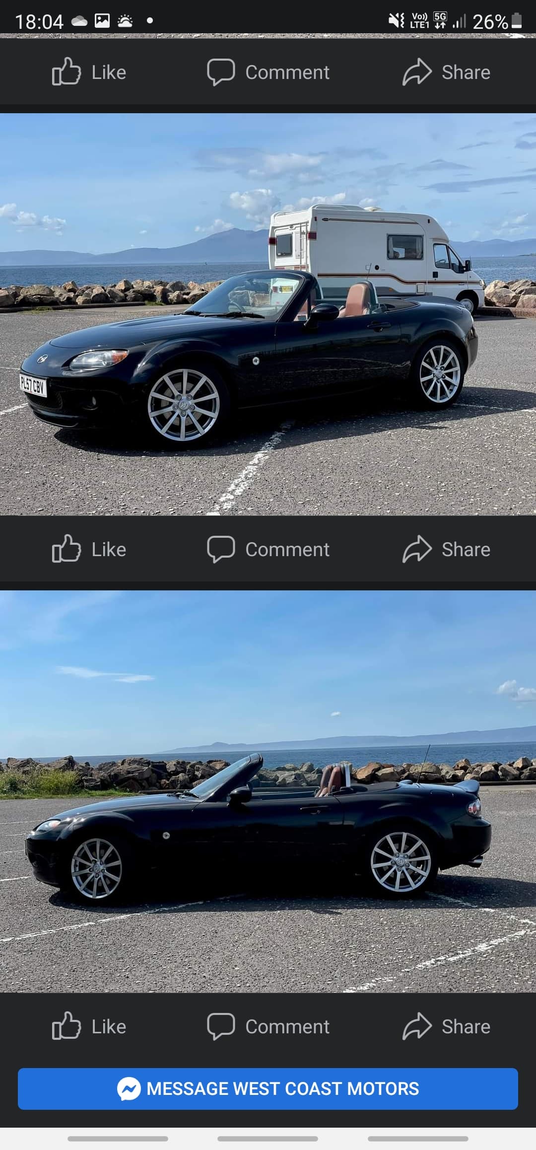

Hi fellow mx-5 owners. I recently bought a NC 2008 2lt sport and i couldnt be happier.
Had my eye on one for a long time then debated the z4 but i belive i made the right choice. The casual waves from fellow mx-5 owners makes me proud of the community i have joined.
The cars was already slitly modified so i would like to know if these are good mods.
Its on bilstine springs and shocks.
Cobra exhaust. And a we spoiler flick.
Think more may be done but yet to put it on the ramp.
It has a subtle twitch to the left when changing gear in a straigh line but seems to hold corners rather well but im not confident yet. Any advive would be appriciated as im
aware this is one of the best handling cars.
Anyway glad to be hear.any meets up in scotland let me know.
Check the tyre pressures and that, ideally, all 4 are the same brand
Others may disagree and state they only need match on each axle ie front and rear can differ
All 4 tyres are a different brand and year but pressure is good. Ill look onto getting new tyres and an alignment.
Thanks

Welcome! Lovely looking car!

I’m also from Ayrshire and know exactly where you bought your car from and where those pics were taken.
As others have said get a set of decent matching tyres on there and you’ll be amazed at the difference. I bought a Mini Cooper S a few years back and like your car it had mismatched tyres all round. When I drove the car the 100 or so miles home after purchasing it I thought ‘why do people say these handle so well?’ because it really didn’t. A new set of good tyres and that made a huge difference as I suspected it would. I always have matching tyres on any car I’ve owned (including 4 mk1’s) and will continue to do so.
